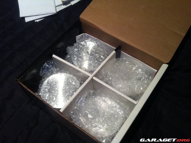

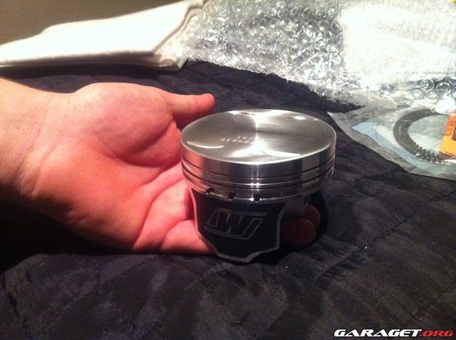

smidda wiseco kolvar 83,5
https://www1.garaget.org/gallery/images/99/98757/98757-e8f1b79f866f5bd34dadb6549ff7e108.jpg
https://www1.garaget.org/gallery/images/99/98757/98757-3462066b9a9272211b38f3c533c31c7f.jpg

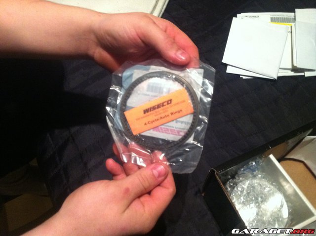

kolvringar.
https://www1.garaget.org/gallery/images/99/98757/98757-8cde7cffccddc9b37c9820b9a6bafca0.jpg
https://www1.garaget.org/gallery/images/99/98757/98757-1c1bb32292723acf4c46ae07b172a8b0.jpg

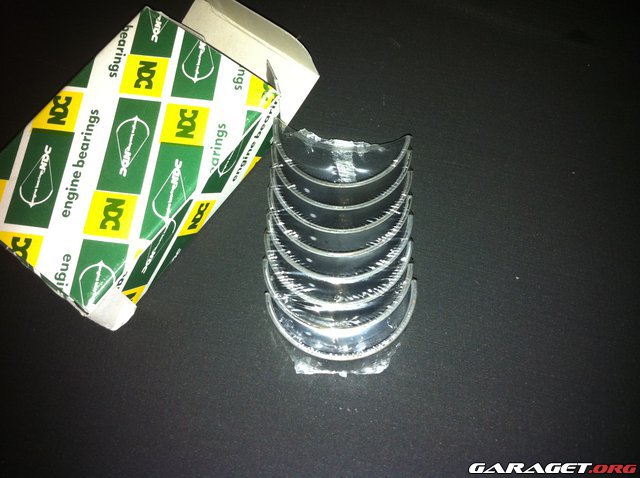

clevite vevlager 0,75 över standard.

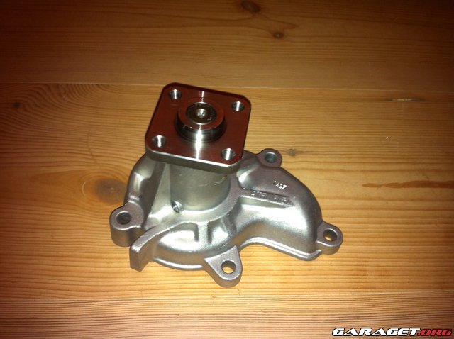

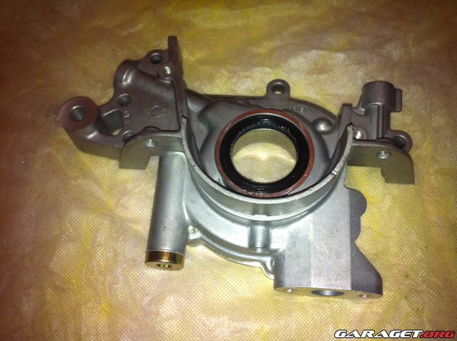

orginal vatten & olje pump.
https://www1.garaget.org/gallery/images/99/98757/98757-193a9a8b62ddc107c91468569950c8ce.jpg
vattenpump.

olje pump.
