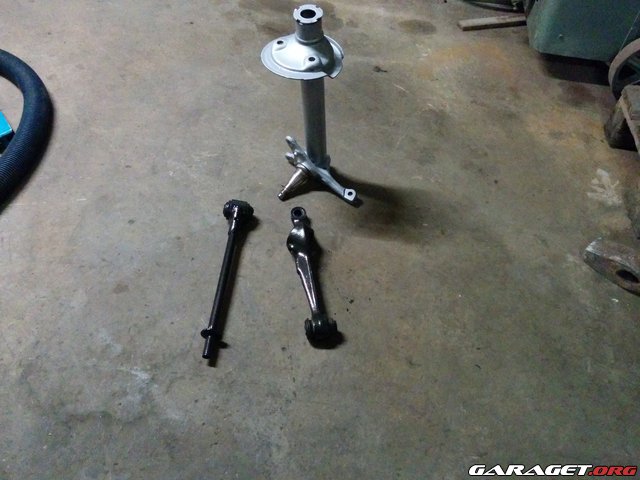

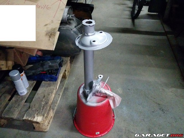

Fjäderben blästrat och lackat.
https://www1.garaget.org/gallery/images/123/122449/122449-43cb3579d74d1e0c3aa9ab3992ca8a4b.jpg

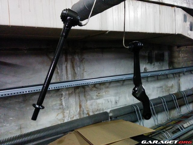

Länkarm + tvärstag blästrat och lackat.
https://www1.garaget.org/gallery/images/123/122449/122449-0e6c2a13573d16e322bc836ddb952ef7.jpg
Check!

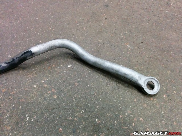

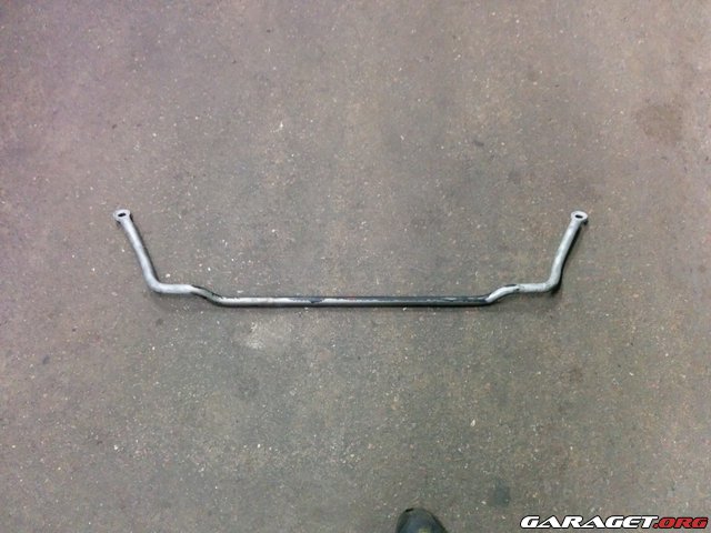

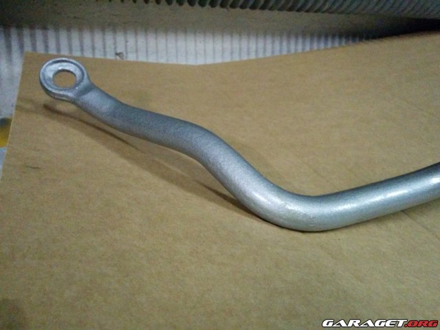

Blästrat krängningshämmare.
https://www1.garaget.org/gallery/images/123/122449/122449-4c0e8279ea2c62bf76c556d6dfb94590.jpg

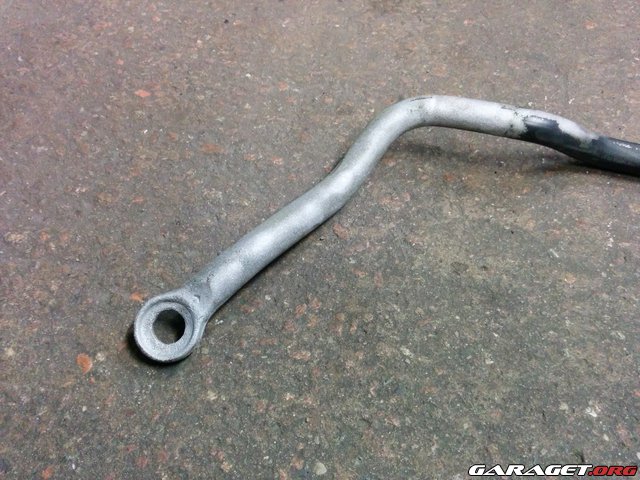

Rostfritt! smile
https://www1.garaget.org/gallery/images/123/122449/122449-45ec0a79819f1c2aeba28cf0c05ab20d.jpg
https://www1.garaget.org/gallery/images/123/122449/122449-6537f1b45ce1cbb7df98720594df38e4.jpg

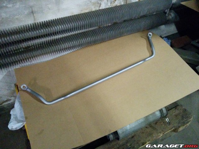

Lackat. Blev silver, tycker det sticker ut lite mera smile
https://www1.garaget.org/gallery/images/123/122449/122449-fff471bf573d088de15a0783ddaecfef.jpg
https://www1.garaget.org/gallery/images/123/122449/122449-92717fabb8390d2140574d29404778b5.jpg
