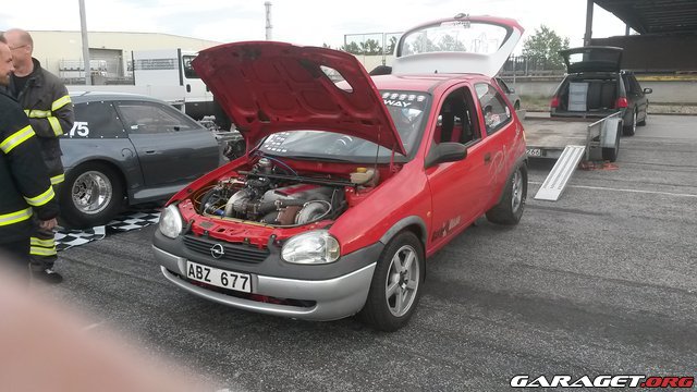

https://www1.garaget.org/gallery/images/171/170219/170219-f1c8484560f02672f512bcc60fe4cbde.jpg

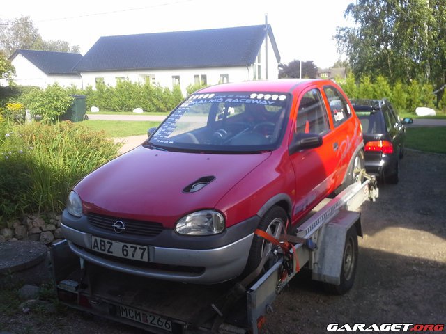

https://www1.garaget.org/gallery/images/171/170219/170219-76d57a682168d2137c41d2e9add58ca9.jpg
https://www1.garaget.org/gallery/images/171/170219/170219-1771bfbe758179480466a75ca12df123.jpg
