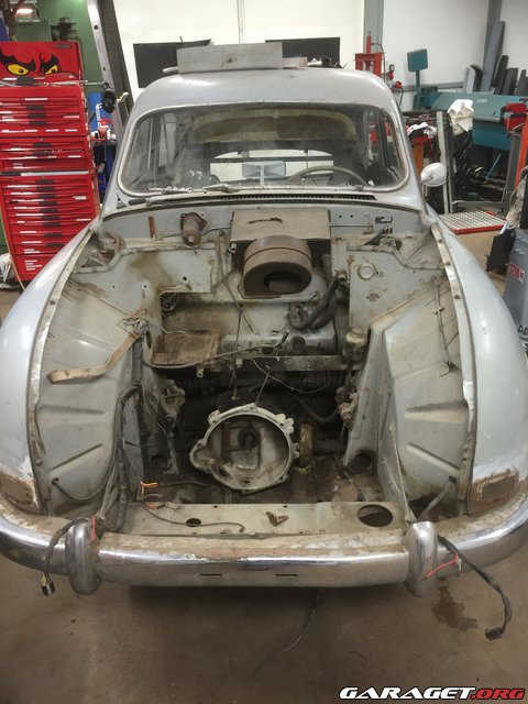

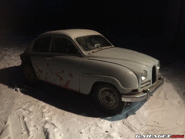

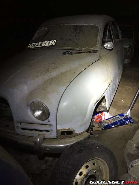

Denna tråd kommer handla om renovering av min tvåtaktare ;-D
https://www1.garaget.org/gallery/images/176/175761/175761-4a4b9dad4a3782e8555d120ae22e1c7b.jpghttps://www1.garaget.org/gallery/images/176/175761/175761-42191da5d00d8e5bd0e0bf02fb14c8d6.jpg

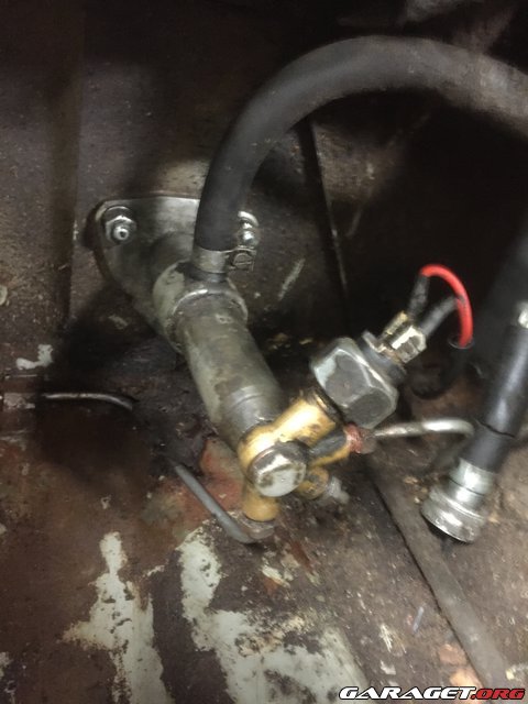

Motor utrymmet har klarat sig väldigt bra från rost smile

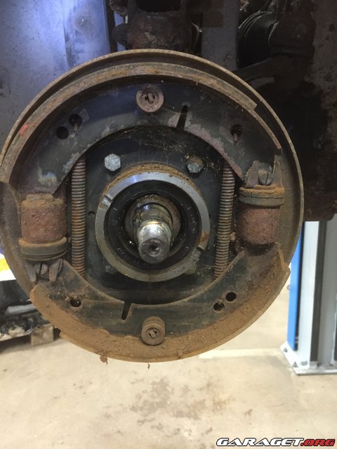

Bromsarna fram innan renovering

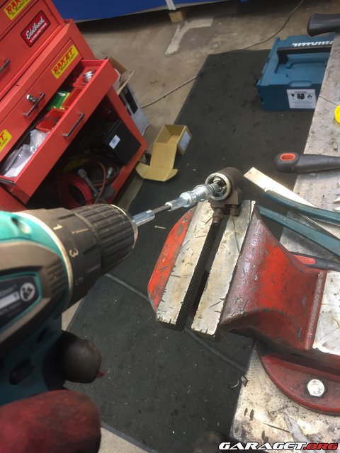

Horning av hjulcylindrarna fram:-)

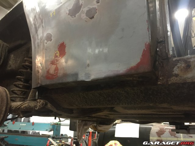

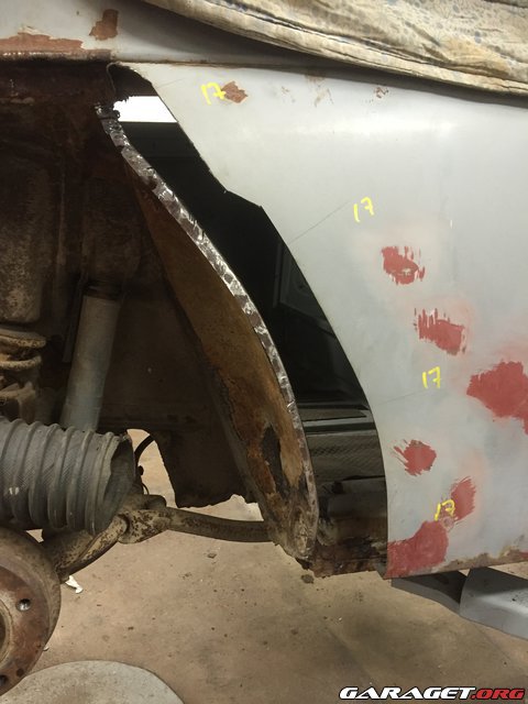

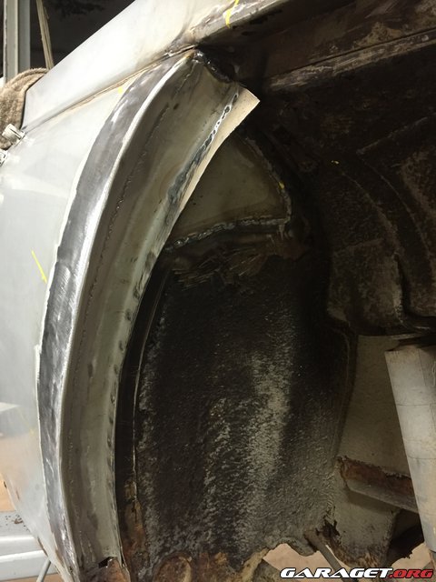

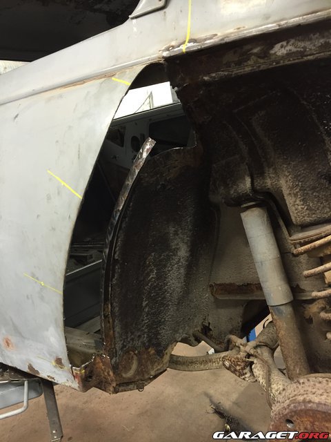

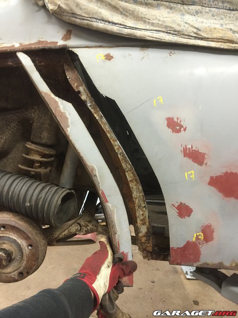

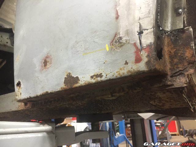

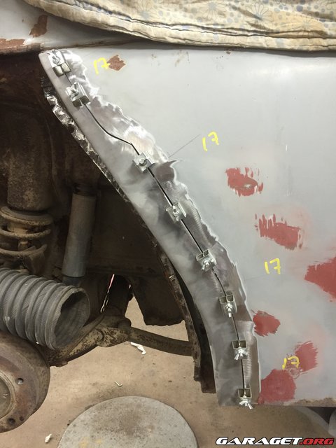

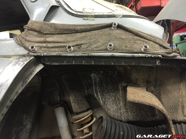

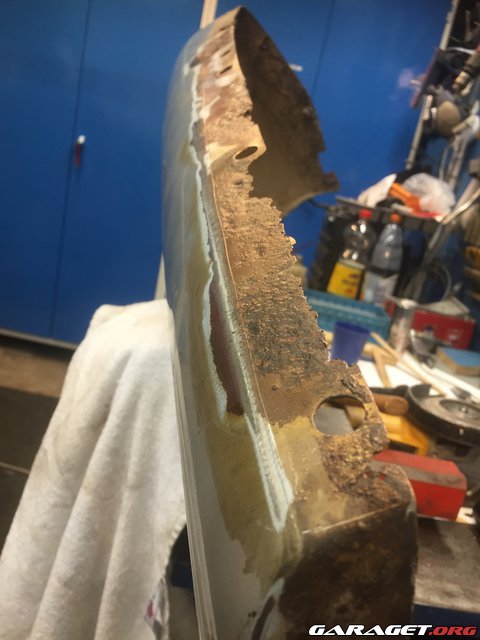

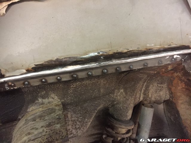

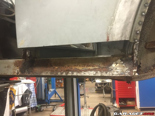

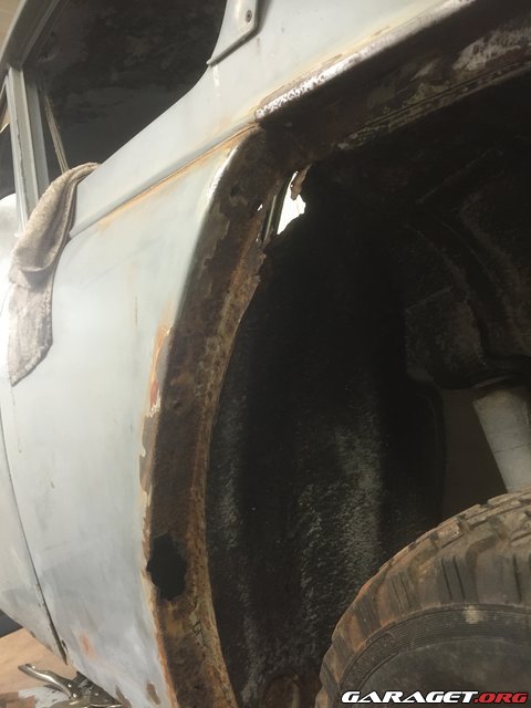

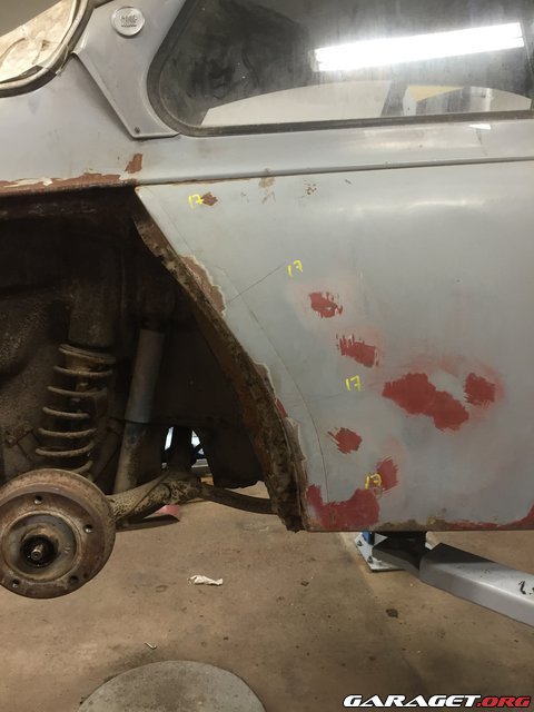

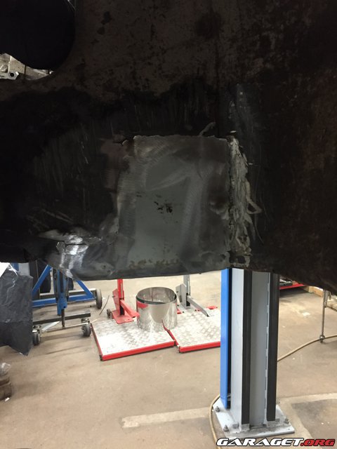

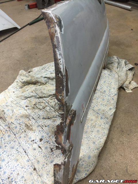

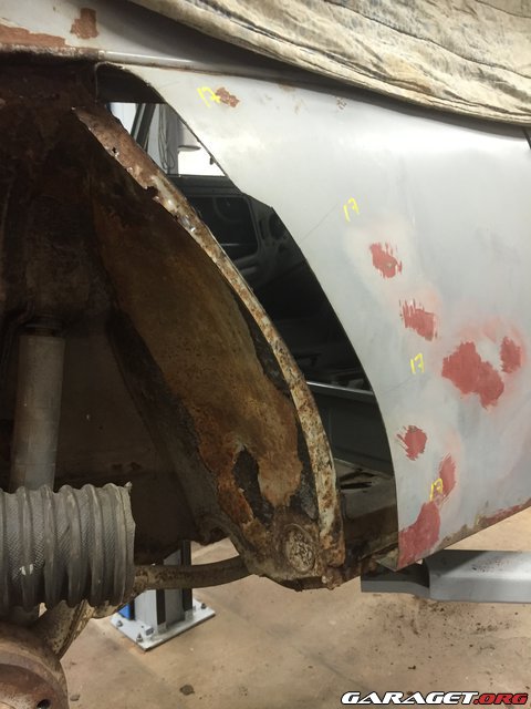

Rostlagning på G :-)
https://www1.garaget.org/gallery/images/176/175761/175761-740d55b792dc971c7c520563912613de.jpg
https://www1.garaget.org/gallery/images/176/175761/175761-4af9935eab6b672ce412446e440f7564.jpg
https://www1.garaget.org/gallery/images/176/175761/175761-554dd73fb48bf09c873e90c82f49278e.jpg
https://www1.garaget.org/gallery/images/176/175761/175761-e6666d0936afd3299fd78a92aa19741c.jpg

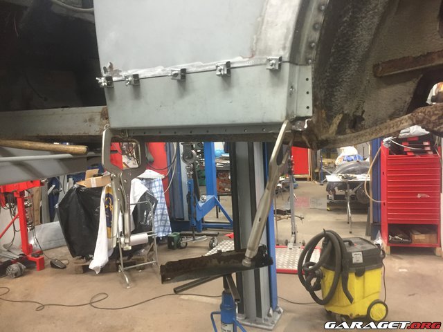

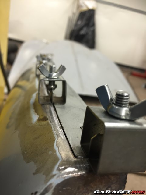

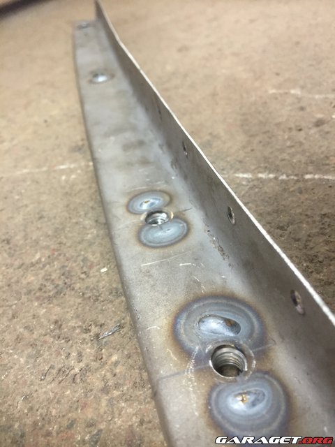

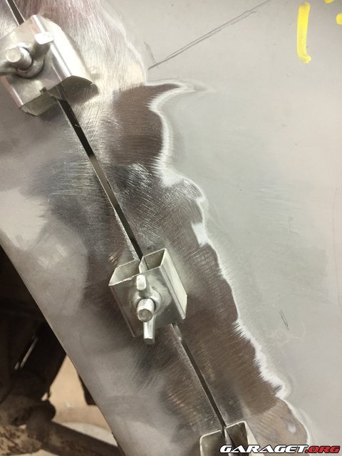

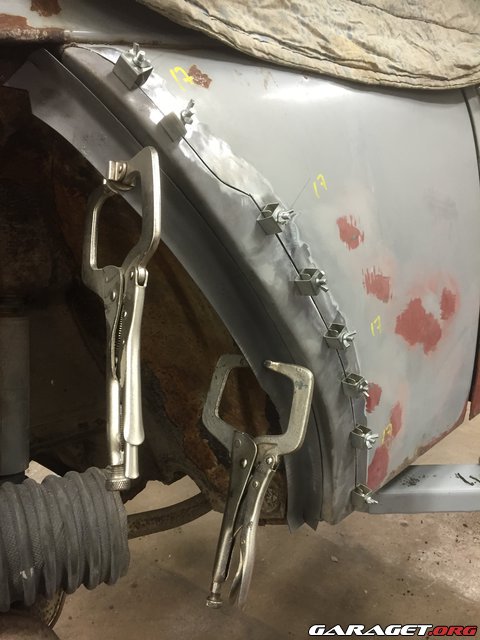

Nytillverkad plåt som ska svetsas dit ;-D
https://www1.garaget.org/gallery/images/176/175761/175761-f3548734580c6e9a3dca163e0a63fd98.jpg
https://www1.garaget.org/gallery/images/176/175761/175761-7974c4b526d6edfd508b2a409ab11d5c.jpg
https://www1.garaget.org/gallery/images/176/175761/175761-0b554f36dc48dd82876d887422ce7e82.jpg

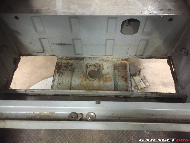

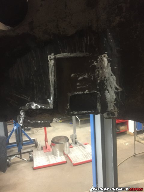

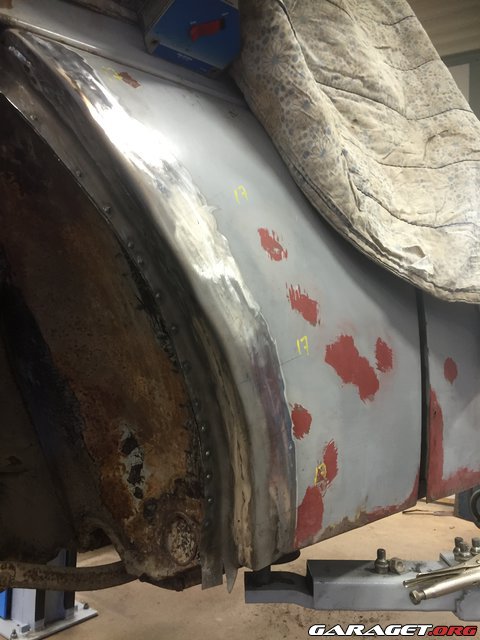

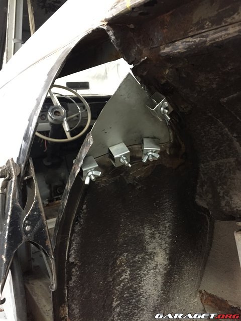

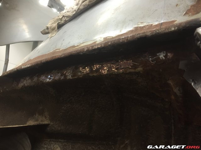

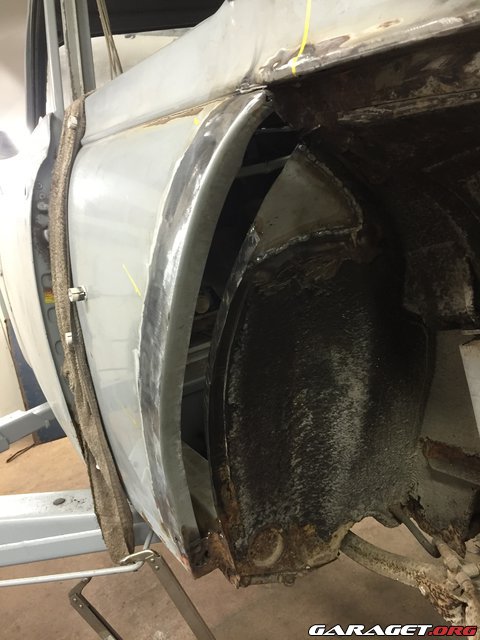

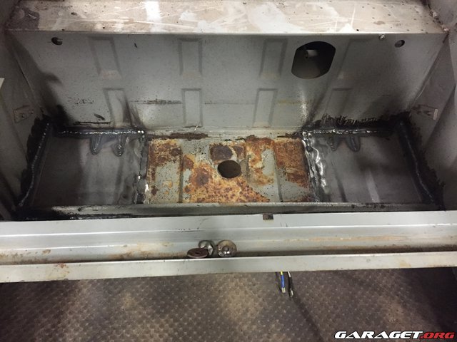

hänt lite här, men nu kommer de lite bilder på vad jag sysslat med ;-)
https://www1.garaget.org/gallery/images/176/175761/175761-8f949be55aa9ba030c384414ba3a2145.jpg
https://www1.garaget.org/gallery/images/176/175761/175761-f0a8b8c1f1ddc91d9111dc173739c604.jpg
https://www1.garaget.org/gallery/images/176/175761/175761-9f3e7009782efd12cd9e0b79fe0b3c7a.jpg
https://www1.garaget.org/gallery/images/176/175761/175761-c4d0fb9e78a1f10f7a58ce9b101e9d9e.jpg
https://www1.garaget.org/gallery/images/176/175761/175761-99e8e4b7929cb0545a04e7c4548ac7b6.jpg
https://www1.garaget.org/gallery/images/176/175761/175761-43e7ed7e04bd6a61e6c920e4f0c108ca.jpg
https://www1.garaget.org/gallery/images/176/175761/175761-c0b7c74048f36a76e8a7fec0fa6d0a36.jpg
https://www1.garaget.org/gallery/images/176/175761/175761-f017312a5edad96ab1ddc5793b3c571f.jpg
https://www1.garaget.org/gallery/images/176/175761/175761-df6555852ed48dc37b040f9a55ba2c88.jpg
https://www1.garaget.org/gallery/images/176/175761/175761-23226dd6a6ae87f96460200c883b23c6.jpg
https://www1.garaget.org/gallery/images/176/175761/175761-0c1ba531f1895c391a6b87c15ec27b62.jpg
https://www1.garaget.org/gallery/images/176/175761/175761-a47fbf3662cc491fe25ebcb1834b5d8f.jpg
https://www1.garaget.org/gallery/images/176/175761/175761-b7cca1ab36c50b215a3a6777a7fb0721.jpg
https://www1.garaget.org/gallery/images/176/175761/175761-a5d806e38475356026f26bfacd5bc50b.jpg
https://www1.garaget.org/gallery/images/176/175761/175761-88c1bf8283c01ef39b4ba66550915ec5.jpg
https://www1.garaget.org/gallery/images/176/175761/175761-be85426842b6c27fda218b4389f32813.jpg
https://www1.garaget.org/gallery/images/176/175761/175761-faf62fa1d5140c7c6c24e3e9c7baa55a.jpg
https://www1.garaget.org/gallery/images/176/175761/175761-8c18e88eba1f0be3ad9b3db425467292.jpg
https://www1.garaget.org/gallery/images/176/175761/175761-f78f1f022bbe5d9406b3b98d593e747a.jpg
https://www1.garaget.org/gallery/images/176/175761/175761-0dc47bb9cacc4a9c175db7071e0b2012.jpg
https://www1.garaget.org/gallery/images/176/175761/175761-95017d004dfe84e814a425c5f99a5c9b.jpg
https://www1.garaget.org/gallery/images/176/175761/175761-a4f40d6d0c140edcb2db48af1e790535.jpg
Så äre tänkt att den ska se ut ungefär smile
https://www1.garaget.org/gallery/images/176/175761/175761-1aafe63936659a43c9dc816ef121f9d3.jpg
ska försöka uppdatera oftare smile

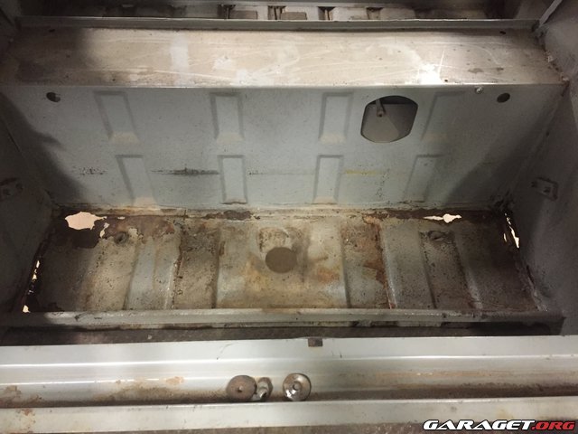

31 mars 2016

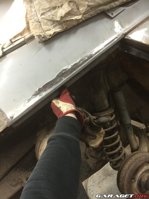

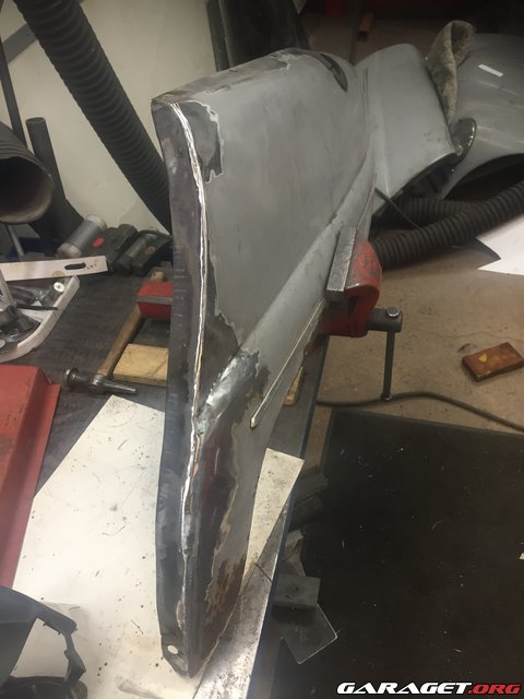

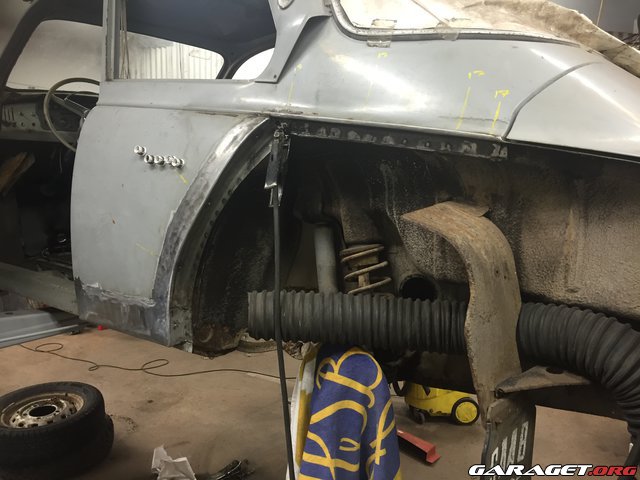

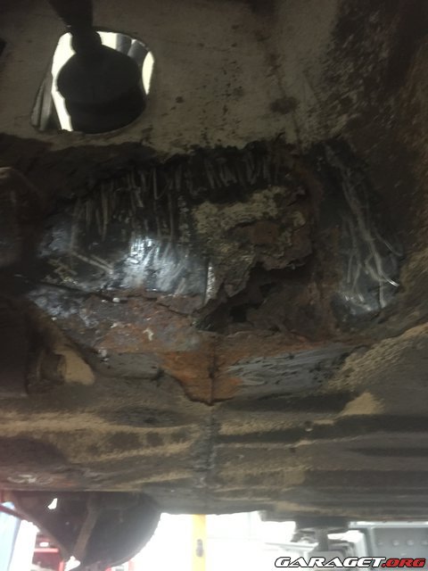

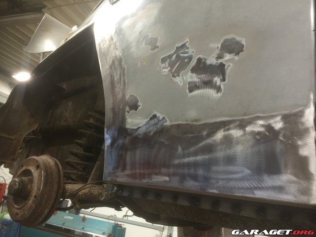

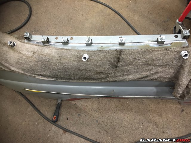

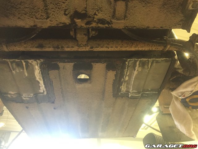

Inte hunnit så mkt uder påsk (vart i elmia 4dagar)
men lite har de hunnits med sen senast:)

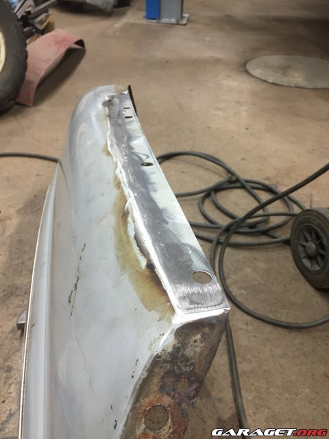

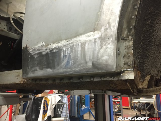

lite mer slipning och lack kvar där de har blivit lagat:)
https://www1.garaget.org/gallery/images/176/175761/175761-2e51e51125d86a95b10622660a186427.jpg
https://www1.garaget.org/gallery/images/176/175761/175761-c27e1b0e3148e290ea62477a5f913779.jpg
https://www1.garaget.org/gallery/images/176/175761/175761-0041023c094824a0af5e09544a823f77.jpg
https://www1.garaget.org/gallery/images/176/175761/175761-c2b0535813d53967cddc0dc6a9c74ab1.jpg
https://www1.garaget.org/gallery/images/176/175761/175761-e95d8dca43b34fe9e6e4c008067e2ab8.jpg
https://www1.garaget.org/gallery/images/176/175761/175761-251a1b4d2d7c15c9e22a920d843e6bde.jpg
https://www1.garaget.org/gallery/images/176/175761/175761-4d14dde6c58ed8941d1e46bbb0cbc193.jpg
https://www1.garaget.org/gallery/images/176/175761/175761-ebf2b1fff5a42d5b50ae80c068205771.jpg
https://www1.garaget.org/gallery/images/176/175761/175761-725ebe305056414076428de773f3a0ca.jpg
https://www1.garaget.org/gallery/images/176/175761/175761-6e835fd3018f670801a914851b066cd2.jpg
Mer bilder kommer smile

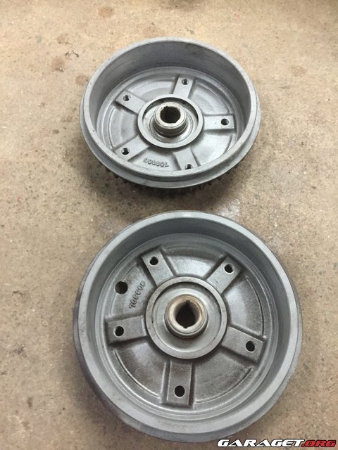

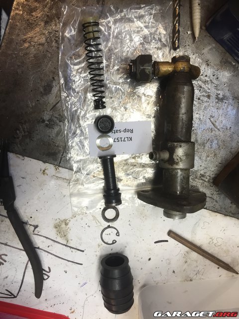

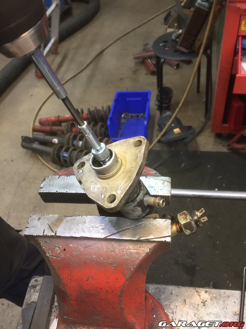

Gårdags kvällen gick åt att renovera Broms huvudcylindern och bromscylindrarna fram och blästra broms trummorna fram. smile
https://www1.garaget.org/gallery/images/176/175761/175761-1e84187c3317991e820c1ad4d324658b.jpg
https://www1.garaget.org/gallery/images/176/175761/175761-2b21940bac021f0a29698e7e49bee957.jpg
målet är att bromsarna ska vara klara i helgen smile

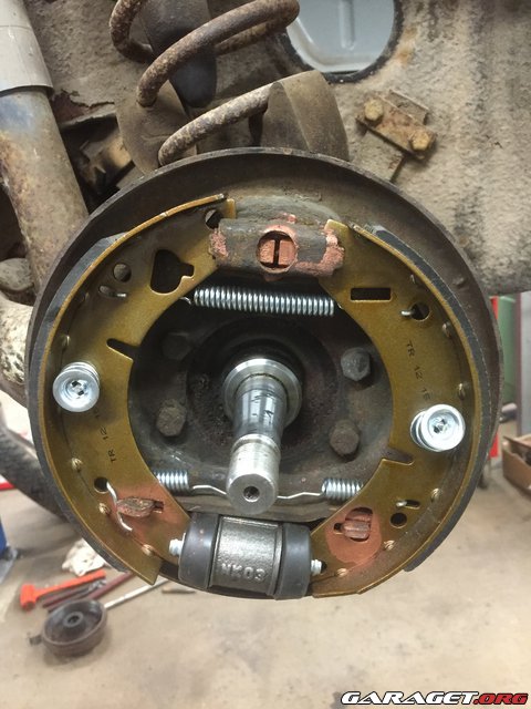

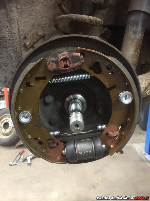

Dagens jobb, satt ihop bromsar fram och bak, bytt bromsslangar,bromsbackar och broms cylindrar
och efter att luftat bromsar så funkar bromsana perfekt big_smile
Även handbromsen funkar fint:D

Gillar bilen. Skickligt plåtjobb!
118 Inlägg
2 april 2016
det här lär jag följa. Kul att se renoveringen av en två taktare.
Väldigt fint plåt jobb
64 Inlägg
4 april 2016
Tackar big_smile bra bil att lära sig plåt arbete med big_smile
