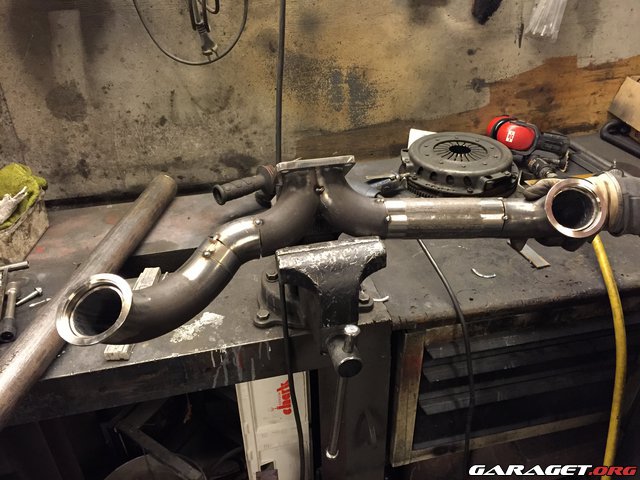

https://www1.garaget.org/gallery/images/185/184306/184306-bf7f2297a1dcd06c8b1ccf9403d5ec93.jpg
Funderingar, funderingar.
https://www1.garaget.org/gallery/images/185/184306/184306-46d9cb0acc5c57c9a545bca091b186b9.jpg

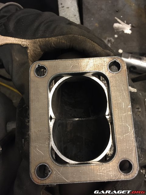

Turbofläns från KL Racing
https://www1.garaget.org/gallery/images/185/184306/184306-9efdfd5e6c024a8bee1a357c9f72c3e6.jpg
Kollektor
https://www1.garaget.org/gallery/images/185/184306/184306-44fb7f05119ba2bf76296959912f65db.jpg
Kan bli bra det där.
https://www1.garaget.org/gallery/images/185/184306/184306-b1c6f9cb396ccfef5b7b713362a472ea.jpg
https://www1.garaget.org/gallery/images/185/184306/184306-e8936e072be2dbf6b9d36dbcca235cef.jpg
Mycket plats bakom, varför inte big_smile
https://www1.garaget.org/gallery/images/185/184306/184306-6bab3f7d46ca8aba4eaec4bf7f973cb1.jpg
Turbina
https://www1.garaget.org/gallery/images/185/184306/184306-e94ca5a52ba6a0f4d42798bedd97d2bb.jpg

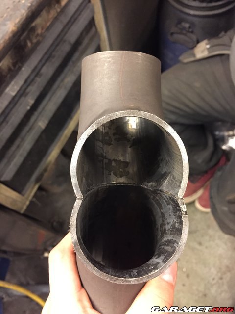

Blir v-band mot 2 orginal höger-grenrör
https://www1.garaget.org/gallery/images/185/184306/184306-d08957c471ab0261593879f4a349eaf2.jpg
https://www1.garaget.org/gallery/images/185/184306/184306-4dd68244f5edb2d4c1fbae2e03235e6c.jpg

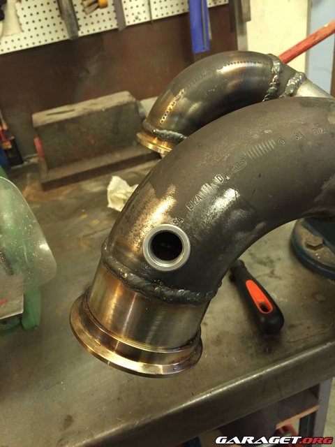

Downpipe med sluten wastegate
https://www1.garaget.org/gallery/images/185/184306/184306-772c422fa98a7029ecb2d9ee0c6505c0.jpg

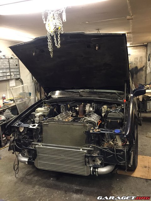

Monterade intercooler och provade hänga dit kylarna för att se hur det blir.
https://www1.garaget.org/gallery/images/185/184306/184306-c2fe7376006e8cc05b0822f3af94edc1.jpg

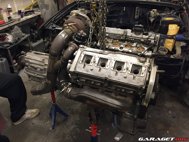

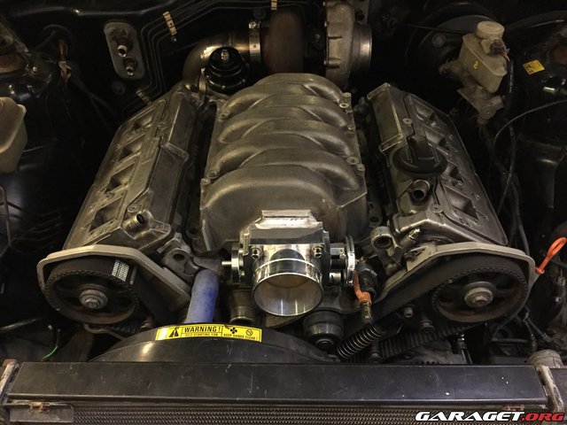

Uppdatering
Kamrem monterad
https://www1.garaget.org/gallery/images/185/184306/184306-a7ae42d003b1c43cf94cfd971286b6ce.jpg
Generator
https://www1.garaget.org/gallery/images/185/184306/184306-d28ffe95d7eb33c9cf83bd4b86233a4a.jpg
Motorn urlyft för lite småfix
https://www1.garaget.org/gallery/images/185/184306/184306-74701a568bd9e5d0e04e9e1a95edc20f.jpg

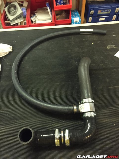

Slavcylinder
https://www1.garaget.org/gallery/images/185/184306/184306-4c9ec27466a63178ebc36bcc9d1898c4.jpg
Oljeretur
https://www1.garaget.org/gallery/images/185/184306/184306-4a887aa0fa9c29eb757716ddfa161ffa.jpg

Uppdatering
Har vart lite klent med uppdateringar på sistone men har inte jobbat mindre i garaget för det, snarare mer smile
Bytt garage, dags att börja bygga tryckrör.
https://www1.garaget.org/gallery/images/185/184306/184306-42fb837952df6c857b8e9f4ef39ad766.jpg

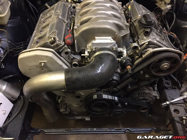

Svetsat spjällhus
https://www1.garaget.org/gallery/images/185/184306/184306-2290c770bb22fe98d71898c11c983f90.jpg
Inte vackert men får skylla på att svetsen var polvänd roll
https://www1.garaget.org/gallery/images/185/184306/184306-c08a6f2e0468633b77520c2c958f5be1.jpg

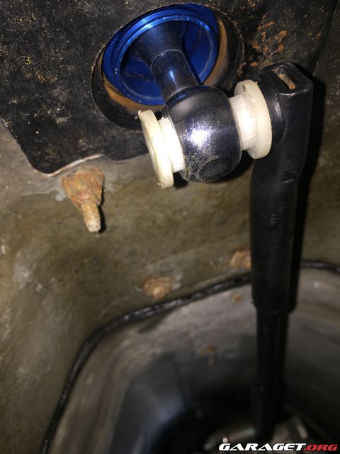

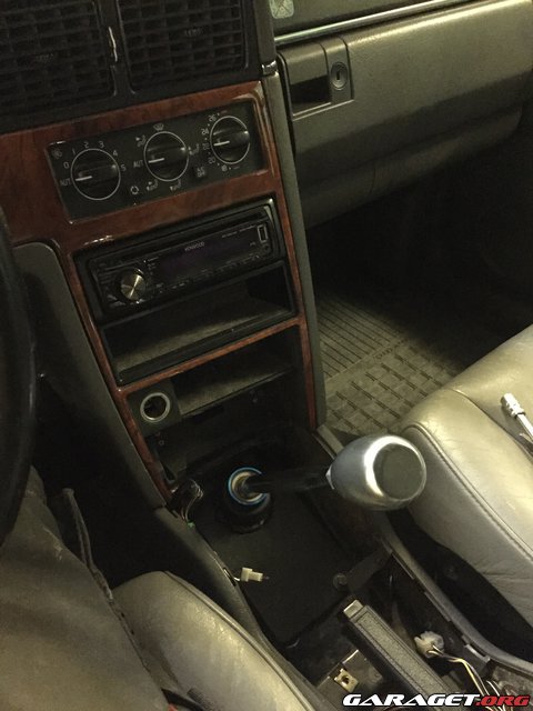

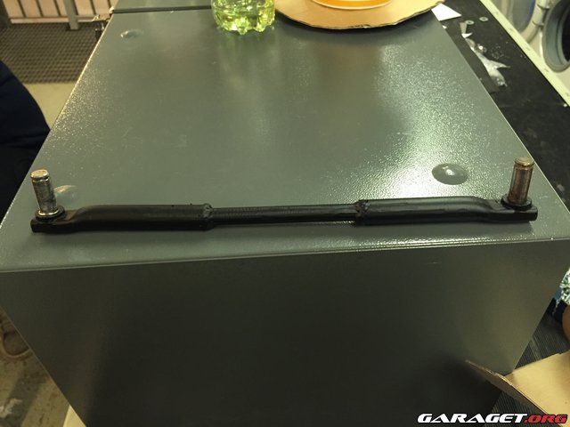

Gjort spakställ med biltemapinne
https://www1.garaget.org/gallery/images/185/184306/184306-24de32119edaeb704b5684ee342be228.jpg

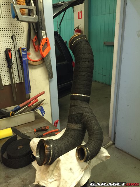

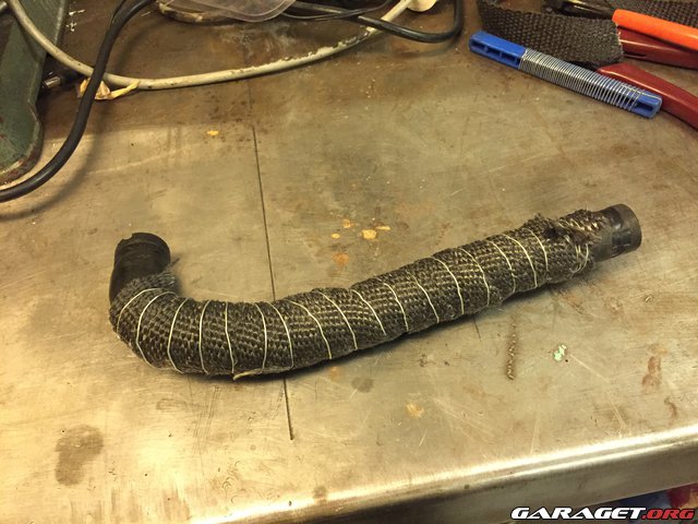

Lindat wastegateröret
https://www1.garaget.org/gallery/images/185/184306/184306-ab9d09f538a12f00163bccb567c6183b.jpg

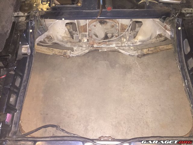

Kapat ur plats för tanken
https://www1.garaget.org/gallery/images/185/184306/184306-d445731178accef6585e26b24b535417.jpg

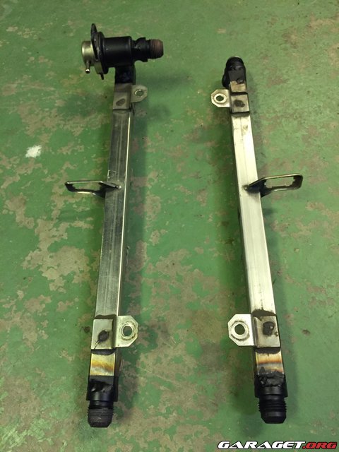

Nysvetsade och nymålade fuelrails
https://www1.garaget.org/gallery/images/185/184306/184306-ce2622a56ca490fba94ef0e1bbcb3689.jpg
Vänster spridarbank monterad
https://www1.garaget.org/gallery/images/185/184306/184306-ee1a6a823d5f18678bbe84e202ec23d8.jpg

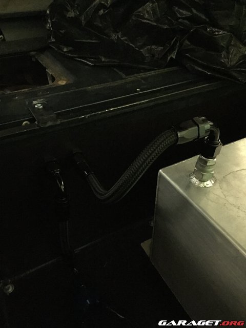

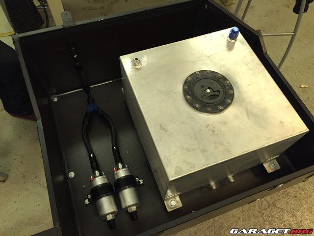

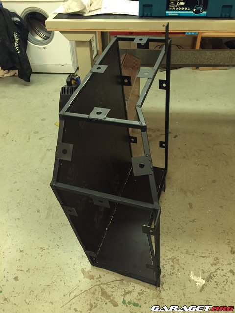

Montera väggar i tanklådan
https://www1.garaget.org/gallery/images/185/184306/184306-64236f9e459b0ff89701f5cfa4dfd325.jpg
Tank och biltemapumpar på plats
https://www1.garaget.org/gallery/images/185/184306/184306-af4459a35976f5714fed58fd65028aa3.jpg

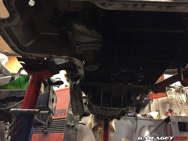

Fick sänka fästena för krängningshämmaren då den annars skulle ta i oljetråget
https://www1.garaget.org/gallery/images/185/184306/184306-31c23519414c972f45e3a2f392150bb8.jpg

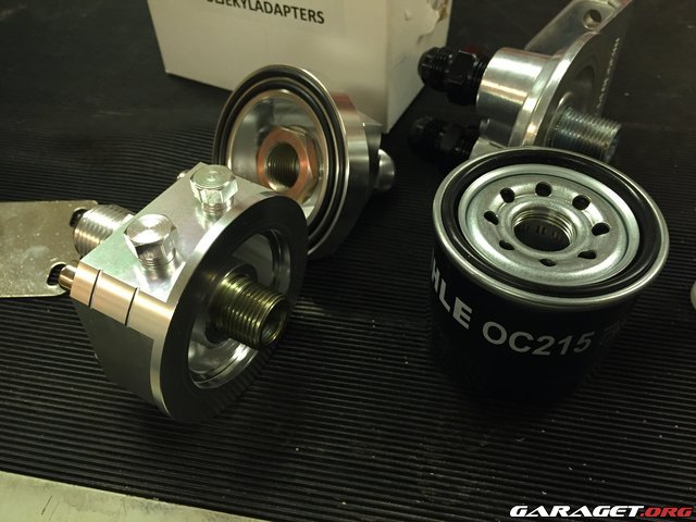

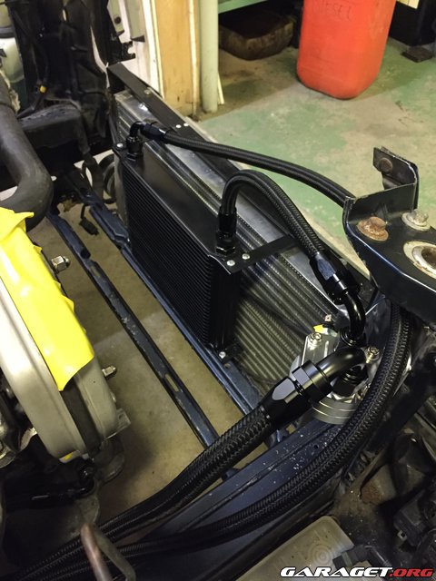

Montera oljekylare
https://www1.garaget.org/gallery/images/185/184306/184306-edb7afdb899b8ebe1532027ceca1d82f.jpg

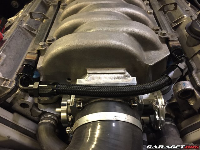

AN8 mellan fuelrailsen
https://www1.garaget.org/gallery/images/185/184306/184306-d5d2eb5ce1bcbd336824964aacc92084.jpg

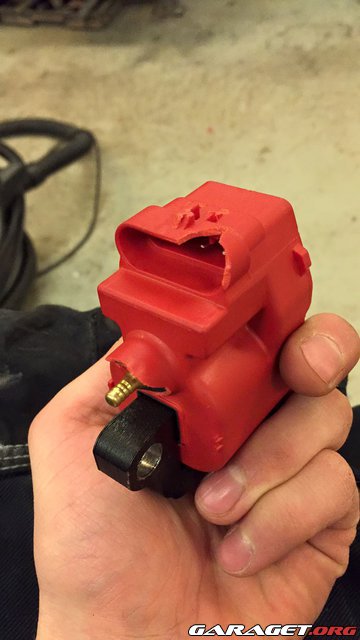

Provmontering LS-spole, passar nästan perfekt i originalhålen
https://www1.garaget.org/gallery/images/185/184306/184306-3d0c955e7357c62cf066a1952038ea52.jpg
Går inte alltid som man tänkt sig, bara beställa ny från USA sad
https://www1.garaget.org/gallery/images/185/184306/184306-d503d1873988a2ff9baee7322cc9c277.jpg

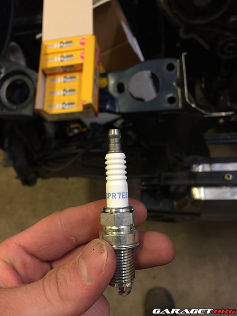

Skruva i stiften
https://www1.garaget.org/gallery/images/185/184306/184306-b8bf7ff8b47d28228fc6e13884dc0662.jpg

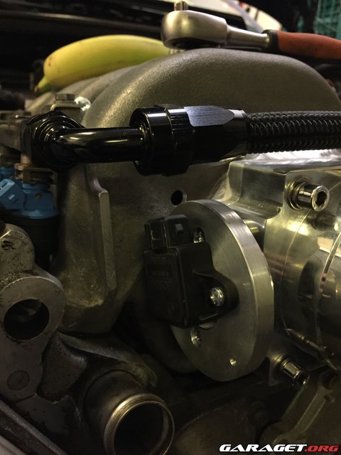

Montera TPS
https://www1.garaget.org/gallery/images/185/184306/184306-6ee86accf30171c18528898750386669.jpg

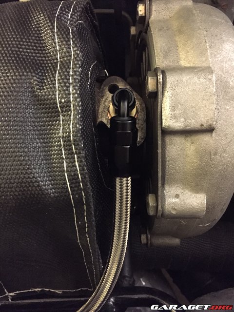

Tänkte köra banjo först men slutade med AN efter lite strul tongue
https://www1.garaget.org/gallery/images/185/184306/184306-80edc3c1e0e887fd647c9741c41efdae.jpg
Oljetillförsel
https://www1.garaget.org/gallery/images/185/184306/184306-9c31e0793bb770837a2134278f1705a9.jpg
Göra AN-kopplingar smile
https://www1.garaget.org/gallery/images/185/184306/184306-029678ed9ab81b4394dd1c599f1506e7.jpg
Koppla oljefilter och oljekylare
https://www1.garaget.org/gallery/images/185/184306/184306-e045afea1cd74bcf7c359ce833da3083.jpg

Bränsleretur, tanken är att den ska flyttas till sidan av tanken så att man kan stänga golvet i bakluckan
https://www1.garaget.org/gallery/images/185/184306/184306-dc91139a0d0803ffbbd71902396186db.jpg
Trångt blir det, men bra wink
https://www1.garaget.org/gallery/images/185/184306/184306-d1bc6b2324ae5f0ead46df53d2a80ce8.jpg
Förlängde ett BMW originalväxellänkage
https://www1.garaget.org/gallery/images/185/184306/184306-0310b95f74f1e5aeaabf4c20c8da4d40.jpg
Blir bra när det är klart
https://www1.garaget.org/gallery/images/185/184306/184306-69c2f5a7aa80562bc5e81bbeccfcb975.jpg

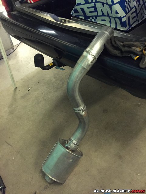

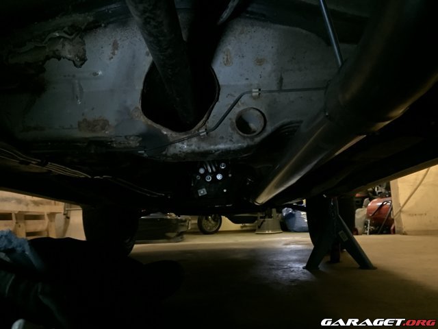

3"
https://www1.garaget.org/gallery/images/185/184306/184306-89c90460e829150446321917642d8369.jpg
3"
https://www1.garaget.org/gallery/images/185/184306/184306-2d183183dfa4383c1aa385eb5299f2b0.jpg
Vart bara en ljudämpare, kan tänkas behöva en till tongue
https://www1.garaget.org/gallery/images/185/184306/184306-dd1247c5ef88b89ddaaf0528776e3bd9.jpg
Börjar likna något
https://www1.garaget.org/gallery/images/185/184306/184306-71f66282924d3d533bf28034a11533b5.jpg

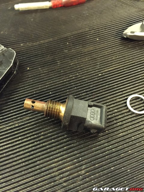

Insugstempgivare
https://www1.garaget.org/gallery/images/185/184306/184306-ba237fc1127dcdd8289cd11414d57556.jpg

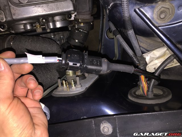

Crimpa och löda
https://www1.garaget.org/gallery/images/185/184306/184306-7bdd221cd914344cbd80c60a8915145c.jpg
Bosch-kontakter
https://www1.garaget.org/gallery/images/185/184306/184306-ddd195f8381bd9fbd44d13b670e65c16.jpg

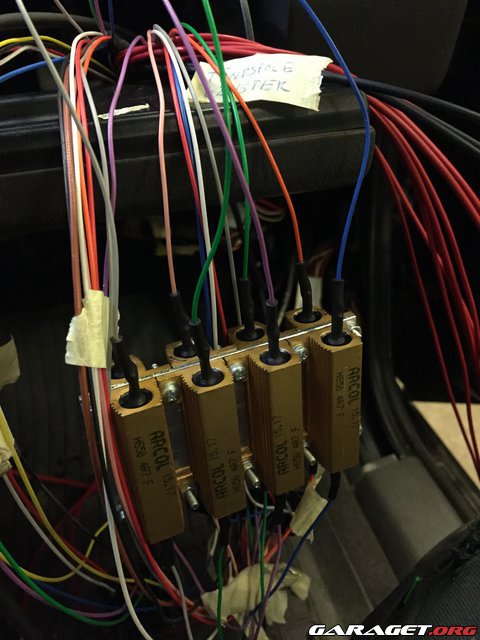

Spridarmotstånd, så här i efterhand skulle jag kört utan för att få lite extra knuff till spridarna
https://www1.garaget.org/gallery/images/185/184306/184306-e6b8c3ce503614188e18459d1db892ac.jpg

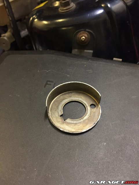

Original triggerskiva
https://www1.garaget.org/gallery/images/185/184306/184306-5c3cff2b684059cafa9ddabff6fb4e5a.jpg
Lätt modifierad
https://www1.garaget.org/gallery/images/185/184306/184306-847643a520f0c8453274f8afe2362009.jpg

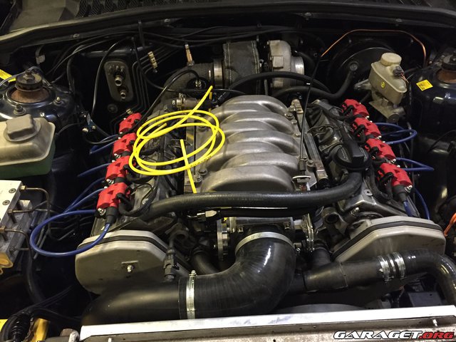

Tändspolekablage
https://www1.garaget.org/gallery/images/185/184306/184306-c1951d00b9adcdedb1fa45da8136b2bb.jpg

Börjar närma sig provuppstart, polvänd vevtrigger
https://www1.garaget.org/gallery/images/185/184306/184306-3c66156cf9ca77ce85ececbe43c3e2db.jpg

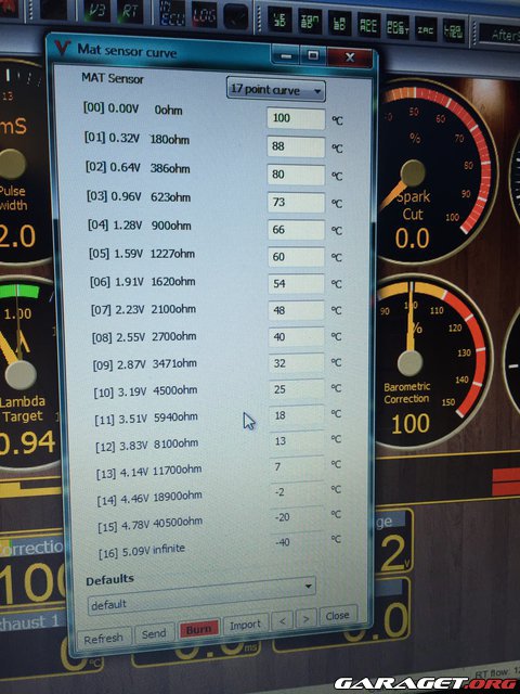

Kalibrera insugstempgivare
https://www1.garaget.org/gallery/images/185/184306/184306-69f2bae73f15e2b00d8b4e646861d381.jpg

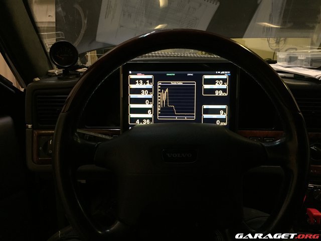

Bluetoothadapter
https://www1.garaget.org/gallery/images/185/184306/184306-c8c2ca0d12388b0dfb6337c0fa486cf0.jpg
Ready for take off
https://www1.garaget.org/gallery/images/185/184306/184306-df1509511b96ba0820d17761483979b0.jpg
Efter lite justeringar i datorn så hoppade bilen igång big_smile
Efter lyckad uppstart var det dags att knåpa ihop kylaren
https://www1.garaget.org/gallery/images/185/184306/184306-2d25164ef4834619d4c9cb469864cabf.jpg

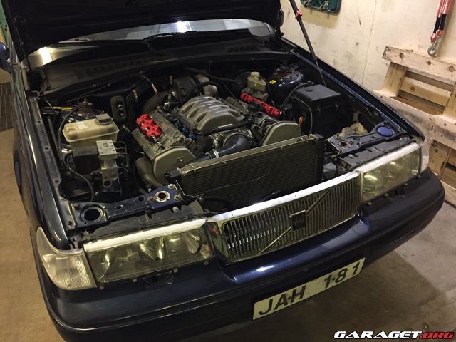

Kylarslang
https://www1.garaget.org/gallery/images/185/184306/184306-285b544bce5e0df3bbb629688cfe2386.jpg
Till värmepaket förbi turbon
https://www1.garaget.org/gallery/images/185/184306/184306-a6cb0c2d1b7dba3fcb2fa9234d60ebd7.jpg
https://www1.garaget.org/gallery/images/185/184306/184306-709fc862d9f0c1469c94ff70652977c8.jpg
Laddtryckstyrning
https://www1.garaget.org/gallery/images/185/184306/184306-92c189e472c8b18e838e5ed1fba83cb1.jpg
Börjar likna nåt
https://www1.garaget.org/gallery/images/185/184306/184306-fba8d6fa50f808a77e8e789f3d0ec8f6.jpg

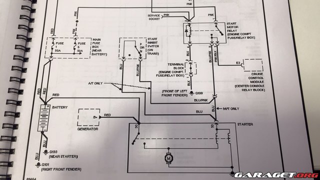

Råkade kortsluta en stepperutgång i boxen, stoppa i ett boschrelä med skyddsdiod i en biltema relähållare, hade inte en tanke på att minuspolen på hållaren vart tvärt om mot bosch rollmad
https://www1.garaget.org/gallery/images/185/184306/184306-92e6d9c86a14786cc9462341f01a1234.jpg
