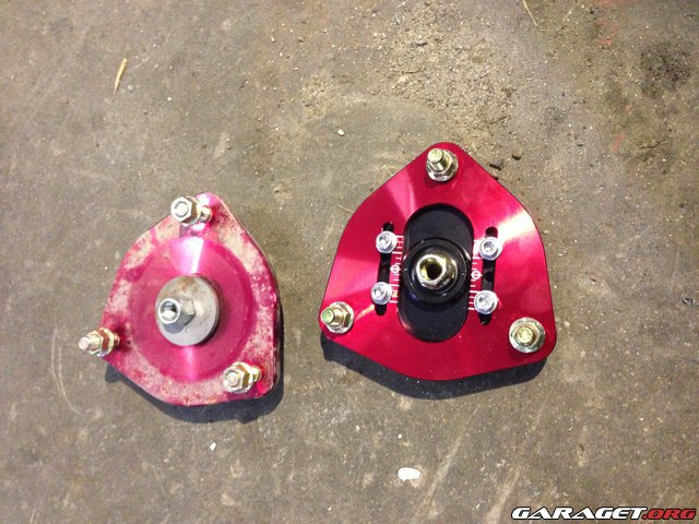

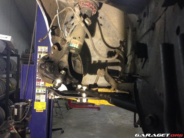

https://www1.garaget.org/gallery/images/73/72042/72042-85cc69f5c256f3ecc4a03b2995c1efcc.jpg

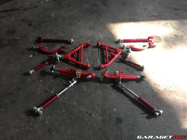

GSP Ställbara armar, numer rätt mycket ombyggda.

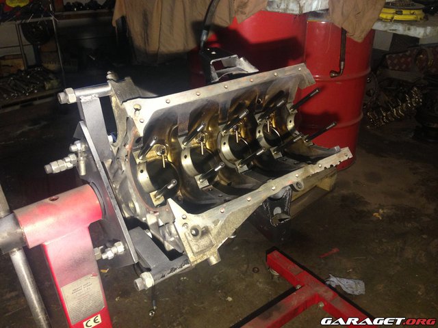

https://www1.garaget.org/gallery/images/73/72042/72042-f1a34424d855dd5e9cdb56f643150241.jpg
Arp till ramlager.

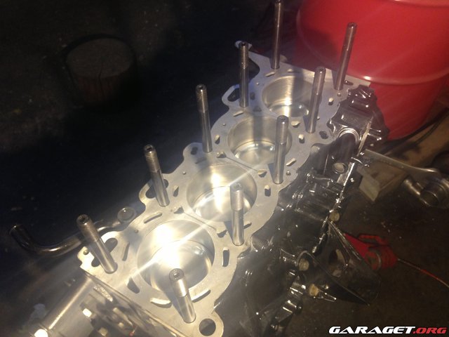

https://www1.garaget.org/gallery/images/73/72042/72042-8a7dabd1199dcace687e383c9453e62f.jpg

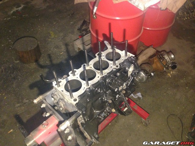

1/2'' Arp till toppen
https://www1.garaget.org/gallery/images/73/72042/72042-aedffa1fb4e0215e062dae272490ee13.jpg
Botten ihopspänd!

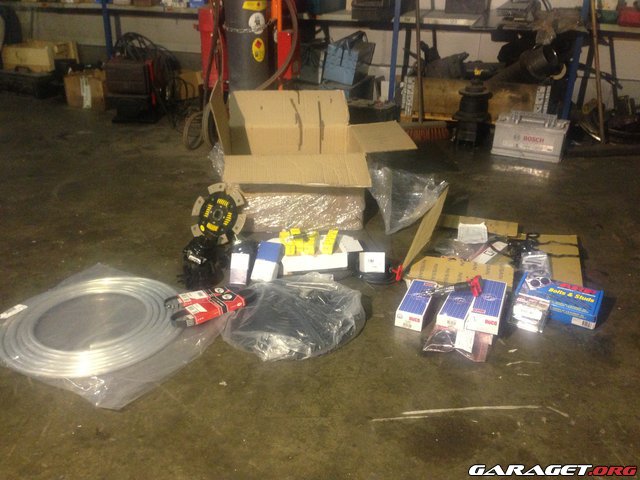

https://www1.garaget.org/gallery/images/73/72042/72042-4b26d6f7c2096ffd365c1c0f44791dd0.jpg
Efterlängtat japtuning paket!!

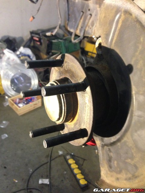

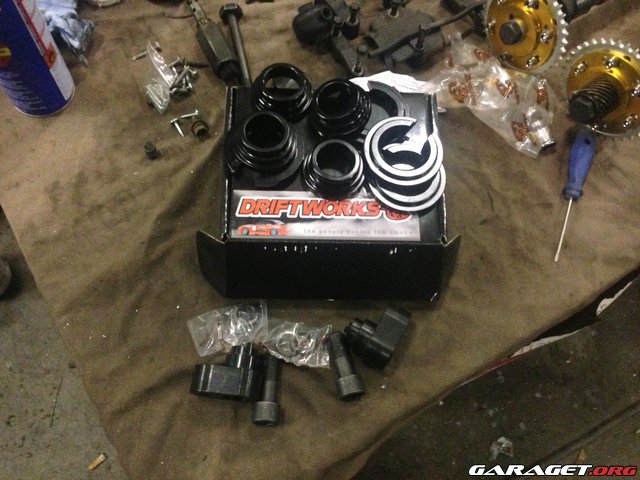

https://www1.garaget.org/gallery/images/73/72042/72042-73f0a5e3bfbfb167ae186a6580bca5cc.jpg
Driftworks, geomaster offset rackspacer, styrspacer och locking collars.

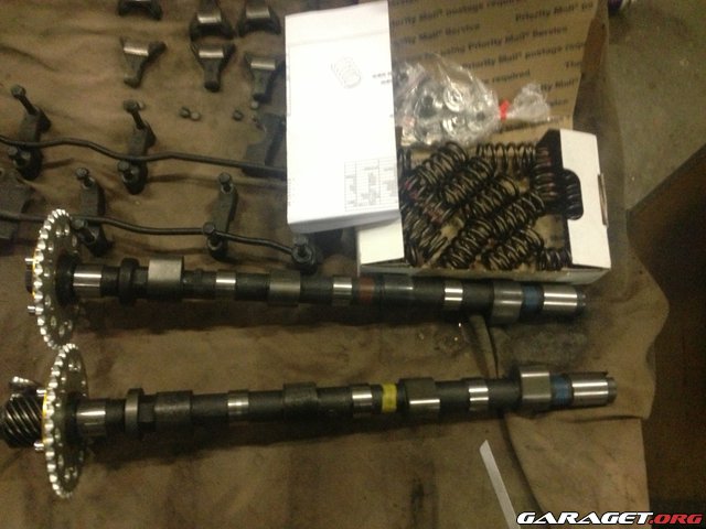

https://www1.garaget.org/gallery/images/73/72042/72042-fded7da7af4fe4adf09b68d744926a79.jpg
Brian Crower steg 3 kammar, 272 grader duration 12,55mm lyft IN&EX. Brian crower fjädrar+titan retainers.

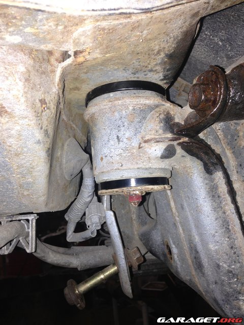

https://www1.garaget.org/gallery/images/73/72042/72042-e6fb2665bdc39f62581e6faf0fa53df4.jpg
Driftworks subframe locking collars.

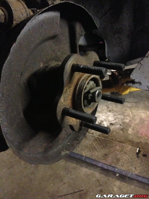

https://www1.garaget.org/gallery/images/73/72042/72042-a578433e55d11b2cead8a61c9d561db9.jpg
63mm ARP bak
https://www1.garaget.org/gallery/images/73/72042/72042-accbc208516928887832d200d85668a3.jpg
63mm ARP fram
https://www1.garaget.org/gallery/images/73/72042/72042-8646b431ac9bf18ad3ffaeda06e451ef.jpg
Track, styrvinkel ökad, ackermann reducerad, förbättrat rollcenter och bump steer.

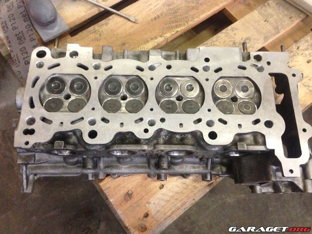

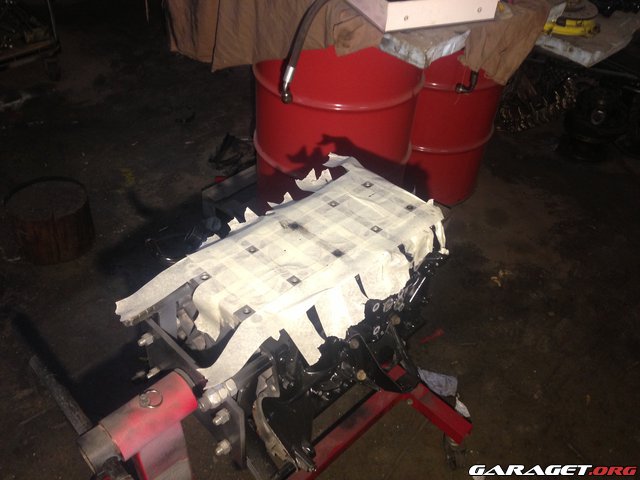

https://www1.garaget.org/gallery/images/73/72042/72042-573cb0470f798613b19ae56cecdb824d.jpg
Portat, planat & inslipade ventiler.

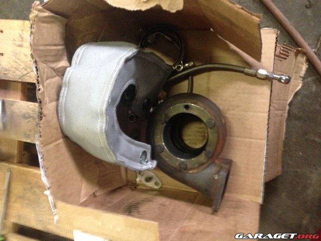

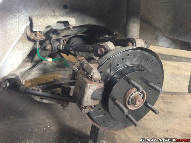

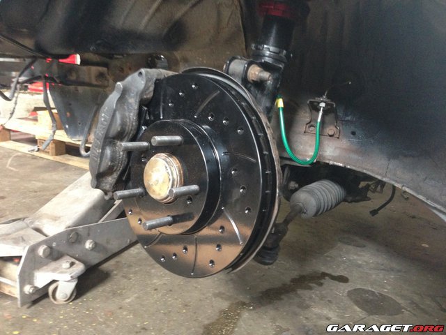

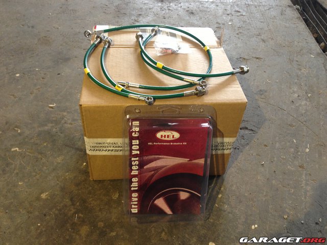

Broms och kopplings slangar.
https://www1.garaget.org/gallery/images/73/72042/72042-a692e6246505946933d3936abd555404.jpg
https://www1.garaget.org/gallery/images/73/72042/72042-555184f2fe44ed510669c003dc935408.jpg
https://www1.garaget.org/gallery/images/73/72042/72042-2694a632140bb9168b8c0128ed85622d.jpg
https://www1.garaget.org/gallery/images/73/72042/72042-91f60df39171a5cad3c303f5ac81bf4e.jpg

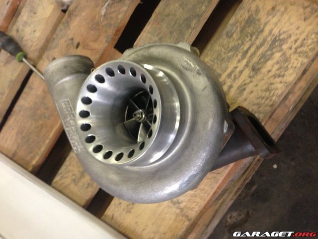

https://www1.garaget.org/gallery/images/73/72042/72042-455ff0d055eda0af5f5f81e89bb73be6.jpg
Precision 5858

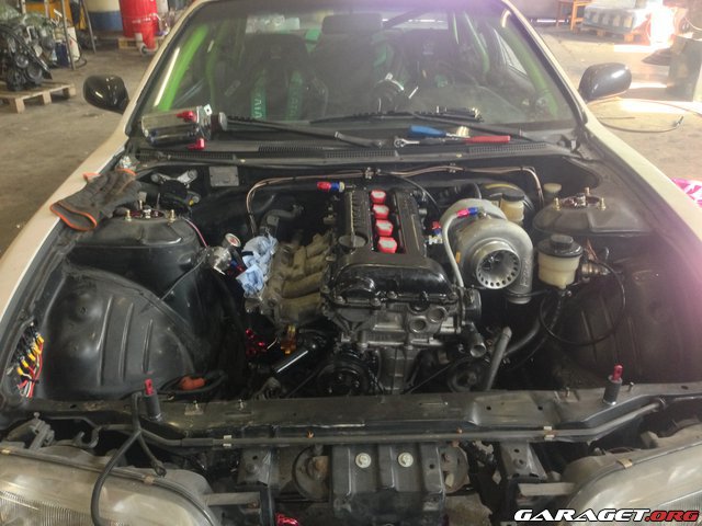

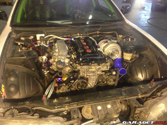

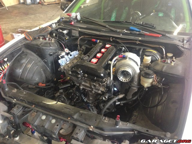

motorn hopplockad!
https://www1.garaget.org/gallery/images/73/72042/72042-9994df1be7ceff2d579fc7b4c69137af.jpg
https://www1.garaget.org/gallery/images/73/72042/72042-4a0e177863755de889d6229dc65c026d.jpg
i bilen!

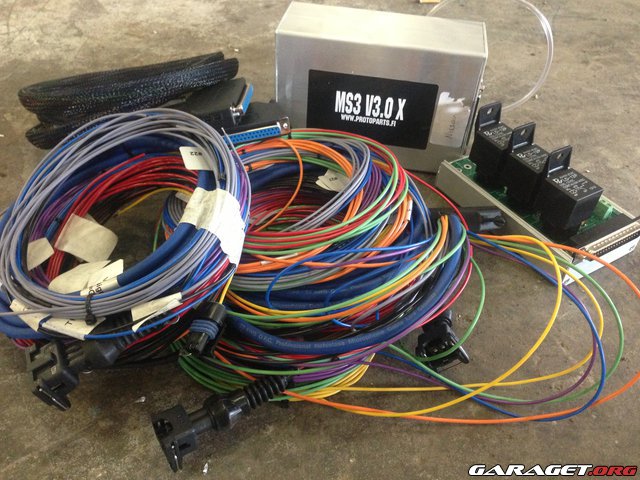

https://www1.garaget.org/gallery/images/73/72042/72042-4e7a06d3c2f357b5dd2887edcc967e6b.jpg
MS3X

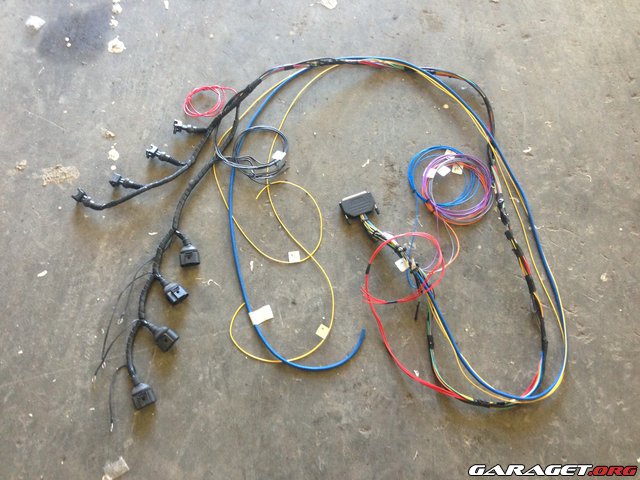

Kabelhärva pågång!
https://www1.garaget.org/gallery/images/73/72042/72042-6eb4ad4632af911c2385349b6aef7135.jpg
Kabelhärva monterad!

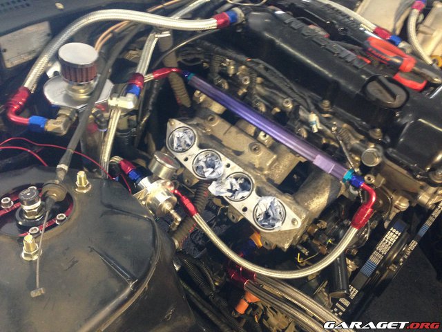

Ombyggt till toppmatade spridare!

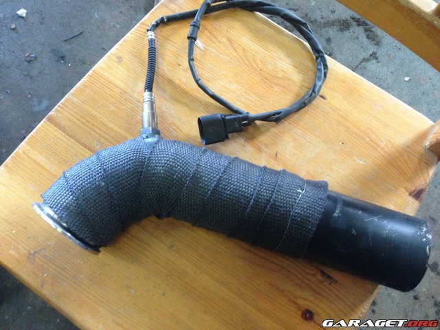

https://www1.garaget.org/gallery/images/73/72042/72042-ecf6e8821fc3ac20908b4c16a76d7114.jpg
Downpipe pågång!
