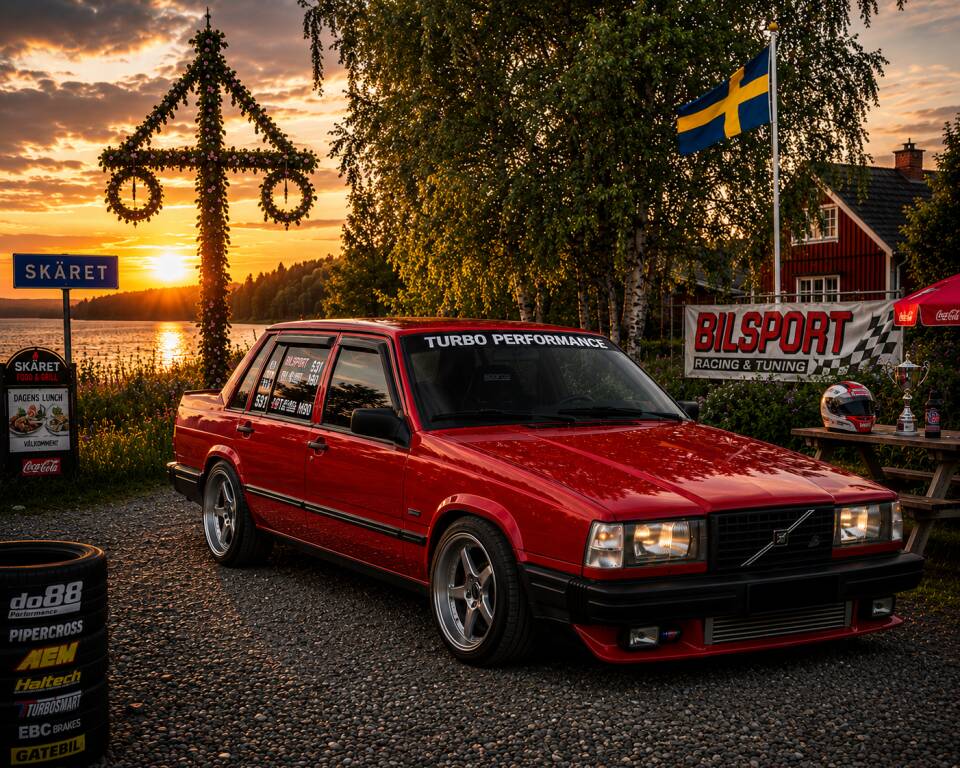

Glad Midsommar : https://www1.garaget.org/gallery/images/157/156287/156287-6ba0666f71f13e402d6eb8d30847056f.jpg
