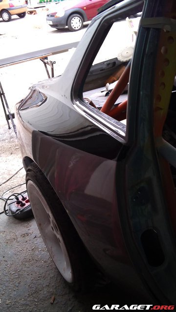

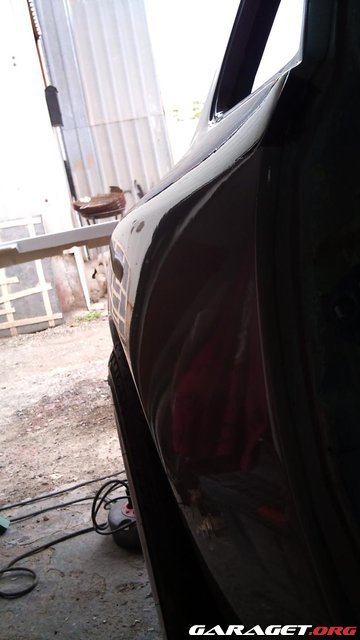

Det ser lite roligare ut med lack!
https://www1.garaget.org/gallery/images/133/132274/132274-921cbcf2a19913da71528e5f381cd5d8.jpg
https://www1.garaget.org/gallery/images/133/132274/132274-836818edc11c36491e87ad620f90b694.jpg
Lackad bak skÄrm

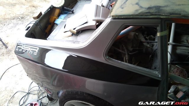

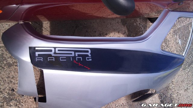

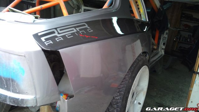

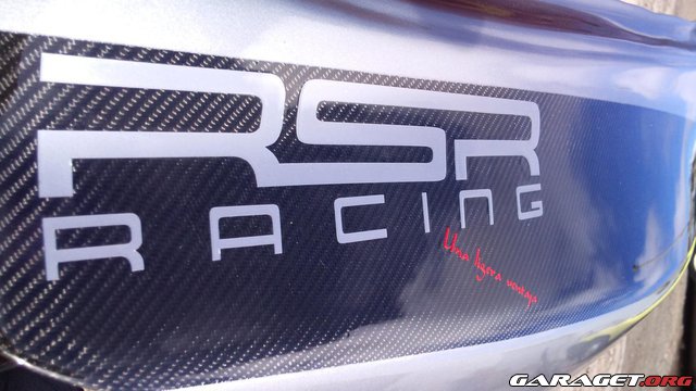

https://www1.garaget.org/gallery/images/133/132274/132274-869a0847c8cd1c11b1873ea4574584e0.jpg
https://www1.garaget.org/gallery/images/133/132274/132274-ebdd4db981d0ace92b8555c65f28d22f.jpg
https://www1.garaget.org/gallery/images/133/132274/132274-28bb689c56fff30b3cbdc8020019458c.jpg
https://www1.garaget.org/gallery/images/133/132274/132274-c99c053eb261bb42252c42132388875a.jpg
