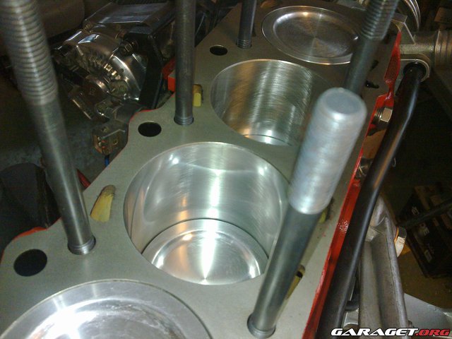

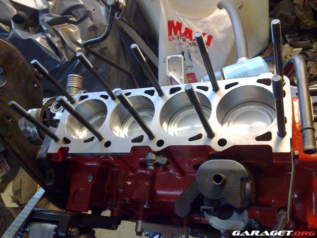

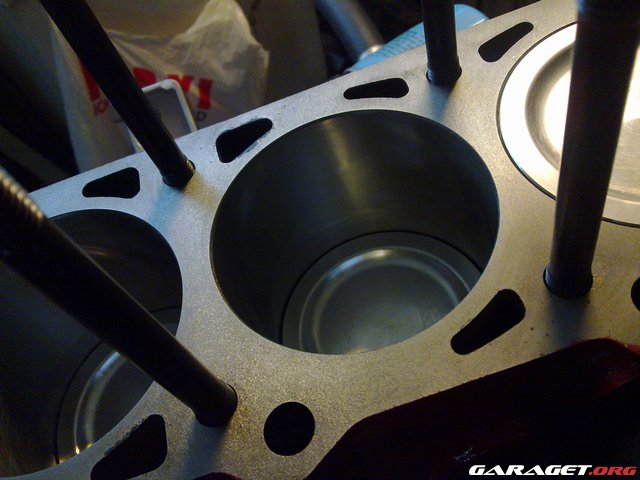

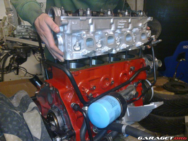

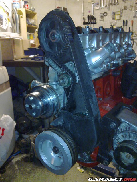

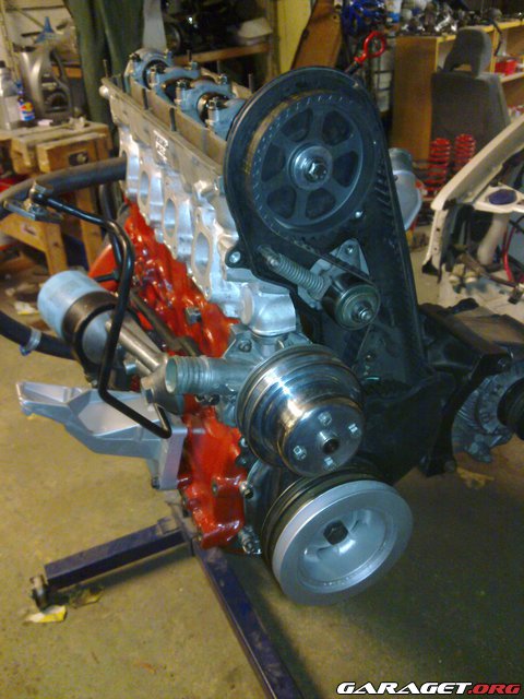

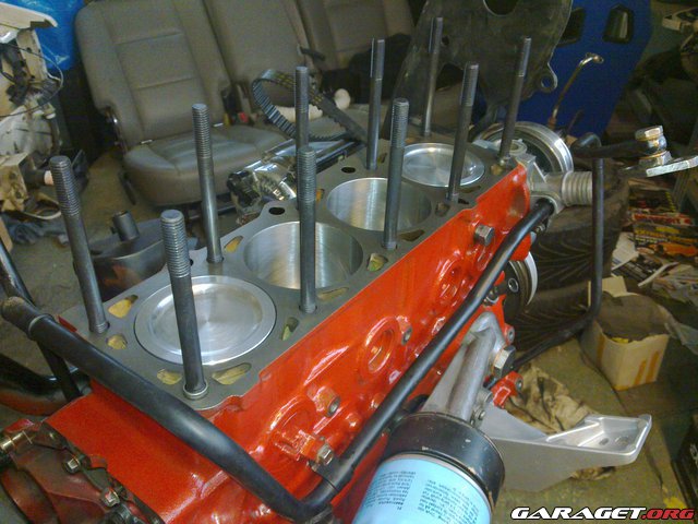

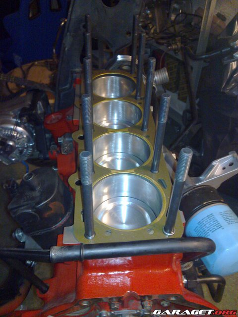

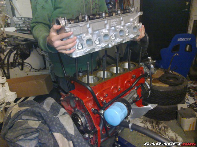

Kan va kul me lite bilder! smile
https://www1.garaget.org/gallery/images/98/97947/97947-4097eeb340e869a4582564f7a58cf634.jpg
https://www1.garaget.org/gallery/images/98/97947/97947-42cd0029f0747f6950c6469963096584.jpg
https://www1.garaget.org/gallery/images/98/97947/97947-d34408e6df0f1171cd78216c74d168cb.jpg
https://www1.garaget.org/gallery/images/98/97947/97947-7270d7575850632a9d2e9528e217b030.jpg
https://www1.garaget.org/gallery/images/98/97947/97947-89025999a7726a3298687941556afeba.jpg
https://www1.garaget.org/gallery/images/98/97947/97947-c6946d80849be3a9b9178b97272fc756.jpg
https://www1.garaget.org/gallery/images/98/97947/97947-1ef111462ee75b0911d9de4fa15f717d.jpg
https://www1.garaget.org/gallery/images/98/97947/97947-a20663e816fbab0095446bc2960fc5c1.jpg
https://www1.garaget.org/gallery/images/98/97947/97947-ffc432016d16e6009cb7279eb7b892c7.jpg
https://www1.garaget.org/gallery/images/98/97947/97947-4e2f153a6b37ec11ecf1e978ad6c4068.jpg
https://www1.garaget.org/gallery/images/98/97947/97947-ad47a4c13c331810071eeb8c7a482141.jpg
https://www1.garaget.org/gallery/images/98/97947/97947-a634f6bc0c8b0e5a19db952e7e3f8fc4.jpg
https://www1.garaget.org/gallery/images/98/97947/97947-16dfc8cf62aa0f979c06632239f876b1.jpg
https://www1.garaget.org/gallery/images/98/97947/97947-f9299c04af55378e01cd2c820c6ead62.jpg
https://www1.garaget.org/gallery/images/98/97947/97947-172cc0c8ee36187a6c789847fb783e62.jpg
https://www1.garaget.org/gallery/images/98/97947/97947-de275ee08cc6312f12cb212fab3723b3.jpg
https://www1.garaget.org/gallery/images/98/97947/97947-c3bea79de56c9e6810b0ac06609100fb.jpg
https://www1.garaget.org/gallery/images/98/97947/97947-a417b3cffd55937cff1f29f92f26e5c4.jpg

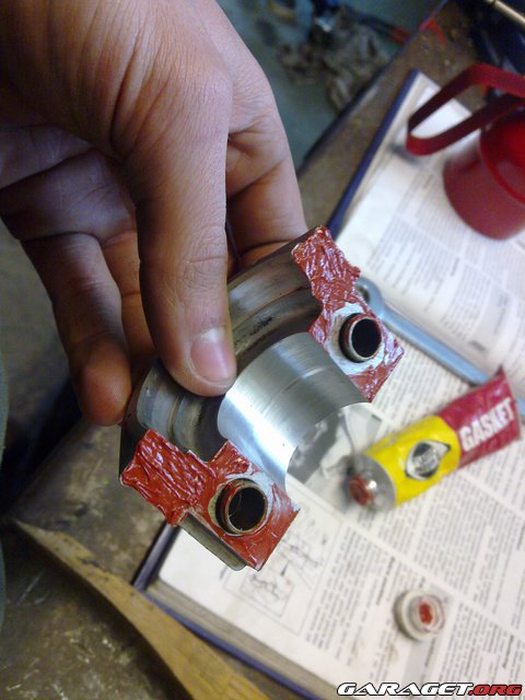

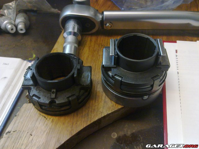

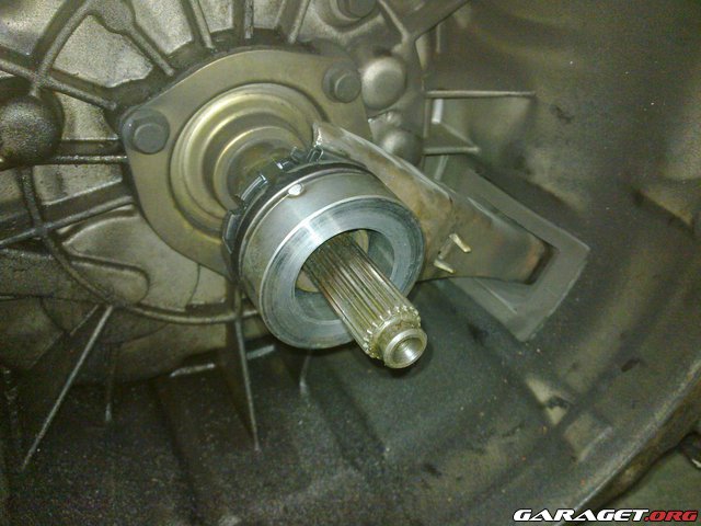

Nytt vs gammalt urtrampningslager
https://www1.garaget.org/gallery/images/98/97947/97947-fe30bc61275248accccde889cd1fd1e0.jpg
Distansen för att kunna köra med mitt svänghjul och lamellen på fel håll
https://www1.garaget.org/gallery/images/98/97947/97947-7d80c53abfbf304531f9e5f8e2f166f2.jpg
TACK!

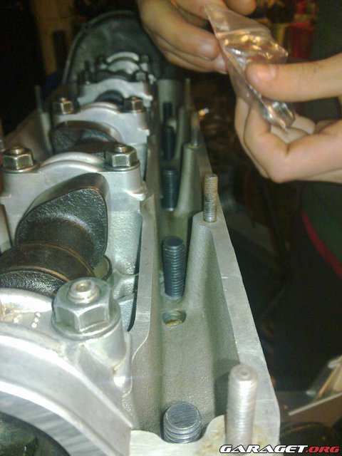

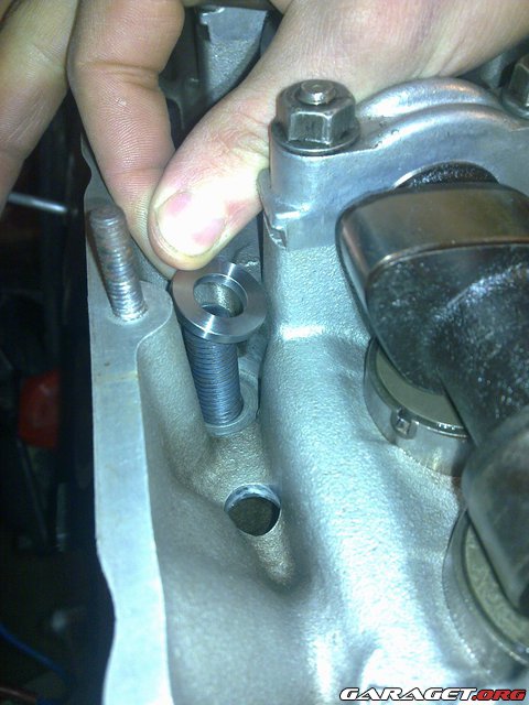

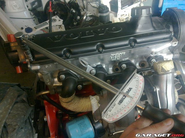

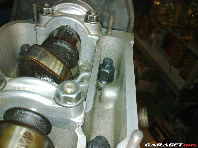

måste fråga. varför har du ett rör i toppen när du drar åt toppen?
http://www1.garaget.org/gallery/images/ … 783e62.jpg
..han är ju übersnabbish....svosh, svosh. borta med vinden....
Dom säger att man inte kan köpa kärlek för pengar... Då har dom inte åkt Audi!
High on diesel and gasoline
368 Inlägg
2 april 2011
#310
Jag skulle gissa på att han har motorn i ett motorstativ så han har röret som mothåll för att inte hela stativet ska vrida sig smile
2 415 Inlägg
2 april 2011
#311
så kan de vara tongue hehe.
SMR | SM Racing
280 Inlägg
2 april 2011
#312
känns ju halvbra att sticka in ett rör i en kanal och dra åt >.<
040 RedLine
1 219 Inlägg
2 april 2011
#313
Det är bara en slang, oljereturen som inte är klar än. Istället för att den inte skulle hänga och va i vägen stack ja in den där, ser kanske lite konstigt ut men så e de smile

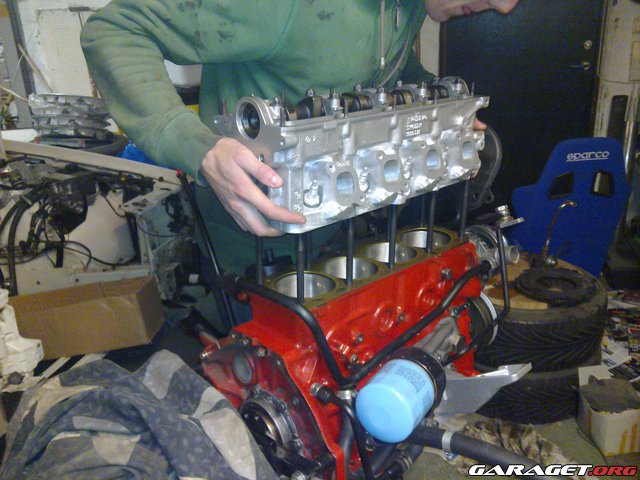

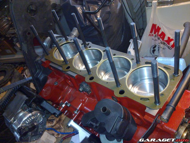

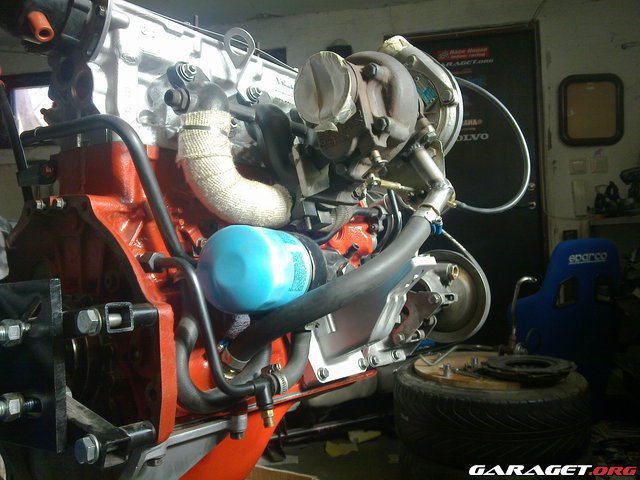

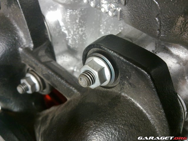

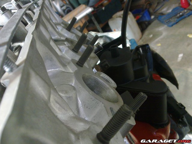

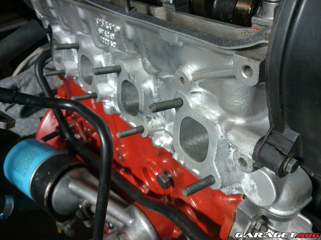

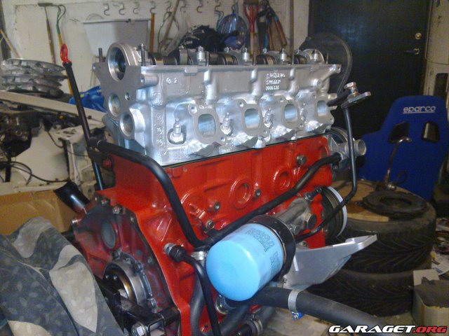

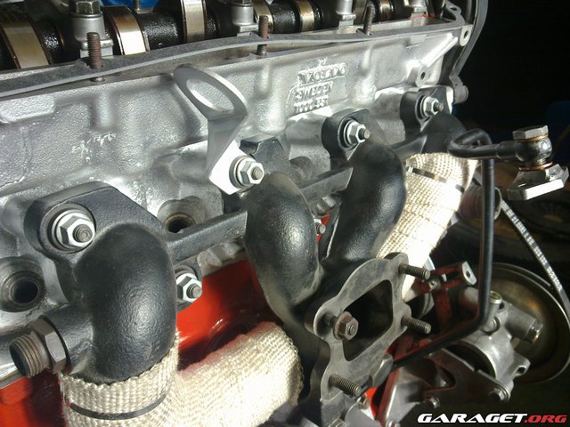

Köpte nya pinnbultar till avgas och insug + muttrar och brickor, gick ju "BARA" på ca 800kr big_smile
https://www1.garaget.org/gallery/images/98/97947/97947-0032b358aaf7b9e3601cb658bf261adf.jpg
https://www1.garaget.org/gallery/images/98/97947/97947-7232a409804120b6de9417495b9b0a37.jpg
https://www1.garaget.org/gallery/images/98/97947/97947-e0b5c8dbb3f8b80647bcf52febe3e78d.jpg
https://www1.garaget.org/gallery/images/98/97947/97947-6bd4b880ee1e35c1d6b6b0a88743cee5.jpg

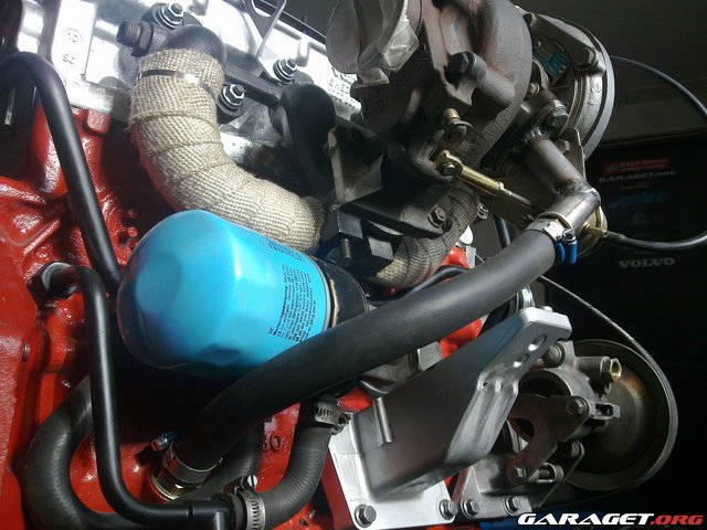

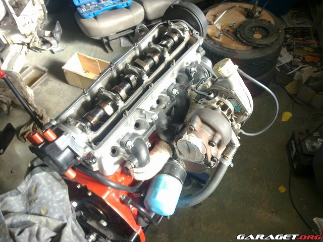

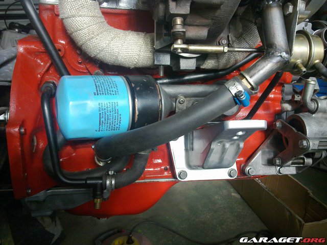

Oljereturen ska nog funka smile
https://www1.garaget.org/gallery/images/98/97947/97947-882f7b4e774eaa09f223f82aaaaaa0ed.jpg
https://www1.garaget.org/gallery/images/98/97947/97947-c224771bc963f7583bc60fae0ac8b2d8.jpg
https://www1.garaget.org/gallery/images/98/97947/97947-0861e2cb2069cd316128607fe4507b7c.jpg
https://www1.garaget.org/gallery/images/98/97947/97947-95a1d42c605852e7e3763fc6473b63d7.jpg
https://www1.garaget.org/gallery/images/98/97947/97947-1893750a705c9426b914fc6555fbbcd7.jpg
https://www1.garaget.org/gallery/images/98/97947/97947-e7ecc5c47a983130316cb6eb0988e849.jpg

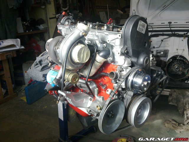

Min fina momentnyckel wink haha
https://www1.garaget.org/gallery/images/98/97947/97947-b1a79f44f438406196df57e0a17d83c1.jpg

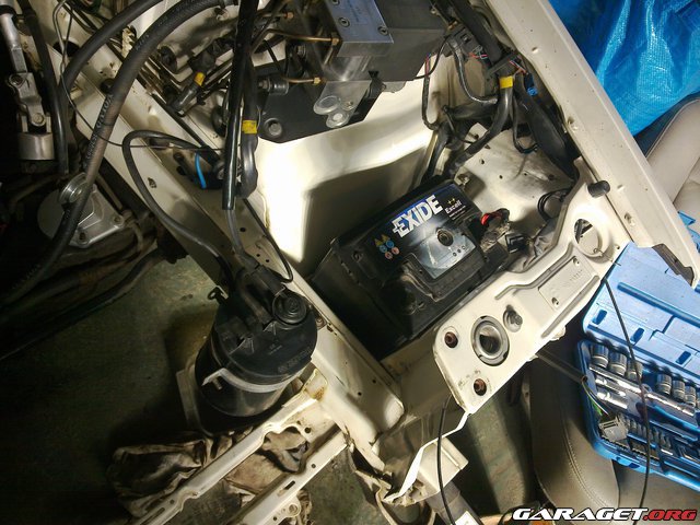

Batteri på plats smile
https://www1.garaget.org/gallery/images/98/97947/97947-bc935628371bb966704d3e6234eb6508.jpg

batteriet står på fel plats smile tongue skall ju stå i bagarset smile
Håller med wink

Ser mycket bra ut wink
Köpte du pinnbultarna och muttrarna på Volvo?
Tackar smile Jadå de kommer från volvo tongue

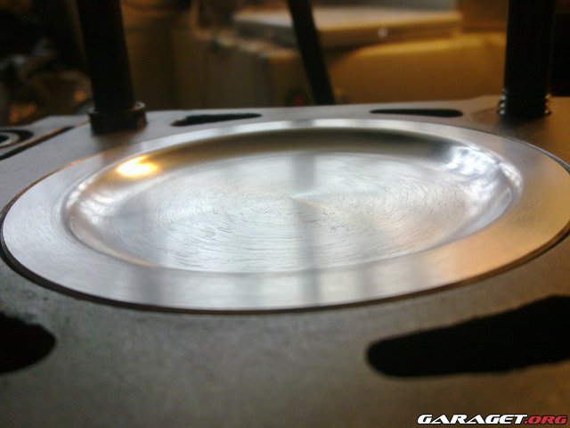

7 april 2011
#320
dannnej skrev:
BrajjAxx skrev:
turboforssen
Nej har inte slipat på shimsen, utan har slipat på ovansidan av ventilen. Slangarna är köpta på en hydralikfirma här i malmö fosie smile
dannnej
Aha oj, tänkte fel nu. Tänkte inte på att kolven inte går lika långt ner om ja har längre stakar.
Men så vill man förhindra detta, eller varför har Sten Parner valt att ha så pass låg squish?
Han har nog inte valt någonting, det har nog bara blivit så om han "kopierat" orginalkolvar.
Som grundregel kan man säga att spalten mellan kolv och topp där den är som minst får INTE ligga mellan 1,5-3mm, det är direkt skadligt. (topplockspackning inräknad)
Och ligger den under 1,5 så kan man ladda upp till 1,5 bar, ska man ladda mera så måste spalten ökas till över 3mm.
Det här är ganska avancerad motorteknik, så fråga mig inte varför, men det är vad jag kommit fram till smile
Frågade Sten Parner om detta, han påstod följande:
Du ska aldrig ha mindre än 0,8mm mellan kolv och topplock. Större är inga problem, men ha tändning och bränslemängd rätt det är viktigast.
Arrovs F1 motor har 0,8mm
AB SPM motor
Sten
Har kollat runt lite och tror ditt påstående kommer ifrån Erland Cox.
