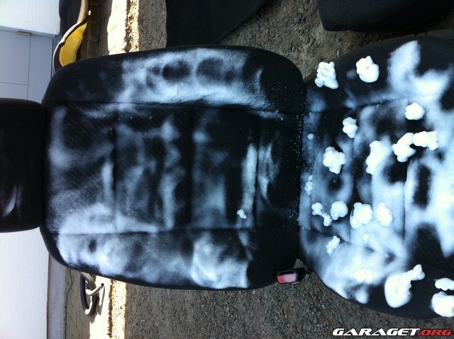

Sen påbörjades tvättningen.
https://www1.garaget.org/gallery/images/158/157943/157943-1bcfe63e10689387977d440be9893108_tn.jpg https://www1.garaget.org/gallery/images/158/157943/157943-49cb37f3286f5e419b5538808de36c14_tn.jpg https://www1.garaget.org/gallery/images/158/157943/157943-5957e9b73f461311c54dec82095121a5_tn.jpg https://www1.garaget.org/gallery/images/158/157943/157943-b496e87bf55f4e39eb310e384501253e_tn.jpg https://www1.garaget.org/gallery/images/158/157943/157943-63dead2f40ac12f478dc0a777c7a3f05_tn.jpg https://www1.garaget.org/gallery/images/158/157943/157943-22ea3af3a970e3fc25af19b819bebd75_tn.jpg https://www1.garaget.org/gallery/images/158/157943/157943-f2ad5cbb9368bed300b56dc01b999b6e_tn.jpg https://www1.garaget.org/gallery/images/158/157943/157943-e2980d8046a2a44d3fd35fbac9c76b00_tn.jpg https://www1.garaget.org/gallery/images/158/157943/157943-97bd4c389333206d741b53659454845b_tn.jpg
Renare än på många år.

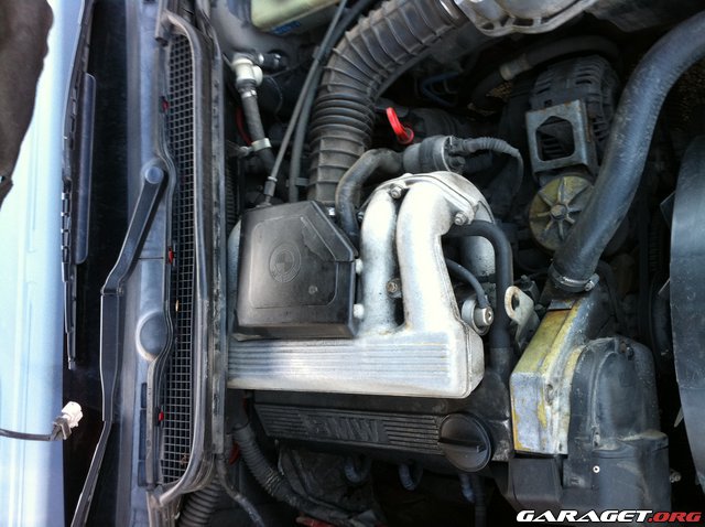

https://www1.garaget.org/gallery/images/158/157943/157943-163723cf97fca02f058db5c3eefbcaad_tn.jpg https://www1.garaget.org/gallery/images/158/157943/157943-8e99b572d07061387dfcf33b687dcd88_tn.jpg https://www1.garaget.org/gallery/images/158/157943/157943-0c9b7c7a2bcdcaff7aad45ac91fc6610_tn.jpg

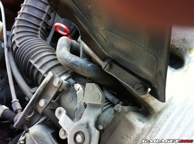

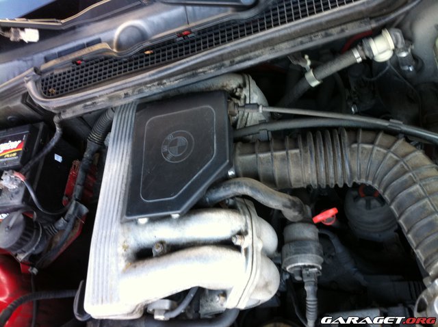

Mycket smuts gömde sig under huven.
https://www1.garaget.org/gallery/images/158/157943/157943-9234240b01e2656e3fcebf33c2582064_tn.jpg https://www1.garaget.org/gallery/images/158/157943/157943-c02c1d2b75ca0807fd4de9f30916a6a8_tn.jpg https://www1.garaget.org/gallery/images/158/157943/157943-c9bb2ffbcf0fe25207e24068f0e9b3f9_tn.jpg https://www1.garaget.org/gallery/images/158/157943/157943-62649f0b96e9849de4ef2999b52630d3_tn.jpg https://www1.garaget.org/gallery/images/158/157943/157943-771fa8674f14c5a0f50b221eb09ddecd_tn.jpg
Lite bättre blev det iaf.

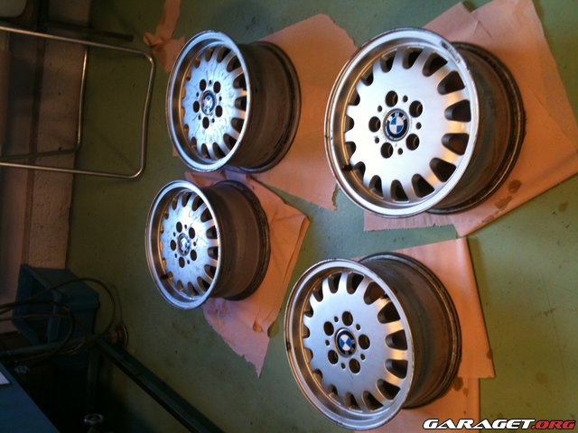

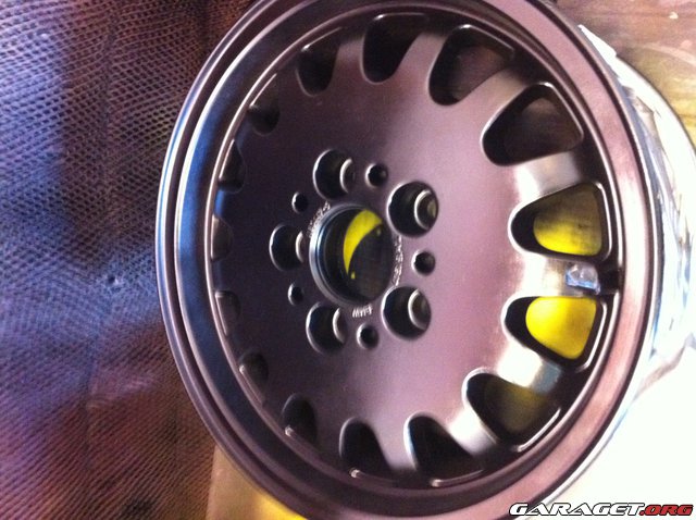

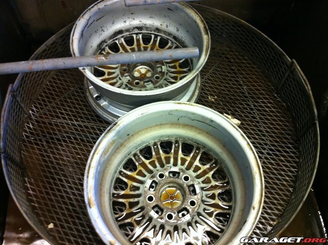

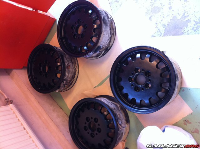

Update med vårt arbete med våra fälgar!
https://www1.garaget.org/gallery/images/158/157943/157943-ff43a5661d23d13fb79472edd7bae315.jpg Ner med fälgarna i en stor jävla tvätt med nafta.
https://www1.garaget.org/gallery/images/158/157943/157943-fc16ab51a14330ae526f6e2d7a9d83fd.jpg Juuuciy!
https://www1.garaget.org/gallery/images/158/157943/157943-7bc810d3078ebf853bb93b40994ee03c.jpg Rena blev dem!
https://www1.garaget.org/gallery/images/158/157943/157943-2d040260b22f29ac31d7ff53b433645d.jpg Avspolning med högtryck
https://www1.garaget.org/gallery/images/158/157943/157943-1be220a99e967950aad0b1d8dd7896d8.jpg Redo för spackling, vi använde sandpapper för att fina till ytan inför lackning.
https://www1.garaget.org/gallery/images/158/157943/157943-72f778f0405fdae21c06903a2584082b.jpg Spackling med (plasticpadding?)
https://www1.garaget.org/gallery/images/158/157943/157943-541788529d4e83b85137e69b3bf0deef.jpg Värsta hacken blev vi av med. Tyvärr finns det ingen bättre bild på resultatet.
https://www1.garaget.org/gallery/images/158/157943/157943-fe85e6f7b718a808e05098a712a57174.jpg Ossian blästar baksidan av fälgarna
https://www1.garaget.org/gallery/images/158/157943/157943-69c0ea933fa9add08e8c6f67744de082.jpg Mycket bra resultat!

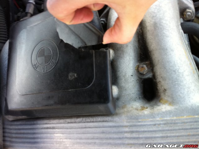

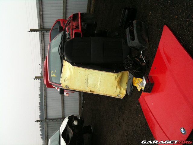

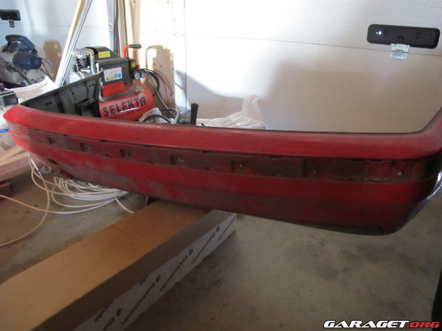

Som ovanstående inlägg säger så var vi uppe i falkenberg på Returbilen och plockade hem lite godis.
Freebee!

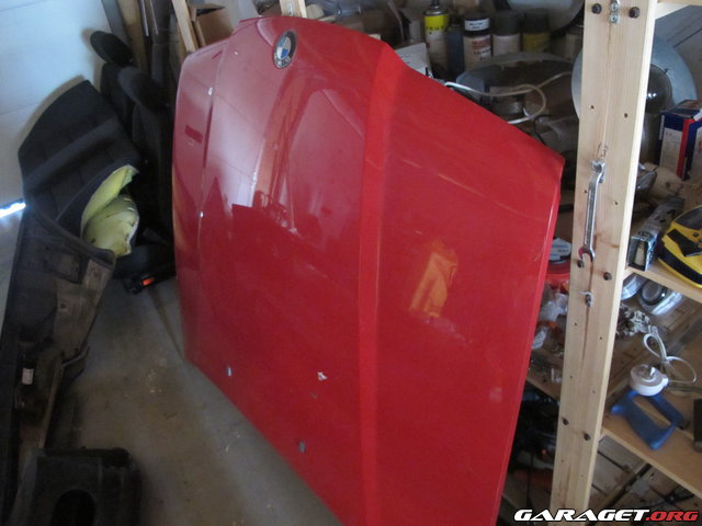

https://www1.garaget.org/gallery/images/158/157943/157943-c22a1f73e120f9812c1f073a36497ef6.jpg
En ny motorhuv som ska lackas svart.

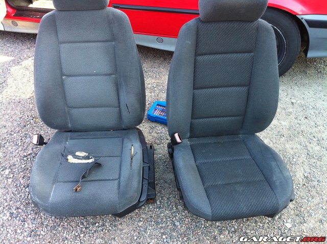

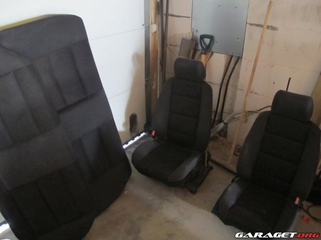

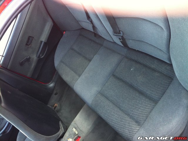

Lite nyare stolar samt baksäte än dem som sitter i.
https://www1.garaget.org/gallery/images/158/157943/157943-cb48eb2c5c4dc4ae77e13f2a35e80bfa.jpg

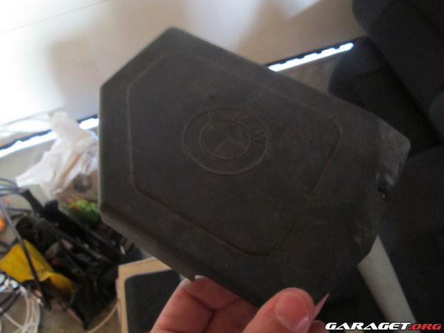

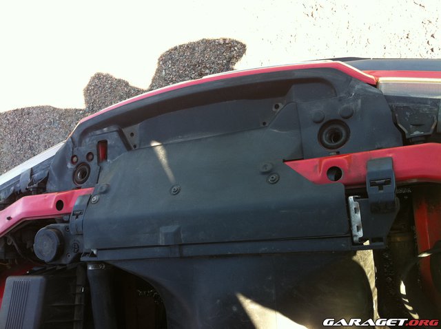

Ny motorkåpa då vår förra är sprucken.
https://www1.garaget.org/gallery/images/158/157943/157943-4c5159ac3402a48f94855c38c07dd48e.jpg
Ny kofångare bak, vår är förnuvarande grå.

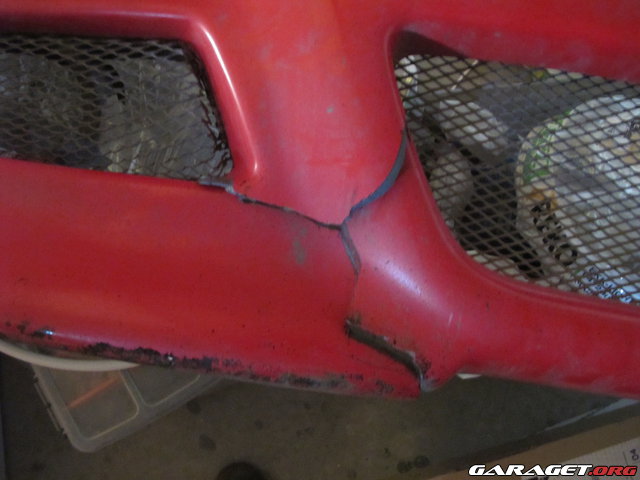

https://www1.garaget.org/gallery/images/158/157943/157943-729bec095dac7b2193da98c4296ca125.jpg
Ny spoiler!
https://www1.garaget.org/gallery/images/158/157943/157943-42f9c6ebcd71d7adc23b84a17ea409a3.jpg
Dock spruken, men det ska lagas!

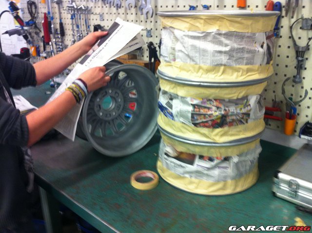

44 Inlägg
3 maj 2011
Vi närmar oss nu lackering, bler halvmatt/halvblank svart.

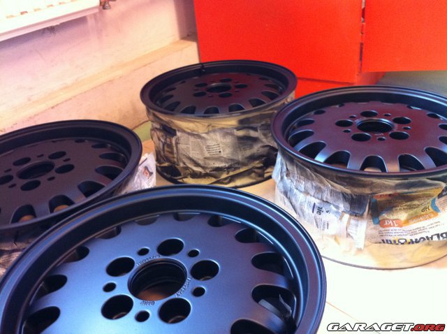

Idag har vi maskerat fälgarna inför lackeringen som ska påbörjas denna veckan.
https://www1.garaget.org/gallery/images/158/157943/157943-9d9757cd6f5f0270210a2db2af1c4e54.jpg
Vi närmar oss nu 1000st besökare vilket vi verkligen tackar för!
Kom gärna med lite kommentarer nu, lite snålt med det.
Mvh Team "JA36"

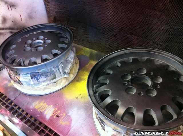

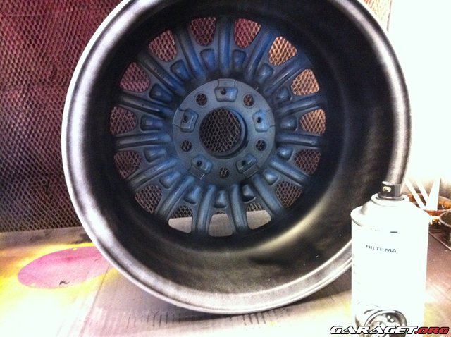

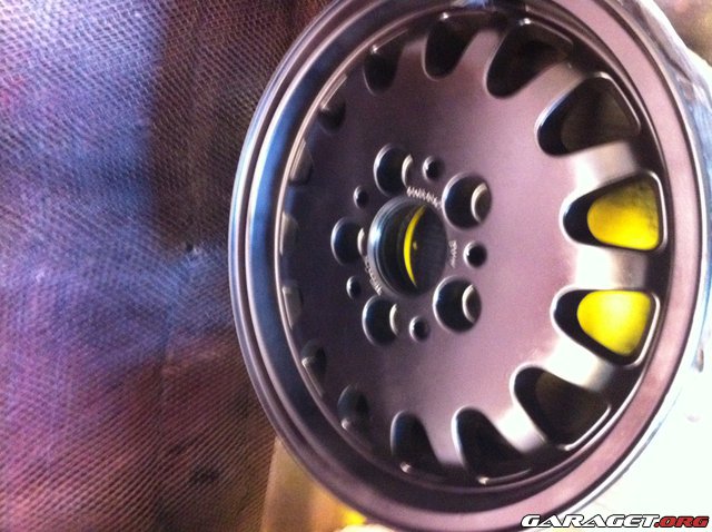

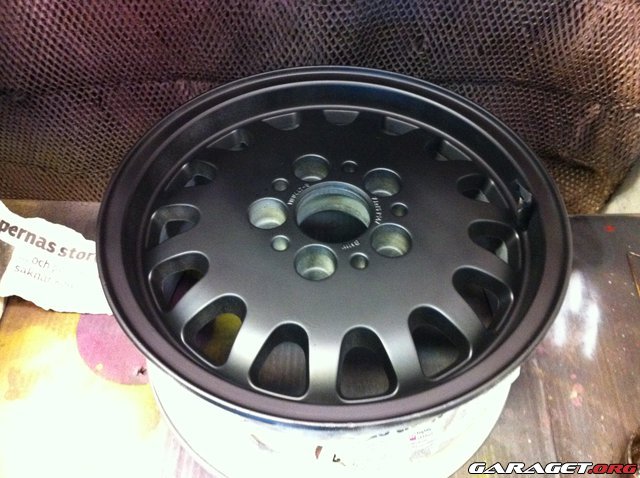

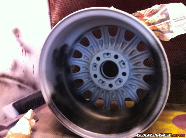

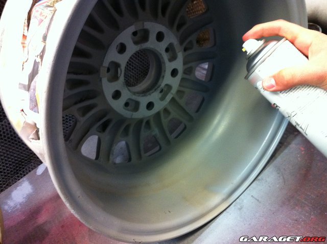

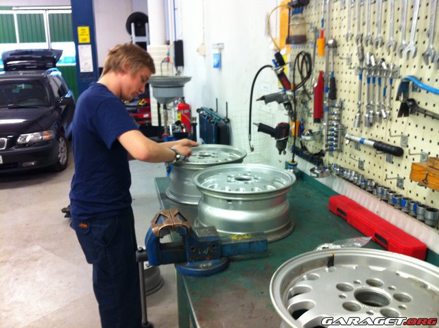

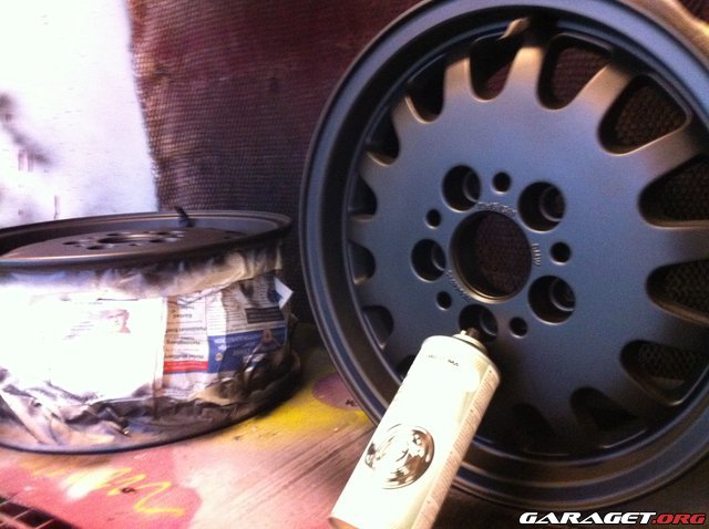

5 maj 2011

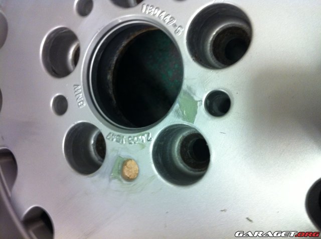

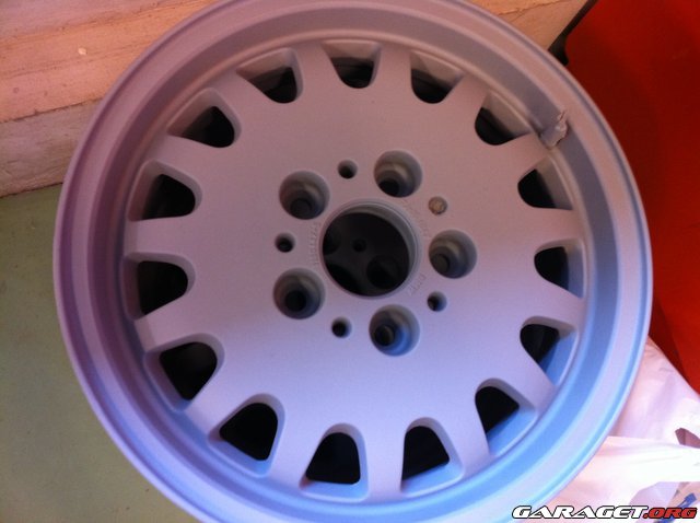

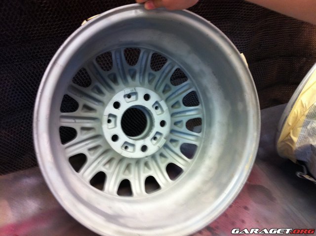

Vi har nu fortsatt vårt arbete med våra BMW orginalfälgar.
Senast ni hörde från oss förberede vi fälgarna för lackering.

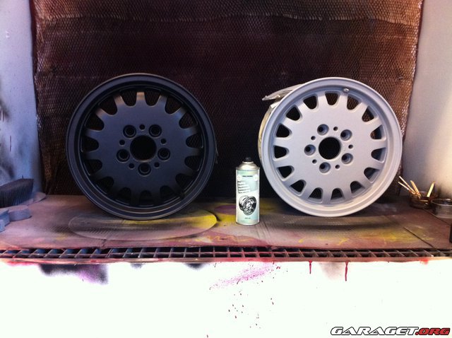

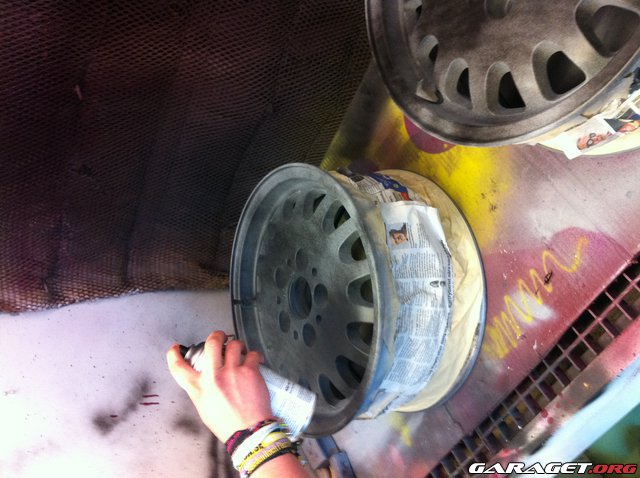

Vi är nu i 5e steget med fälgarna vilket betyder att vi närmas oss slutet, då vi fått gjort mycket senaste dagarna.

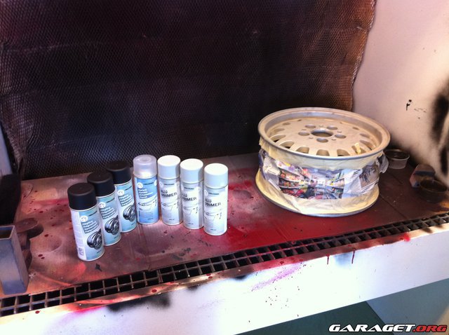

1. Avfetta & tvätta
2. Spackla och laga
3. Slipa och blästra
4. Maskera inför lackering
5. Lackera med Primer
6. Lackera med fälgfärg (svart)
7. Lackera med klarlack
8. Montering
Som Primer använder vi Biltemas Aluminium Primer, mycket nöjd över resultatet och rekommenderar denna produkt. 1 flaska räcker till ca 2 fälgar +/-.

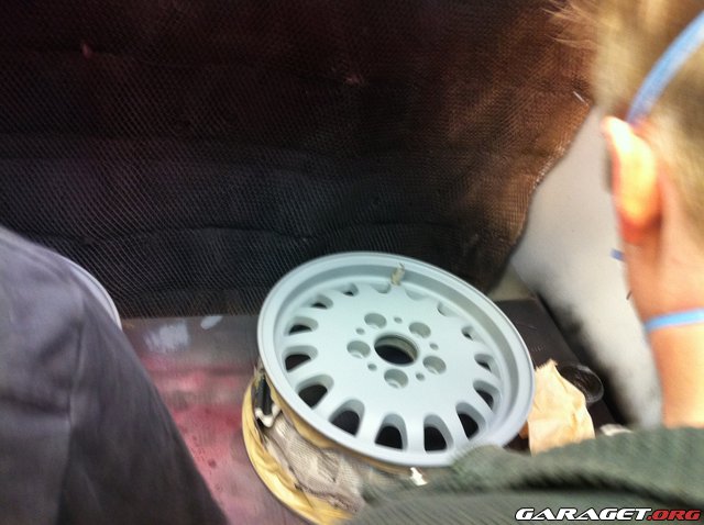

https://www1.garaget.org/gallery/images/158/157943/157943-2bc92034cf7246d4461d5227f70b0799.jpg
Här har vi första fälgen redo
https://www1.garaget.org/gallery/images/158/157943/157943-88dbb1553edd6b7734b13f035321c8b6.jpg
Före
https://www1.garaget.org/gallery/images/158/157943/157943-706f8ddf390639bfe20700920e52354d.jpg
Första lagret primer åker på
https://www1.garaget.org/gallery/images/158/157943/157943-105911dc67499c946c9aa7f697f0cf1b.jpg
Ossian i Team "JA36" arbetar
https://www1.garaget.org/gallery/images/158/157943/157943-bd6b6672243ac6869033dbb23002f178.jpg
Team "JA36" i arbete
https://www1.garaget.org/gallery/images/158/157943/157943-a08244a9d0369d5444af82e27a6dd82e.jpg
Ossian i Team "JA36" bedömmer resultatet
https://www1.garaget.org/gallery/images/158/157943/157943-32e43d33e8f9a87743de9bd2b02464cb.jpg

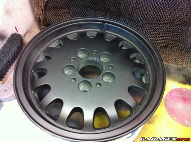

Resultatet med Primer

Idag har vi fortsatt med fälgarna och vi gav oss på att börja lackera dem.
För att matcha vårat tema med "Red & Black" så har vi bestämt oss för att lackera fälgarna svarta, lite åt det mattsvarta hållet.
Vi använde halvblank svart fälgfärg från Biltema och blev även denna gång mycket nöjda med resultatet.
Att tänka på är att denna färg skiljer sig från primer då en burk endast räcker till 1½ fälg.
(Detta dock beroende på hur många lager och hur kräsen man är)
Vi är nu i 6e steget med fälgarna
1. Avfetta & tvätta
2. Spackla och laga
8. Montering
Då sätter vi gång!
https://www1.garaget.org/gallery/images/158/157943/157943-4a609694e7cc4a455004ee86a37c5b78.jpg
Vi börjar med att lackera insidan av fälgen
https://www1.garaget.org/gallery/images/158/157943/157943-c638bc7db72cfaadfcb9913a984e3575.jpg
Första lagret på plats, vi körde ca 3 lager på baksidan.
https://www1.garaget.org/gallery/images/158/157943/157943-16e87411b482d07c44e9f7d1cfbc2ffe.jpg
Så började vi med första lagret på framsidan av fälgen.
https://www1.garaget.org/gallery/images/158/157943/157943-8b183e313d438d1c6d3974902536f773.jpg
Andra lagret.
https://www1.garaget.org/gallery/images/158/157943/157943-af1a15c1e0c8189444bb81b5274c8172.jpg
Ossian i Team "JA36" jobbar
https://www1.garaget.org/gallery/images/158/157943/157943-c7c0243ef088a4719a39967b5c756f41.jpg
Tredje lagret.
https://www1.garaget.org/gallery/images/158/157943/157943-77afa2125a7f25cdee64d9d0bf621f6a.jpg
Fjärde laget.
https://www1.garaget.org/gallery/images/158/157943/157943-bff69460c32fcb8db2ce6f9e97789699.jpg
En glad Ossian berömmer Biltemas kvalité.
https://www1.garaget.org/gallery/images/158/157943/157943-a3b1e120eb2092b1a5d764a25d6a4c99.jpg
Henrik i Team "JA36" in work.
https://www1.garaget.org/gallery/images/158/157943/157943-d6566d1a5b0ecf93e3827f13a84dabdc.jpg
Färdiga resultatet!
https://www1.garaget.org/gallery/images/158/157943/157943-a5dc7f30324ab5cec3ad6e935590e46c.jpg
Skillnaden före och efter.
https://www1.garaget.org/gallery/images/158/157943/157943-eee372509ebc93f218d6e63dcfa20a9f.jpg
Färdiga resultatet på alla fälgarna.
Team "JA36" är mycket nöjda med resultatet och kvaliten som Biltema produkterna levererar.
Vi är även mycket nöjda över framfarten med projektet den här veckan. Vi har fått en hel del gjort även då vi inte har någon avsatt lektionstid till projektarbetet denna terminen. Den schemalägs först efter sommaren. Men vi har fått en hel del gjort.
Det som återstår nu är:
8. Montering
Vi ska försöka hinna med detta så fort som möjligt så vi kan påbörja nästa steg i projektet.
Riktigt vad det är har vi inte bestämt oss ännu. Beror lite på hur mycket tid vi kan lägga mellan lektioner, eftermiddagar samt helger.
Vi kan redan nu påpeka att dem kommande 2-3 veckorna kommer det att vara lite dåligt med update då delar av "JA36" Teamet är bortresta.
Nu önskar vi att ni som läsare kommer med ideér och förslag till projektet, bara att skriva här i tråden.
Med vänliga hälsningar Team "JA36"
Over and out!

Då var det dags för att köra med lite klarlack på fälgarna.
Klarlacken är från Biltema och vi valde att endast köra 2 lager på fälgarna då vi vill ha lite mattsvart effekt kvar på dem.
Steg 7 nu, det börjar ta sig.
1. Avfetta & tvätta
2. Spackla och laga
8. Montering
Här kommer då ett par bilder ifrån dagens arbete.
https://www1.garaget.org/gallery/images/158/157943/157943-dc1f337d9a665c0003b12e3708c191c4.jpg
Första lagret klarlack
https://www1.garaget.org/gallery/images/158/157943/157943-fb08621abbb33a1858c9949975ebfd4f.jpg
Andra lagret klarlack
https://www1.garaget.org/gallery/images/158/157943/157943-f08fc1cd436bd0163262cc042f503f60.jpg
Upprepade processen på alla fyra fälgarna och här är resultatet.

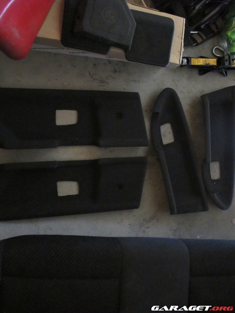

https://www1.garaget.org/gallery/images/158/157943/157943-6642ad911d67aaa4a4b360fcc6d3fabc.jpg

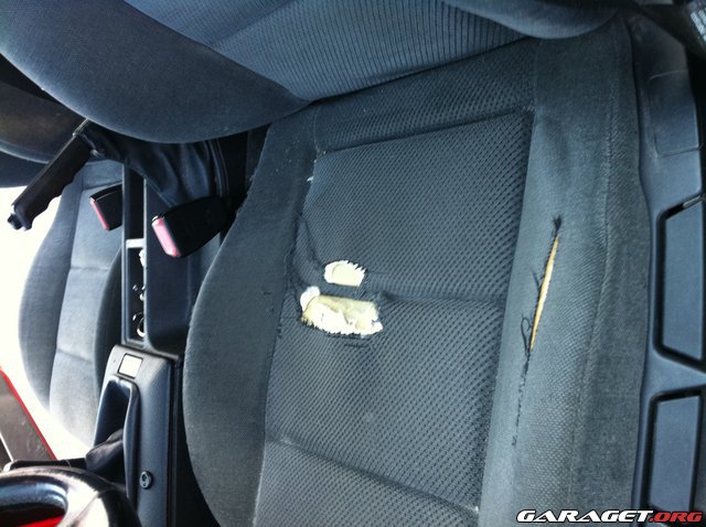

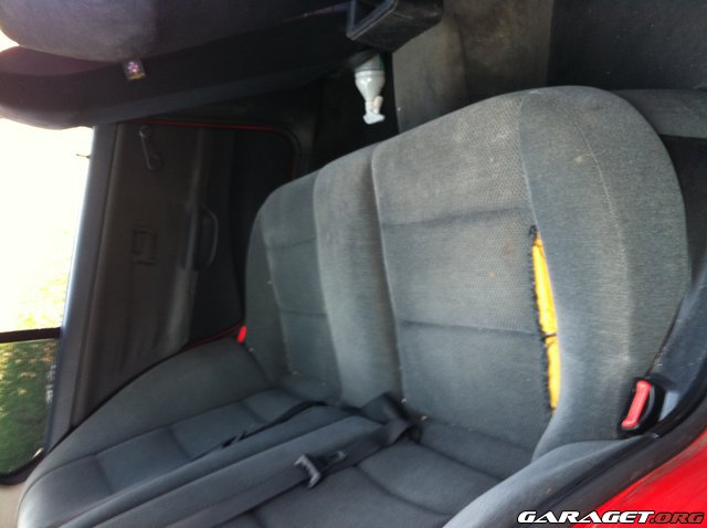

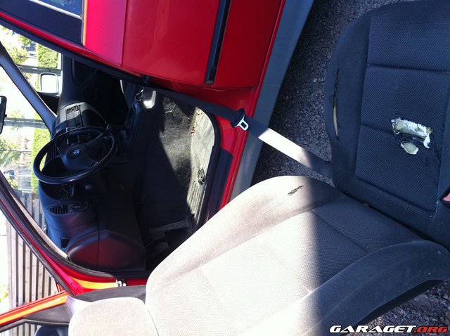

Superfula överdrag till förar samt passagerar sätena.
https://www1.garaget.org/gallery/images/158/157943/157943-6d0db1887cec6b18105801ea8828cef2.jpg
Här under gömde sig en hel del rivor i sätena.
https://www1.garaget.org/gallery/images/158/157943/157943-c3f2f1b19da9490ae999d3d5211fd938.jpg

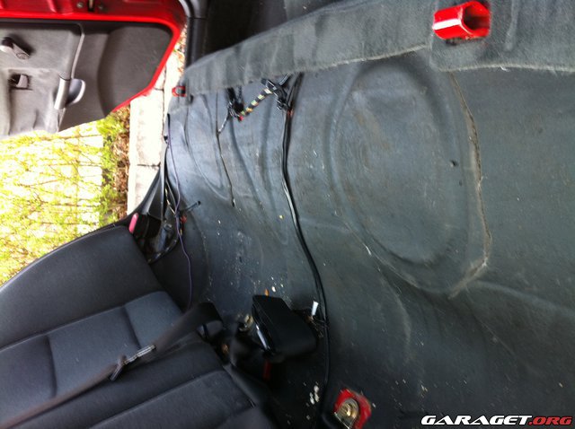

Baksätet
https://www1.garaget.org/gallery/images/158/157943/157943-50033985f3e2450e3cf782d537dee184.jpg
Baksätet plockades snabbt ur, då på bmwn det bara är att lyfta ut hela sätet.

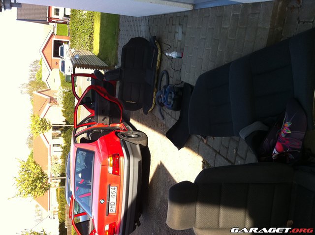

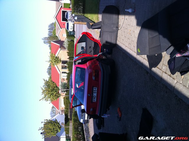

https://www1.garaget.org/gallery/images/158/157943/157943-0debbf181f826f748ede98cec438a40c.jpg
Blev en hel del saker på uppfarten..

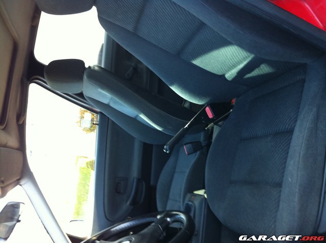

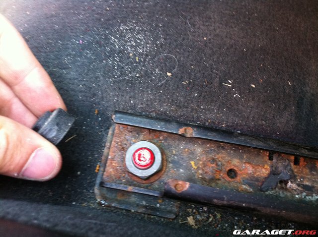

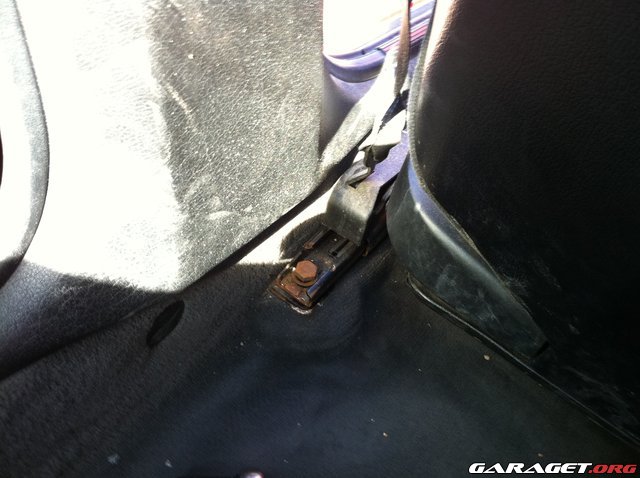

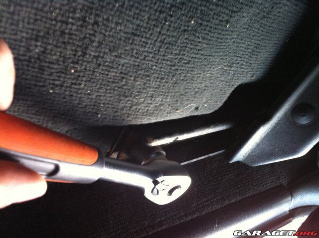

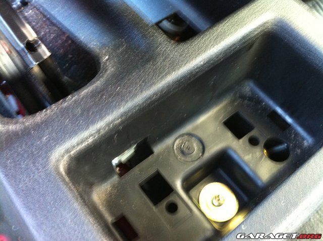

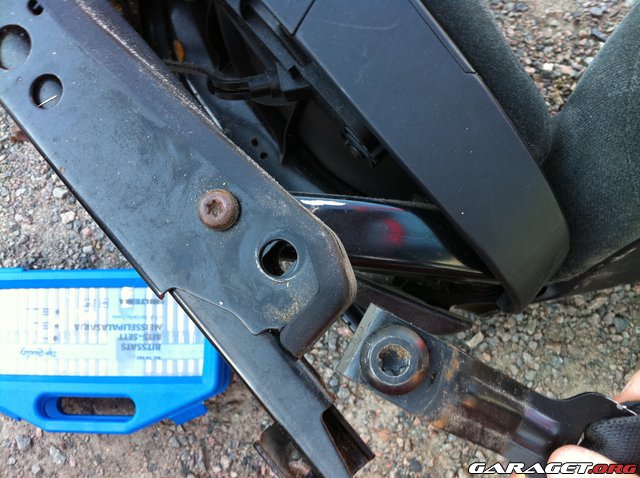

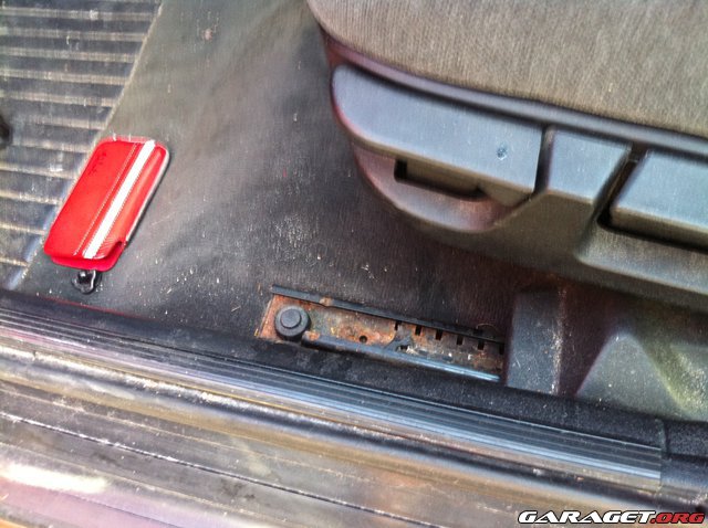

Förarsäten sitter fast med 2st bultar baktill samt 2st muttrar framtill. Bilden är på en av bultarna baktill.
https://www1.garaget.org/gallery/images/158/157943/157943-7f49ebb4accedd8a32f1da53c52ddaca.jpg
På skenan framtill sitter detta gummiskydd.
https://www1.garaget.org/gallery/images/158/157943/157943-522f04f5a5a4731f3c05e8cb983f05dd.jpg
Och under skyddet sitter denna mutter på skenan.
https://www1.garaget.org/gallery/images/158/157943/157943-0352d10ff68653bab141d6526fe4d950.jpg

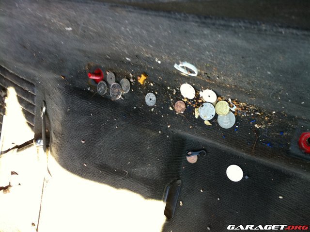

Med väl stolen ute gömde sig lite allt möjligt undertill. Lite kaffekassa där smile
https://www1.garaget.org/gallery/images/158/157943/157943-b1e60128575b6899bca03d52d50d9e22.jpg
Förarsäten väl ute ur bilen.

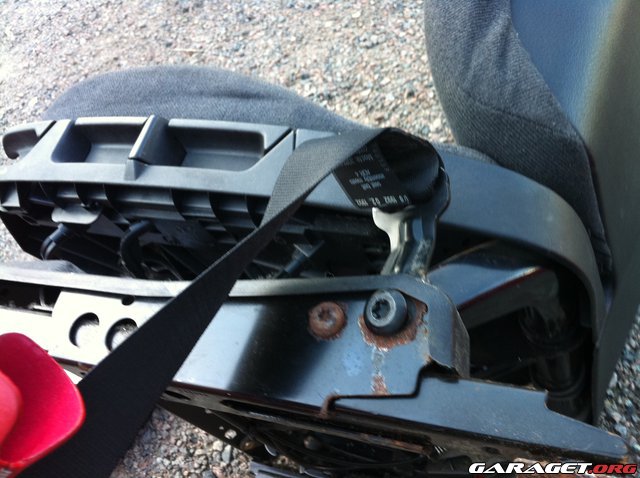

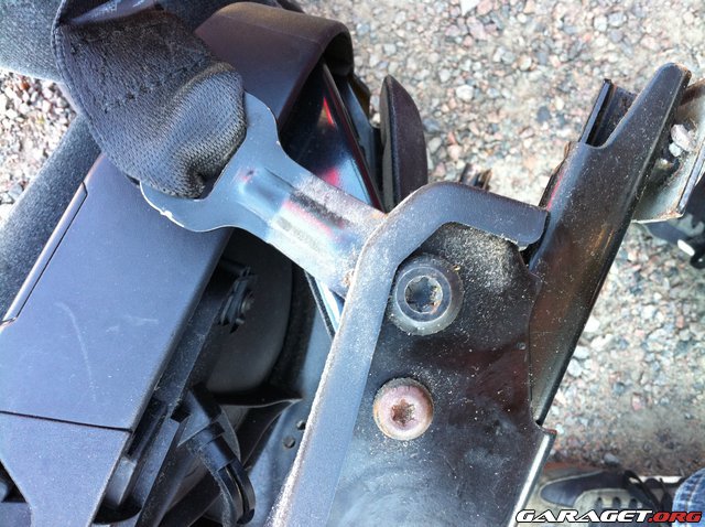

https://www1.garaget.org/gallery/images/158/157943/157943-f73488415aa49fe1c5ee775894f69f67.jpg
Bältets fäste i stolen, simpel torque. (Satt fast som fan)

Got it!
https://www1.garaget.org/gallery/images/158/157943/157943-9d9dd76a68f8dd34a164ae21a522fa7a.jpg
Lite skillnad på gamla och nya sätet.
https://www1.garaget.org/gallery/images/158/157943/157943-709e3db8d712a6779b96c561b80c6854.jpg

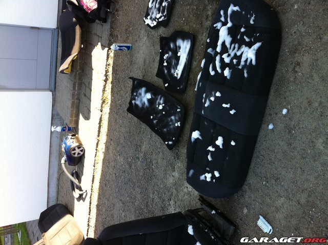

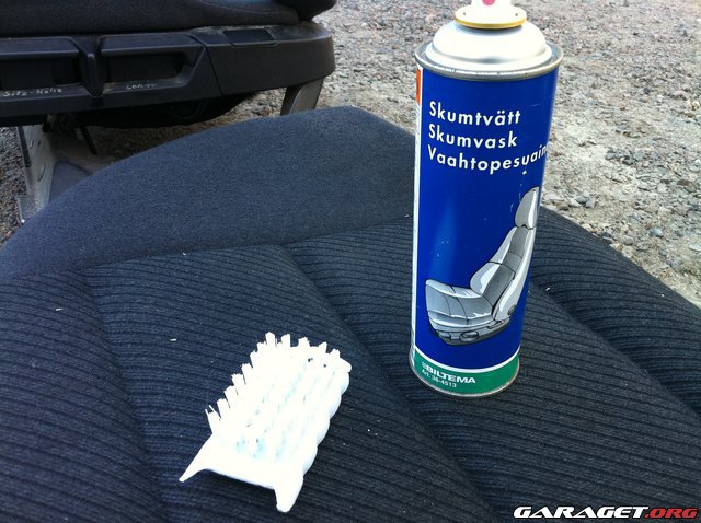

Blev även att tvätta av nya sätet samt baksätet.
Biltemas skumtvätt fungerar utmärkt!
https://www1.garaget.org/gallery/images/158/157943/157943-4cc21e7d9fd0552df1c94f2d56d6f15d.jpg
Skum!
https://www1.garaget.org/gallery/images/158/157943/157943-b5d19186d6a27d69c3a4e733b07f0aa5.jpg
Mer skum!

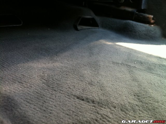

Blev att dammsuga lite i bilen också.

Går ju inte att klaga på att Team "JA36" någon gång kommer att ha ont om verktyg då detta är hemma hos medarbetare Henrik. Samt att vi har arbetsmöjligheter i Ljungbyhed i skolan.
https://www1.garaget.org/gallery/images/158/157943/157943-2f5f5c7d8e8c82046c9defa782036117.jpg
Mer eller mindre krigsfält på uppfarten då Saaben också ville parkera.

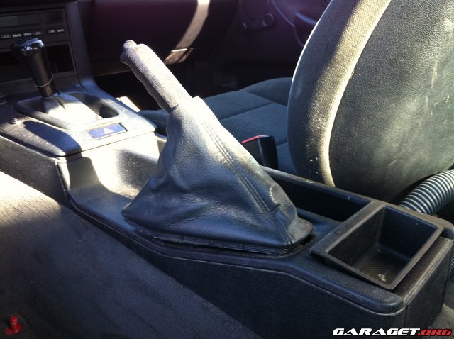

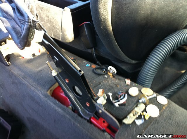

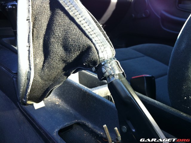

Henrik gav sig också på kåpan vid handbromsen då denna ska modifieras lite.
https://www1.garaget.org/gallery/images/158/157943/157943-7ed230c10fd96e3e76bb519f77e5b0d3.jpg
Bara att dra upp daggmasken och klippa en stripes.
https://www1.garaget.org/gallery/images/158/157943/157943-59f583e824ebbfd59cf88e07528dcbce.jpg
Sen en skruv här bak under en av "lådorna"

Vi hade även en motorkåpa som Henrik passade på att byta.
https://www1.garaget.org/gallery/images/158/157943/157943-2b65f0b23d3ec6d0075f88bb12219a95.jpg
Var ju en liten spricka i den.
https://www1.garaget.org/gallery/images/158/157943/157943-74afe28d7133b830a59cf5ac61aa58b2.jpg
En skruv här
https://www1.garaget.org/gallery/images/158/157943/157943-3175195ac7b5e74cdf31d931695b02a8.jpg
Och två här
https://www1.garaget.org/gallery/images/158/157943/157943-9f4eb754fa484ee10fac24bf3afee01a.jpg
Sen samma procedur för att fästa den nya, fast bakvänt.

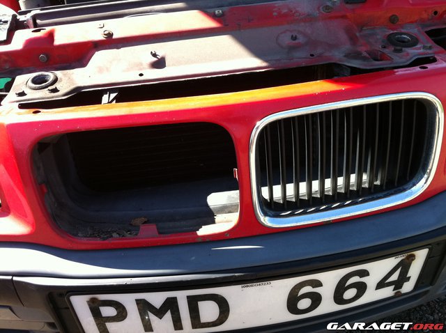

9 maj 2011
Update ifrån 8 Maj.
Team "JA36" beslutade igår att vi även ska lackera grillen eller njurarna som det också kallas svarta.
Så eftersom BMW:n fortfarande stod kvar i Helsingborg så var det bara för medarbetaren Henrik att sätta igång med avmontering. Tanken är att dem ska vara lackerade och tillbaka på BMW:n denna veckan.
Handlingsplan:
1. Avmontering
2. Tvättning
3. Blästring/slipning
4. Lackering med primer
5. Lackering med svart färg
6. Montering
Här kommer lite bilder ifrån avmonteringen och snabbtvättningen 8 Maj, enjoy!

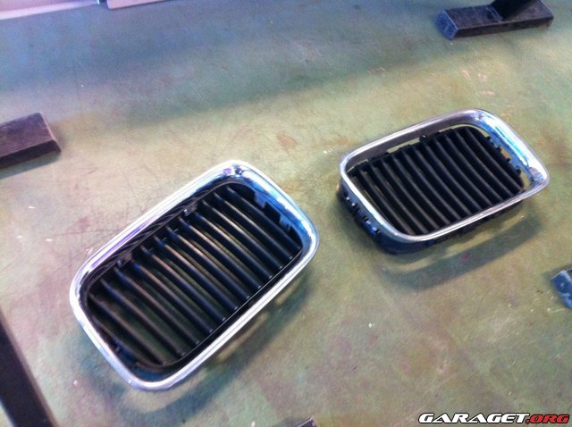

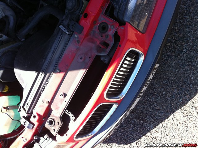

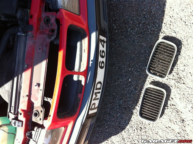

https://www1.garaget.org/gallery/images/158/157943/157943-05c5352a9ed5a0f129db6a3c0ed4135e.jpg*
Grillen/Njurarna som ska lackeras svarta. På bilden ser dem väldigt fina ut men så är icke fallet.
Ytplasten har lossnat på flera stället så en lackering kommer inte mer lägligt!

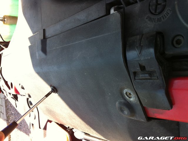

https://www1.garaget.org/gallery/images/158/157943/157943-55b75cbf5aab2c46efec35f151638e2a.jpg

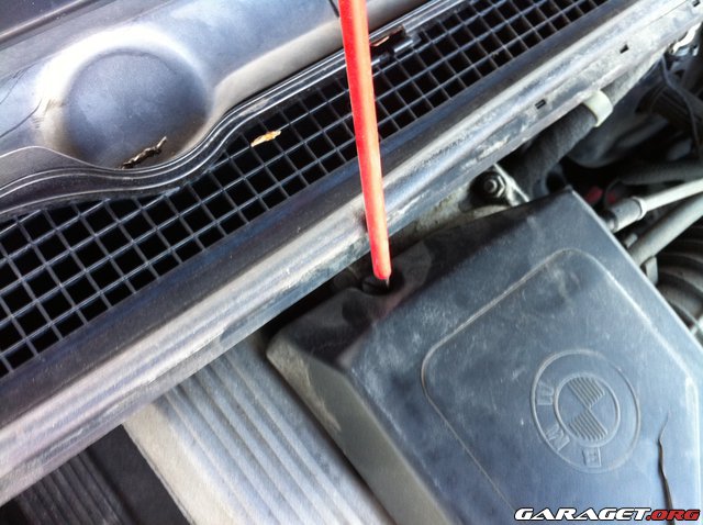

Öppnade motorhuven, här är 5 skruvar som håller fast platskåpan som är ivägen för avmontering.
https://www1.garaget.org/gallery/images/158/157943/157943-029a5e0a20a08d15b25d50598e219abc.jpg
Bara att skruva av.
https://www1.garaget.org/gallery/images/158/157943/157943-6771a13031092ba5979c3f0a5a288adb.jpg
Där var den av, lite lättare att komma åt nu.

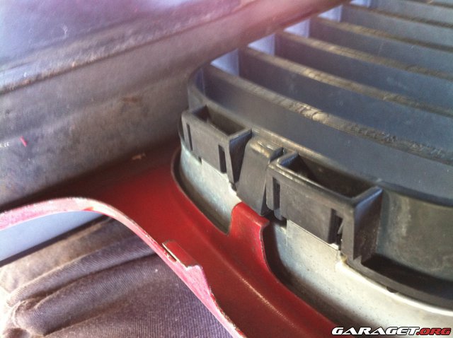

https://www1.garaget.org/gallery/images/158/157943/157943-50c1f378ac81aaf6aeb3c02003c065c0.jpg
Själva grillen sitter fast såhär med splines, bara att trycka in dem en i taget och flytta ut grillen.
https://www1.garaget.org/gallery/images/158/157943/157943-f0a87df35beaa70ea7251d3b4f461ae7.jpg
En av två av.
https://www1.garaget.org/gallery/images/158/157943/157943-f2381c5841cfadf5421c5200d1781e39.jpg
Sen var det bara att upprepa proceduren på andra grillen.
https://www1.garaget.org/gallery/images/158/157943/157943-6469761e2d8fe2011e56691c8d00dc1d.jpg
Ner bland lite avfettning och vatten.

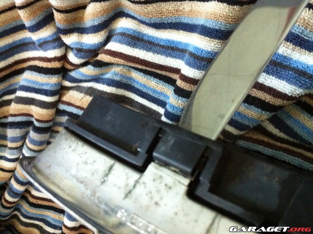

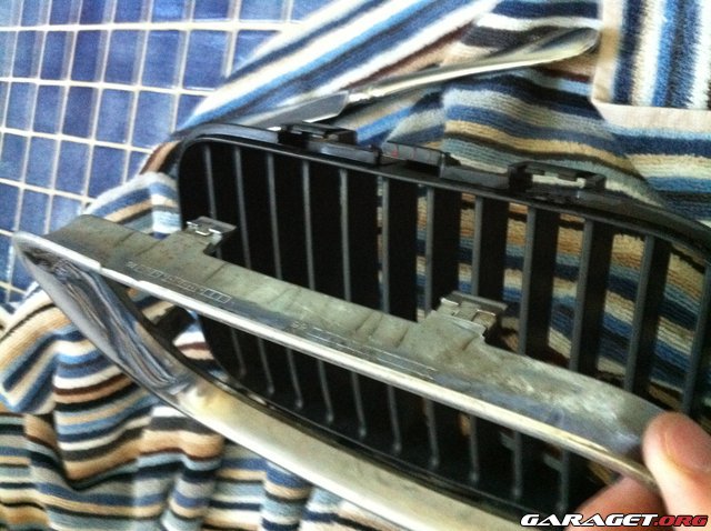

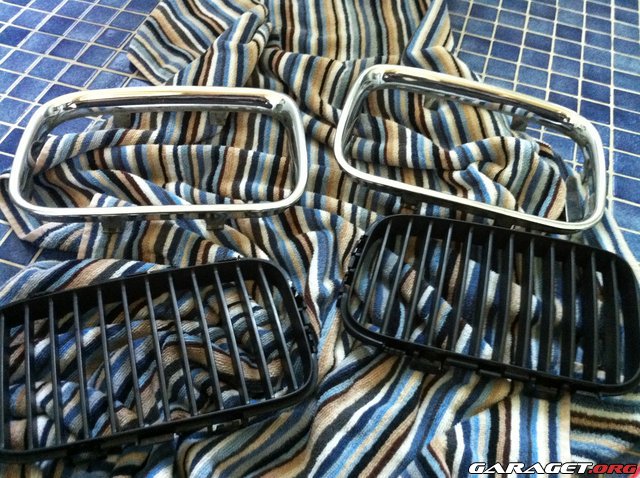

https://www1.garaget.org/gallery/images/158/157943/157943-a3b4d6ff34700541e04bf7ee5d6348eb.jpg
Sitter liknande splines på grillen och den kromade platsen.
https://www1.garaget.org/gallery/images/158/157943/157943-2b61312dce6136ab68a97fb34db920e4.jpg
Använde precis samma arbetsmetod.
https://www1.garaget.org/gallery/images/158/157943/157943-6215547cbb3697a9daffbfde7d7c816b.jpg
And they are off!
Nästa update kommer bilder ifrån blästringen/slipningen.
Over and out, Team "JA36"

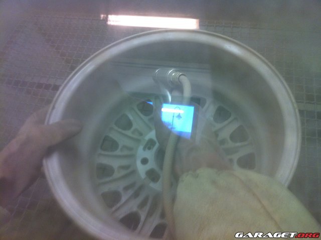

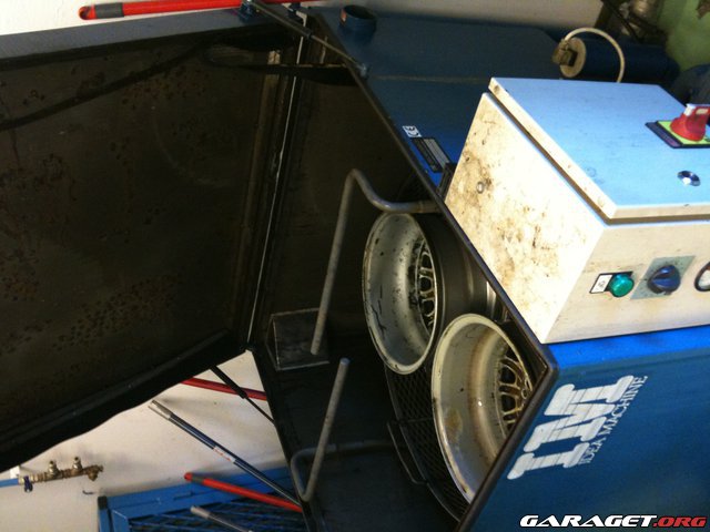

Igår fortsatta arbetet med njurarna/grillen. Plastfolien på dem hade lossnat på flera ställen så vi valde att få av folien innan lackering. Lättaste och simplaste metoden borde vara blästring och därefter slipning.
Så vi valde att göra ett försök i blästern.

https://www1.garaget.org/gallery/images/158/157943/157943-7dc6b585cc69e8a45953aa719f94ec7f.jpg
Njurarna redo för blästring.
https://www1.garaget.org/gallery/images/158/157943/157943-db0027f74c54fd8e36de87ae7930cccc.jpg
Blästring påbörjad
https://www1.garaget.org/gallery/images/158/157943/157943-4980960628f6648836a6ecf2e403f4ac.jpg
Som ni ser så lossnar platsfolien, men fan vad den satt.
https://www1.garaget.org/gallery/images/158/157943/157943-81607989c5320a0072c8933817d3a781.jpg
Henrik i Team "JA36" blästrar
