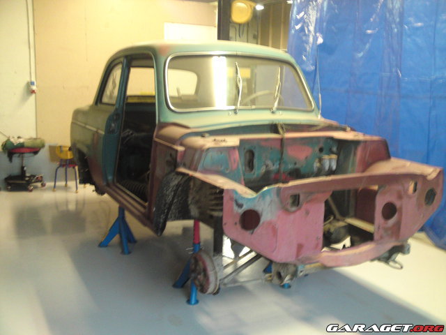

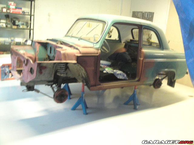

När motor å låda var ur så ställdes bilen upp på pallbockar för sk. strippning .....big_smile

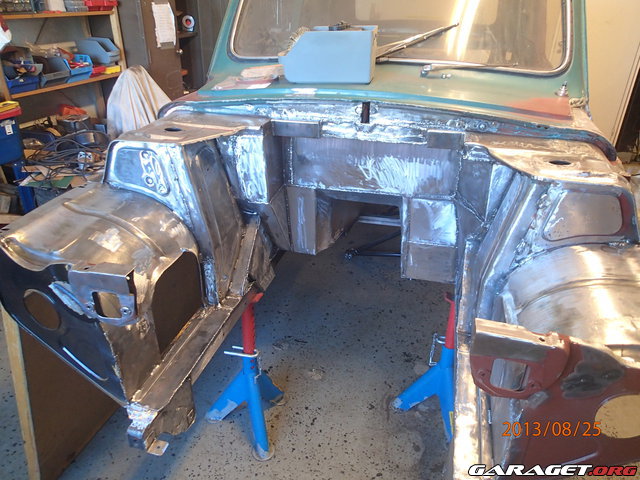

Torped väggen kapades upp i omgångar ....hålet blev större å större lolbig_smile
https://www1.garaget.org/gallery/images/146/145980/145980-9afbd4e4ceba8ca1572fdae1d0495cf7_tn.jpg https://www1.garaget.org/gallery/images/146/145980/145980-e0a47a427d136714dd145a84a0db4626_tn.jpg https://www1.garaget.org/gallery/images/146/145980/145980-451e89ff9a485f67d2e1476dd9bad579_tn.jpg https://www1.garaget.org/gallery/images/146/145980/145980-abef1c4f3d81792a018a335e58e56463_tn.jpg

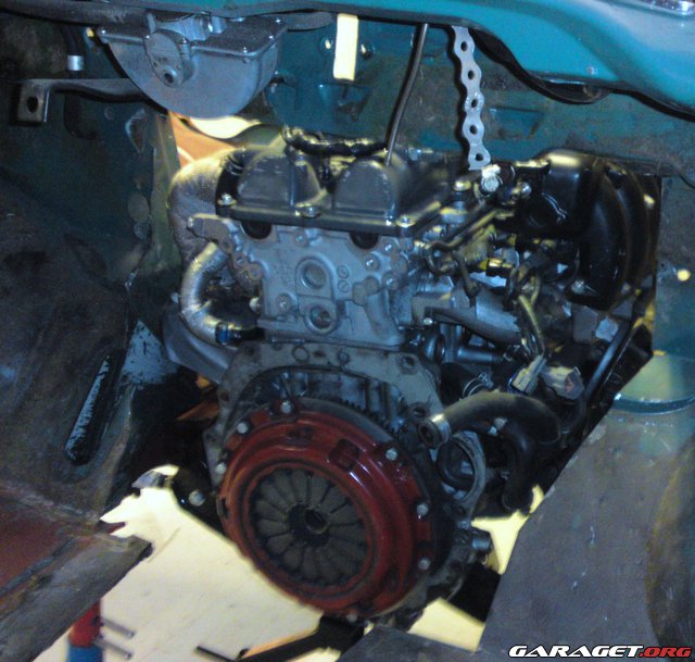

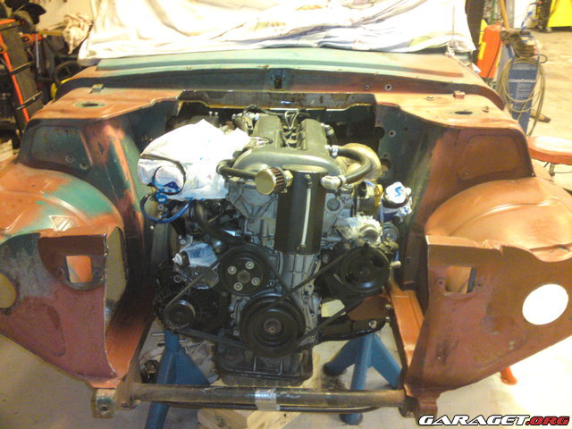

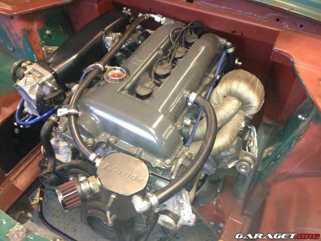

Så var det dags att prova "the real deal" ....big_smile
https://www1.garaget.org/gallery/images/146/145980/145980-b31bef1e9e0625404dc7e91aab3bb01f.jpg
Verkade som om den kände sig hemma där ....lol
https://www1.garaget.org/gallery/images/146/145980/145980-43ea8eb8b65bb0299065871789bb22ed.jpg
https://www1.garaget.org/gallery/images/146/145980/145980-9a7f541f0d3f5f38bc5c3c2486ba0d8f.jpg

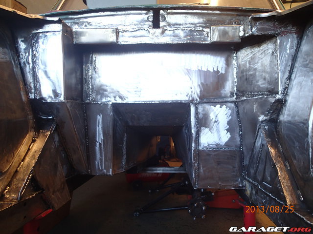

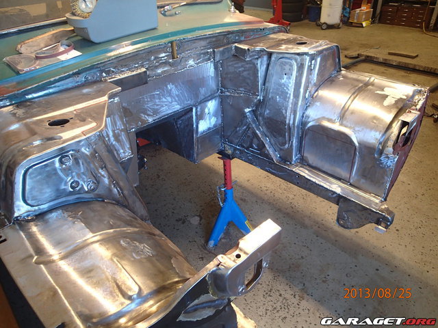

Efter det så var det dags att bygga torpedvägg och vxl låds tunnel .....
https://www1.garaget.org/gallery/images/146/145980/145980-19052e09a5390d788b56eeb31588c441_tn.jpg https://www1.garaget.org/gallery/images/146/145980/145980-3c7e95b1d3ca51bf2533302e88b6aa05_tn.jpg
Samma sak igen....först mallar big_smile
https://www1.garaget.org/gallery/images/146/145980/145980-49d1fd30af0bb49ad8f458bdf033ff39_tn.jpg https://www1.garaget.org/gallery/images/146/145980/145980-feed7e620d292dbb9cfa0c5adccce7a1_tn.jpg https://www1.garaget.org/gallery/images/146/145980/145980-8b4b936f68616f8c76c061053bf74e34_tn.jpg https://www1.garaget.org/gallery/images/146/145980/145980-e2ab98bdf68017ba889de9a7ec6c8a90_tn.jpg https://www1.garaget.org/gallery/images/146/145980/145980-4fc98d07250b30ed9f8f9f054264026b_tn.jpg https://www1.garaget.org/gallery/images/146/145980/145980-cd273b345d435f3138e9c76ab1f0b8e7_tn.jpg https://www1.garaget.org/gallery/images/146/145980/145980-cd1b8e3120ad20f8e32136cc84a6d9f0_tn.jpg
Sen "på riktigt" ....hmm
Man kan väl säga att ALLT flyttades ca 15 cm bakåt ....roll
