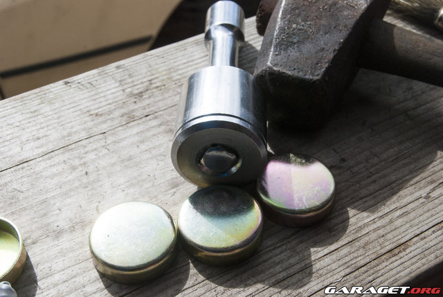

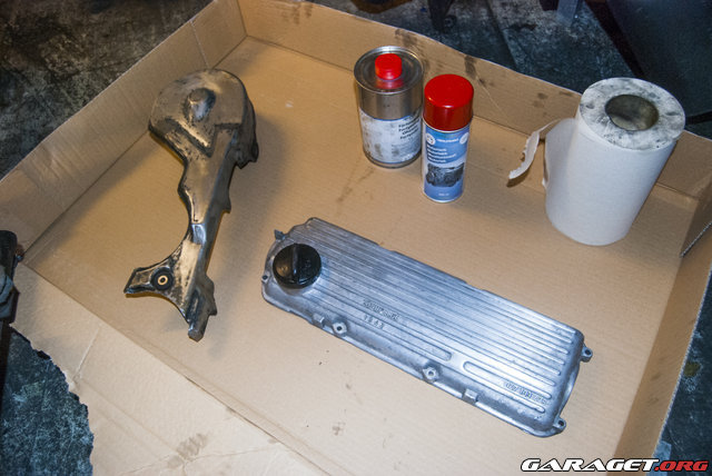

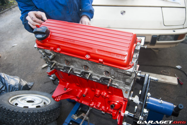

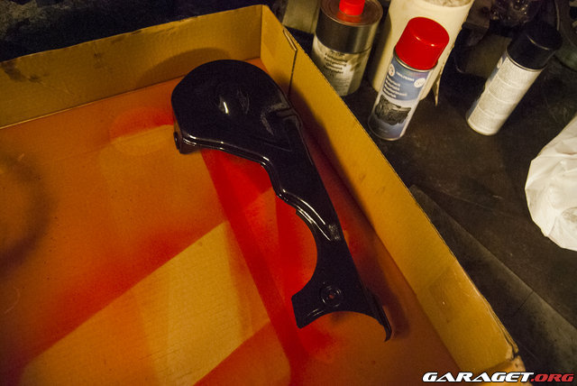

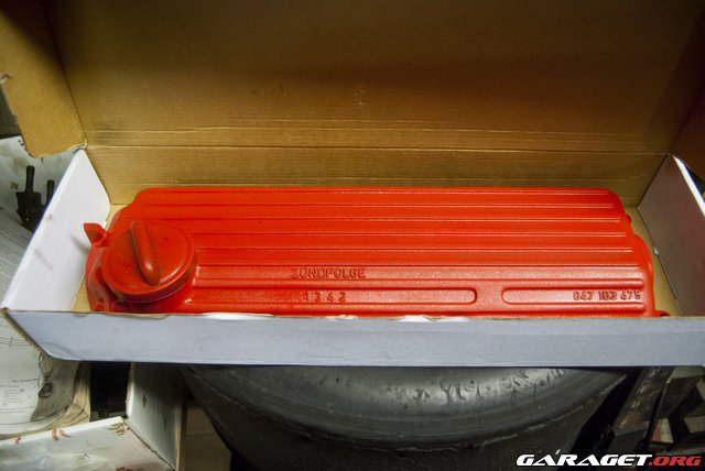

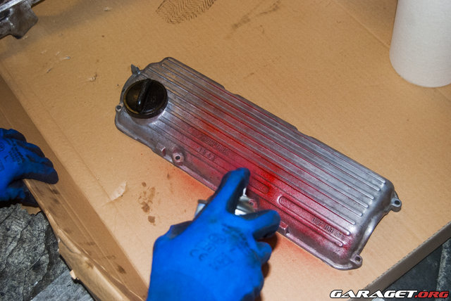

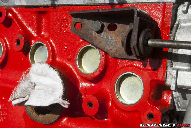

[UPDATE]

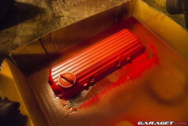

Liten update. Vi har beställt 8st nya lyftare + en ny 280° kamaxel! smile Och det blev 40% billigare än vad 8st nya original-lyftare skulle kosta!

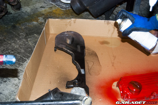

Sen gjorde vi en liten kul grej bara. Målade kamremskåpan och ventilkåpan roll
https://www1.garaget.org/gallery/images/199/198400/198400-cb43bc4429ecd95738e776182e55931f.jpg
https://www1.garaget.org/gallery/images/199/198400/198400-4dc56a4623de0b329032fa1200dbd31a.jpg
https://www1.garaget.org/gallery/images/199/198400/198400-85cb88929689e6e154f702ec08f37cce.jpg
https://www1.garaget.org/gallery/images/199/198400/198400-e1391c85366489caa7ea2315bfbd9294.jpg
https://www1.garaget.org/gallery/images/199/198400/198400-0e93b3a4a78f46b94f716ec21f21962f.jpg
https://www1.garaget.org/gallery/images/199/198400/198400-05c8c5085744600d07990fcb097a3496.jpg

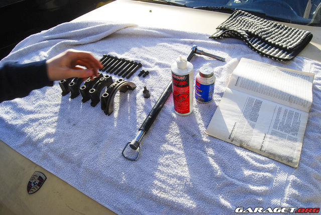

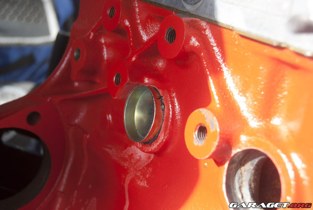

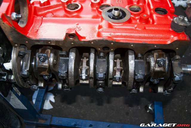

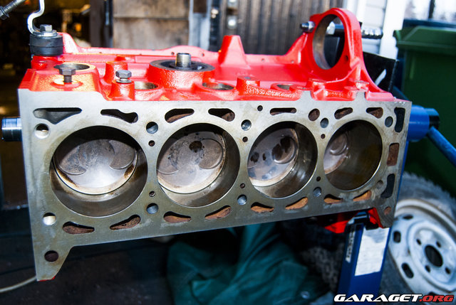

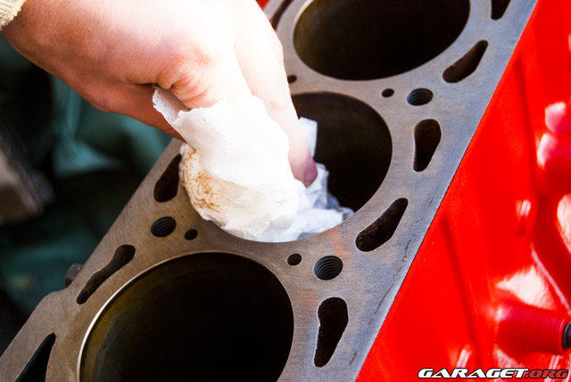

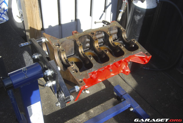

[UPDATE]

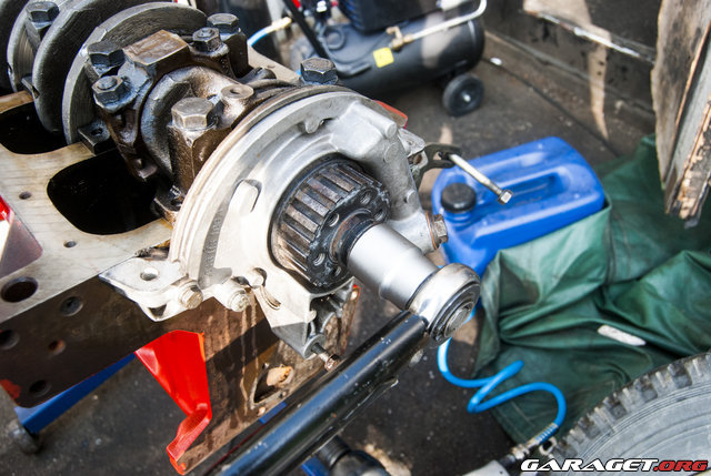

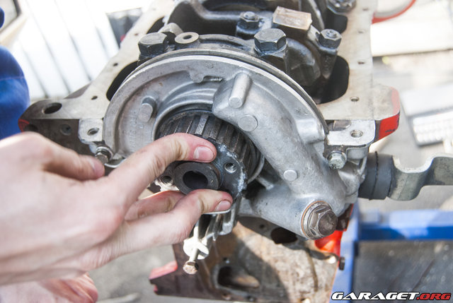

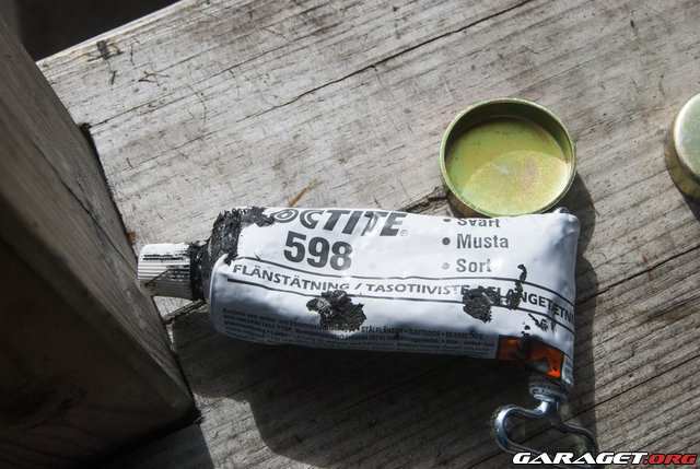

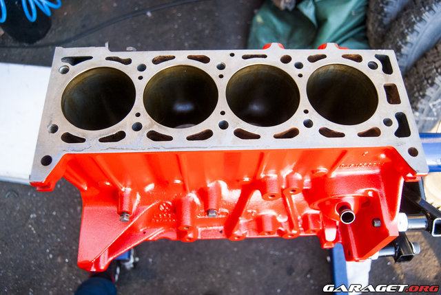

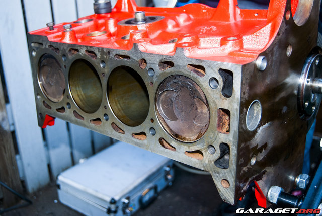

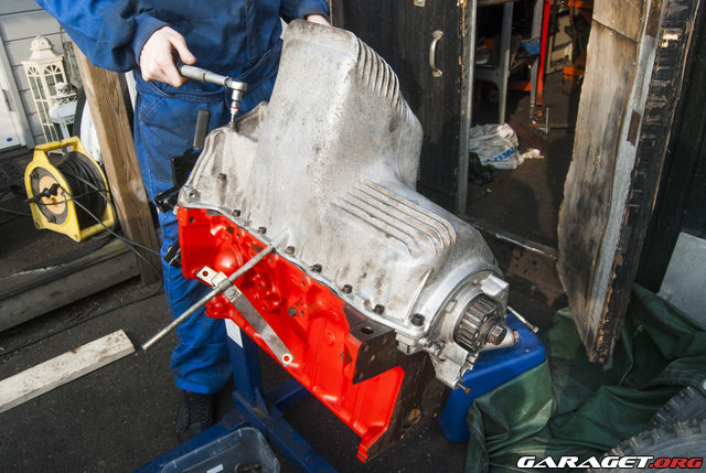

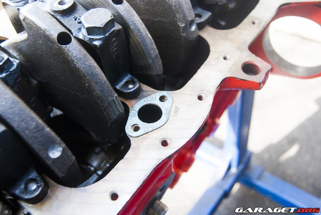

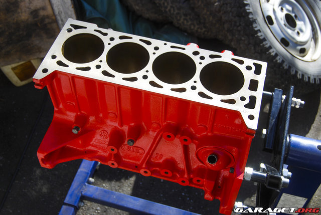

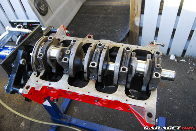

Då fortsätter vi med att montera färdigt blocket smile
https://www1.garaget.org/gallery/images/199/198400/198400-dcc16f4a402f8083ffc3dc1ebad2afad.jpg
https://www1.garaget.org/gallery/images/199/198400/198400-65afb2019caa81d4e9ca10a11ef83ae6.jpg
https://www1.garaget.org/gallery/images/199/198400/198400-c69f84e4fec7f742d5e4803fc18eb11d.jpg
https://www1.garaget.org/gallery/images/199/198400/198400-bd2fc5ef4ba136ace4c7941450f4780c.jpg

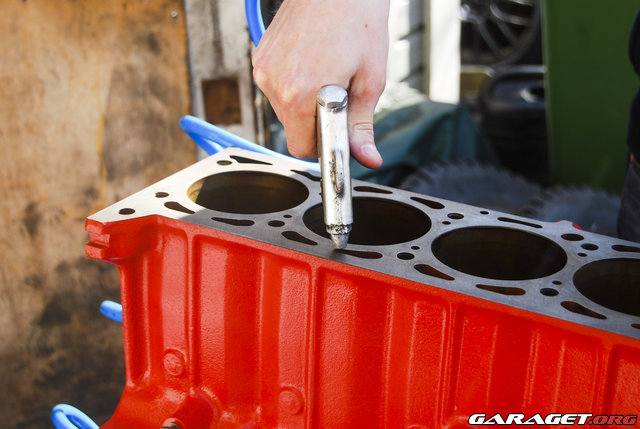

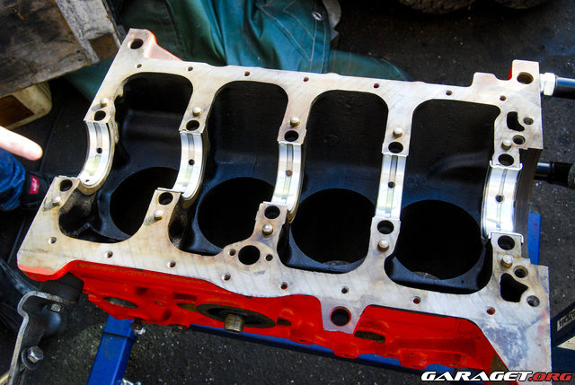

Först så blåser vi rent allting.
https://www1.garaget.org/gallery/images/199/198400/198400-971305d1dc131f3112a1093e6f8c617f.jpg

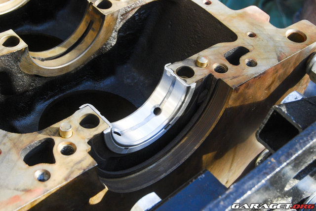

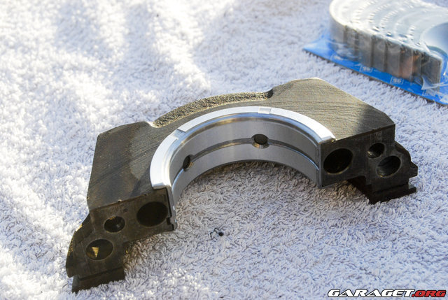

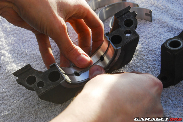

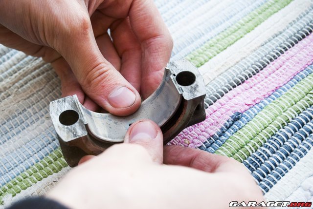

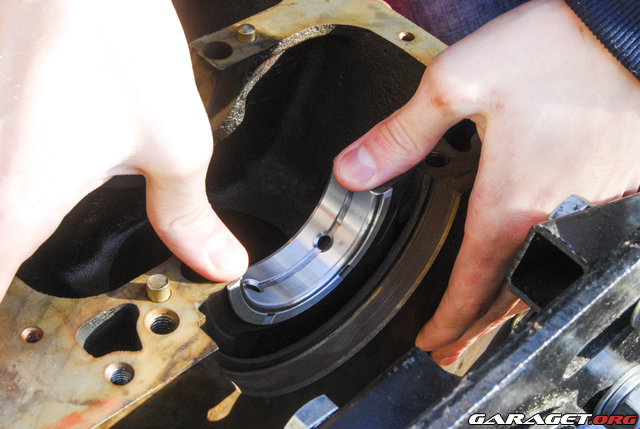

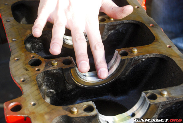

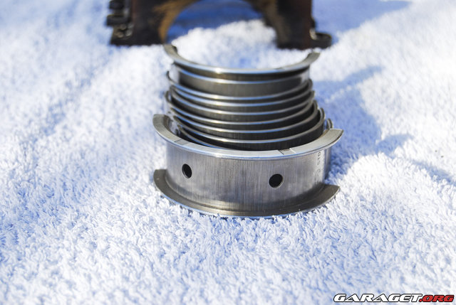

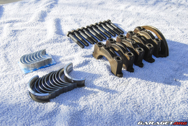

Nya lager smile
https://www1.garaget.org/gallery/images/199/198400/198400-1e7c34fdb5025117726f9c9c72cc8707.jpg
https://www1.garaget.org/gallery/images/199/198400/198400-9ccae2220ee68b89975e3983f4437036.jpg
https://www1.garaget.org/gallery/images/199/198400/198400-5c05d0cd2d857087f37cec87f92735a9.jpg
Trycker dit lagrerna.
https://www1.garaget.org/gallery/images/199/198400/198400-3394fee7e76a486723a6c8d97e78e889.jpg
https://www1.garaget.org/gallery/images/199/198400/198400-42309db84345f0aeb31af02a0995e7fe.jpg
https://www1.garaget.org/gallery/images/199/198400/198400-58b2266bde0fb75941dbd0e63972f500.jpg
Häller på lite olja.
https://www1.garaget.org/gallery/images/199/198400/198400-3a6517d54532773583997673bd2aba90.jpg

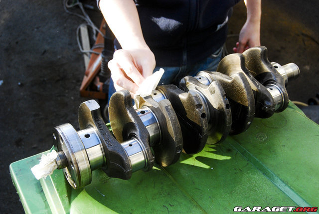

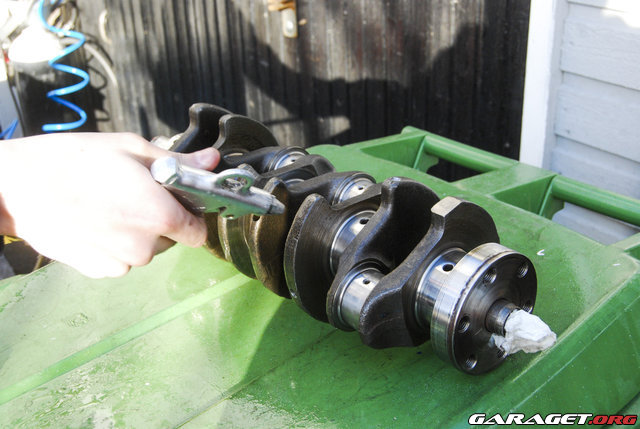

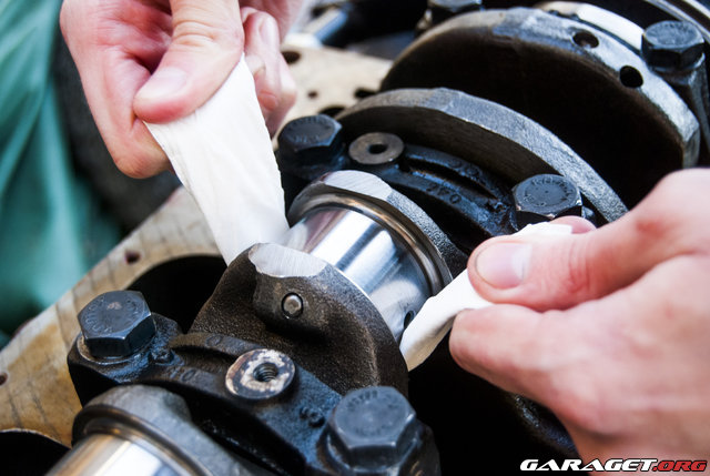

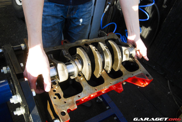

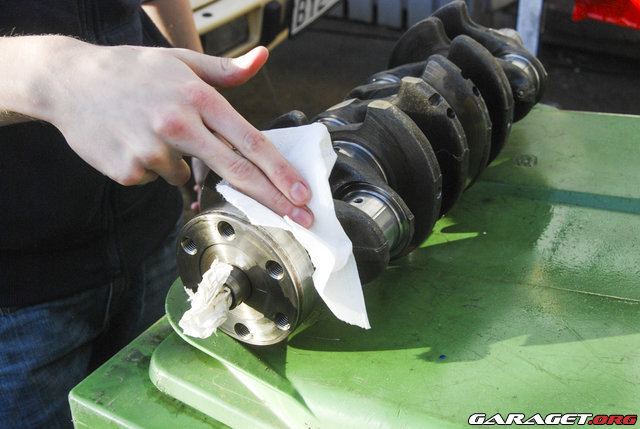

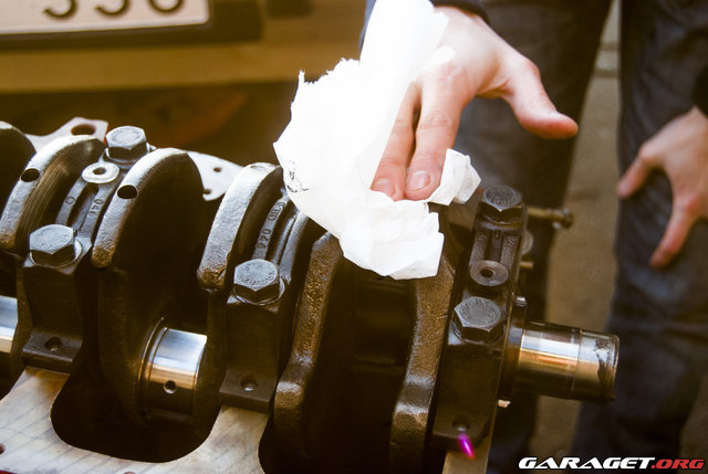

Rengör vevaxeln.
https://www1.garaget.org/gallery/images/199/198400/198400-cdcdc0ca35bc8e25535b4c7d07ae786b.jpg
https://www1.garaget.org/gallery/images/199/198400/198400-3796291e9d0eba8bb8e4d8a7318fe8a8.jpg
https://www1.garaget.org/gallery/images/199/198400/198400-4736048c447231c846e826be2255a4aa.jpg

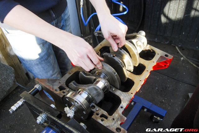

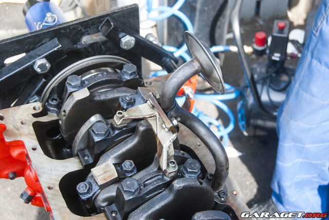

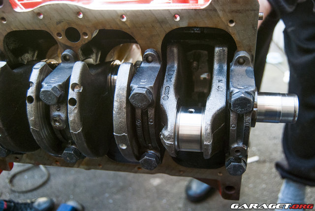

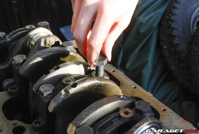

Stoppar in vevaxeln smile
https://www1.garaget.org/gallery/images/199/198400/198400-5e0183ce2f71fbf2779f977d009e2157.jpg
https://www1.garaget.org/gallery/images/199/198400/198400-add0e5bd764f69c907019f105049db4f.jpg

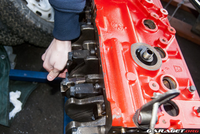

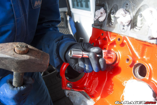

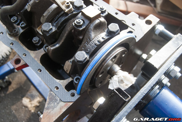

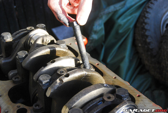

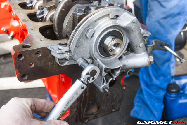

Monterar dit lager i överfallen.
https://www1.garaget.org/gallery/images/199/198400/198400-12fdc459024e620322210bd01b1c74b0.jpg
https://www1.garaget.org/gallery/images/199/198400/198400-030543afb777625faf01ac49f832e3ba.jpg

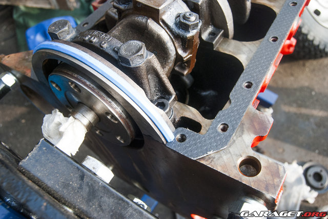

Sätter dit överfallen.
https://www1.garaget.org/gallery/images/199/198400/198400-1579d58dfd2f80f6521a43ff3a3e79c6.jpg
https://www1.garaget.org/gallery/images/199/198400/198400-eeda7e8b089566fc0c082e480380f830.jpg
https://www1.garaget.org/gallery/images/199/198400/198400-9dc460c1be2fb6373e7f9b1a3886b120.jpg
https://www1.garaget.org/gallery/images/199/198400/198400-efa1e935dfb6661493c598ed7c15831d.jpg

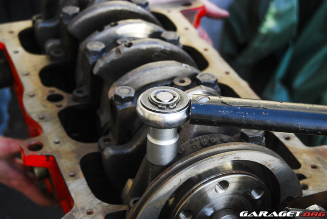

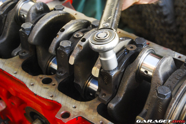

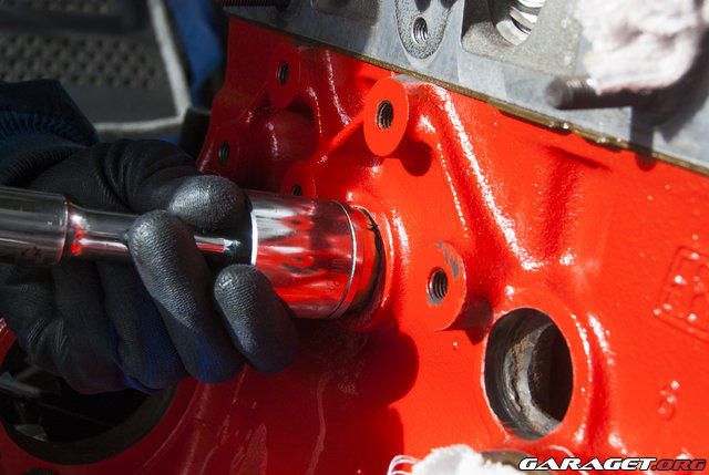

Drar åt allting med momentnyckel.
https://www1.garaget.org/gallery/images/199/198400/198400-cc5e05855a742d25deee55876ef60186.jpg
https://www1.garaget.org/gallery/images/199/198400/198400-7026e8f7ec938a5d32258a7a7f2420b2.jpg

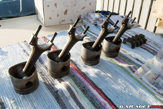

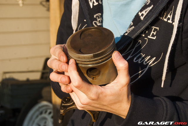

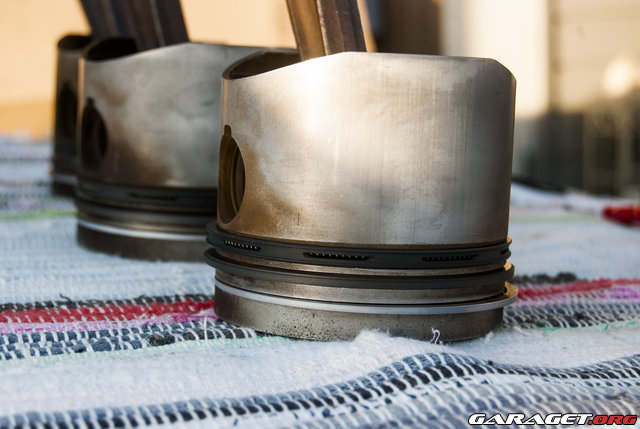

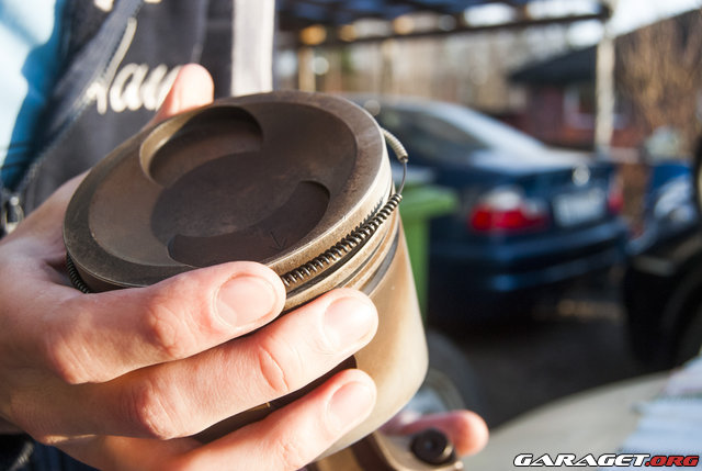

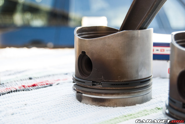

Sen rengör vi kolvarna.
https://www1.garaget.org/gallery/images/199/198400/198400-dfbdace5a24c36e8f61f7c00f4a7ca87.jpg
https://www1.garaget.org/gallery/images/199/198400/198400-9dae1d1a4451b60c2e8c40db764688db.jpg
https://www1.garaget.org/gallery/images/199/198400/198400-c081f89dda0df49e3b1925ce6b57d7ce.jpg
https://www1.garaget.org/gallery/images/199/198400/198400-79e83e8546f603de43c8e6221c45e175.jpg
https://www1.garaget.org/gallery/images/199/198400/198400-88743da779b6ec2dd3fc9bdf7a921e28.jpg

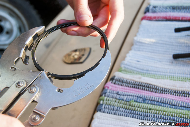

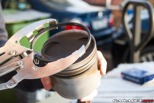

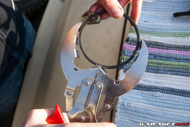

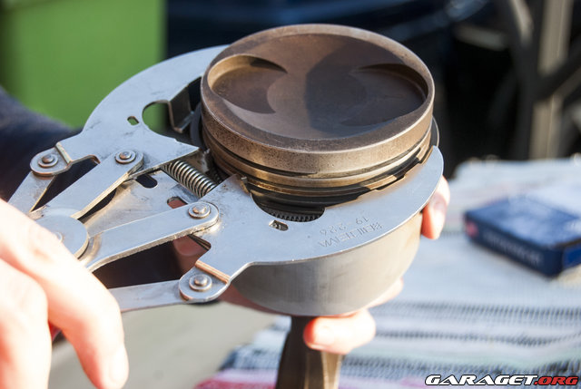

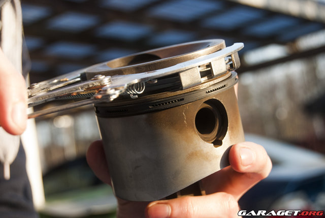

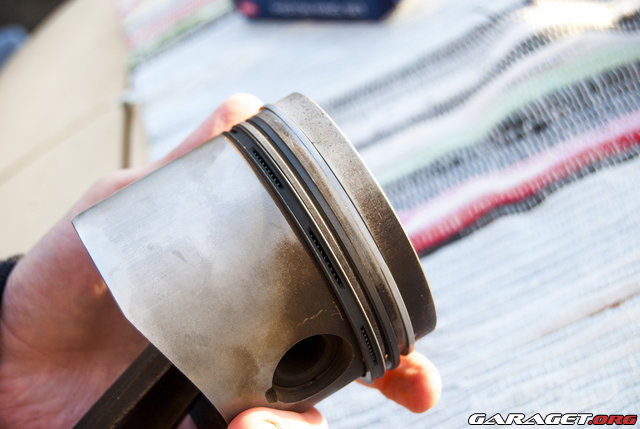

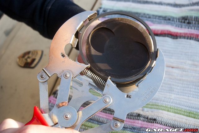

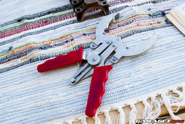

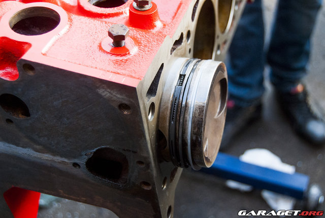

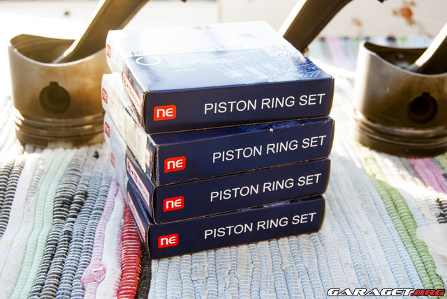

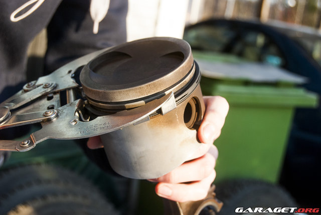

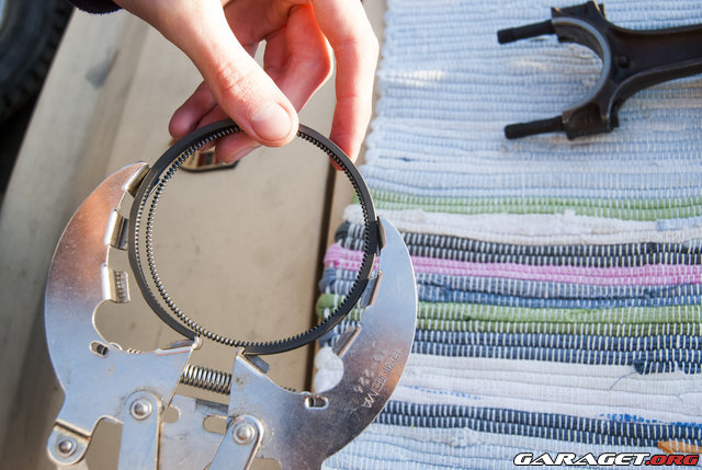

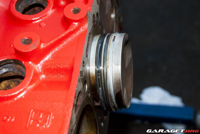

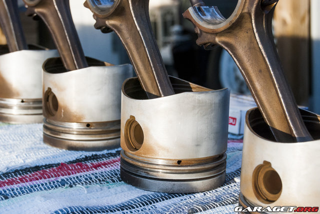

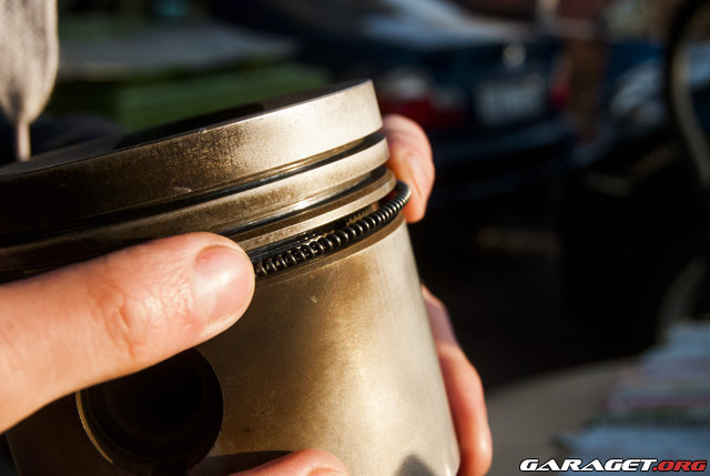

Nya kolvringar.
https://www1.garaget.org/gallery/images/199/198400/198400-c2f12009a478d92bf22b1ef24e7b4b43.jpg
https://www1.garaget.org/gallery/images/199/198400/198400-6fc7adf0579fd88ef658187b3c6811c7.jpg

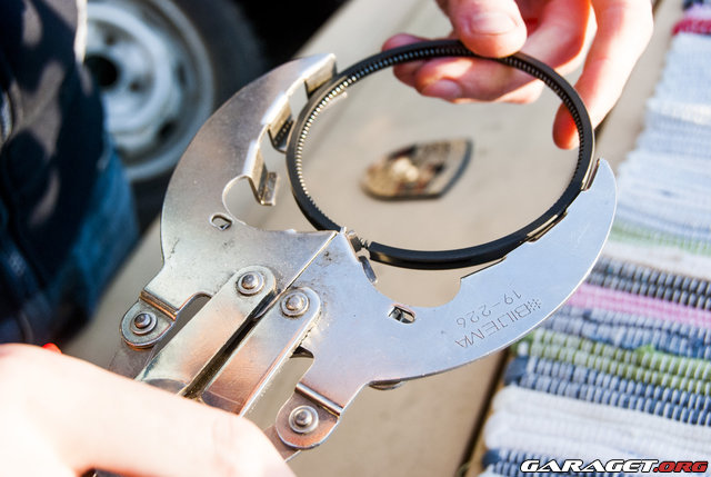

Kolvringsverktyg.
https://www1.garaget.org/gallery/images/199/198400/198400-e3c72544e988826d80e553967289c652.jpg
Filar lite på de skarpa kanterna.
https://www1.garaget.org/gallery/images/199/198400/198400-a6e7e7f27bfd4d487e45d5425625e1c8.jpg
Nu monterar vi kolvringarna smile
https://www1.garaget.org/gallery/images/199/198400/198400-d0bf0fc9fceb89905403cc21f6a91ff1.jpg
https://www1.garaget.org/gallery/images/199/198400/198400-fd2f89ff804700dd20ca2315ee348c58.jpg
https://www1.garaget.org/gallery/images/199/198400/198400-f2a666e095606b9a9bf903eac4994074.jpg
https://www1.garaget.org/gallery/images/199/198400/198400-40f167baf9568668bec8ecf57535dbfd.jpg
https://www1.garaget.org/gallery/images/199/198400/198400-3707e0c6687610693b34d14777dd791a.jpg
https://www1.garaget.org/gallery/images/199/198400/198400-d18a318c991833da32758cd902c7c6e5.jpg
https://www1.garaget.org/gallery/images/199/198400/198400-f465ba2a69f5578ea4bbd22265a2d51c.jpg
https://www1.garaget.org/gallery/images/199/198400/198400-d595dee38e55a428959e2e9484f7b449.jpg
https://www1.garaget.org/gallery/images/199/198400/198400-b28cc5af5a4e5e71fefc72a3506d2d0f.jpg
https://www1.garaget.org/gallery/images/199/198400/198400-397deec9c05e19fb077995313eea9b02.jpg
https://www1.garaget.org/gallery/images/199/198400/198400-37341e8ea807a17ced30459f3cf409ff.jpg
https://www1.garaget.org/gallery/images/199/198400/198400-ee7af8acbb1c5887e34d43d06df22d7c.jpg
https://www1.garaget.org/gallery/images/199/198400/198400-90ecd73ab84414c6f6b732cc4be71c2f.jpg
https://www1.garaget.org/gallery/images/199/198400/198400-ebcb7a6561511a17d72d398b3b76d222.jpg
https://www1.garaget.org/gallery/images/199/198400/198400-50d282cdbb550771c005c50e0427e918.jpg

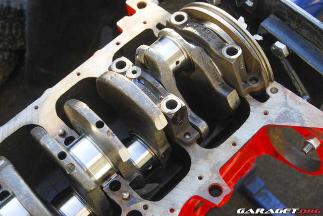

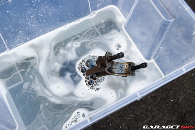

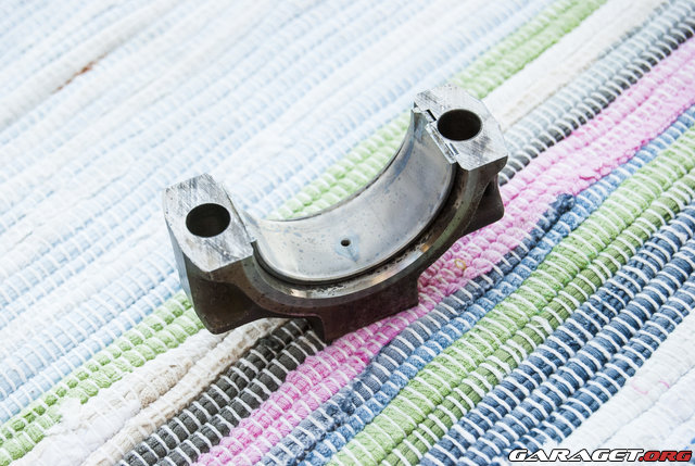

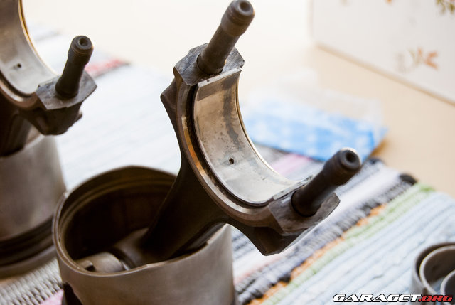

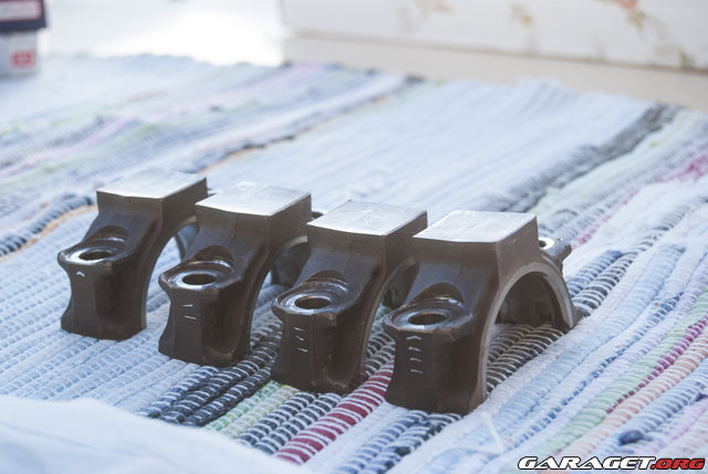

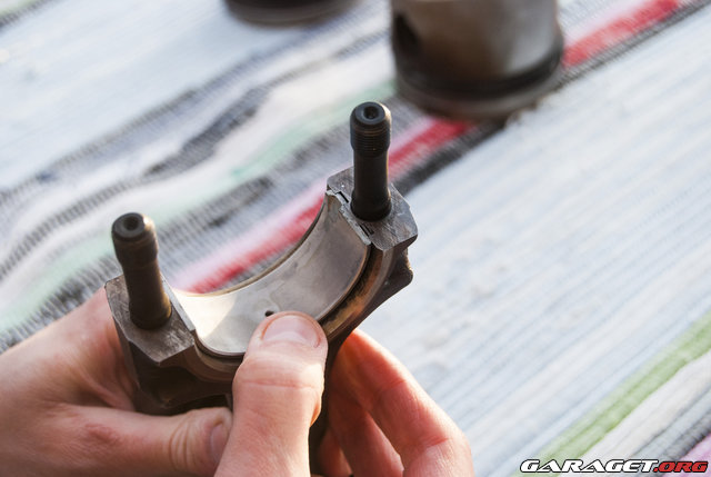

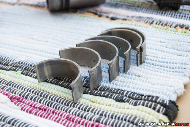

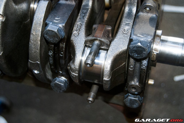

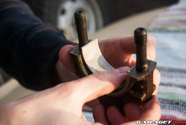

Nya vevlager.
https://www1.garaget.org/gallery/images/199/198400/198400-91cdd2b7b112bb0fb1fa6da5cbe673ba.jpg
https://www1.garaget.org/gallery/images/199/198400/198400-9b915cd749045825958606f23b229657.jpg
https://www1.garaget.org/gallery/images/199/198400/198400-0a6505eb4f1f9b72c0b351da5f689ff7.jpg
https://www1.garaget.org/gallery/images/199/198400/198400-4996134a4b20e931a13dcfee637e9672.jpg
https://www1.garaget.org/gallery/images/199/198400/198400-56342b4f80c537c232817de836ffe183.jpg
https://www1.garaget.org/gallery/images/199/198400/198400-1642ef25e8b6f6eaa0d3261e76179d6e.jpg

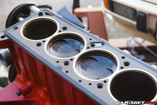

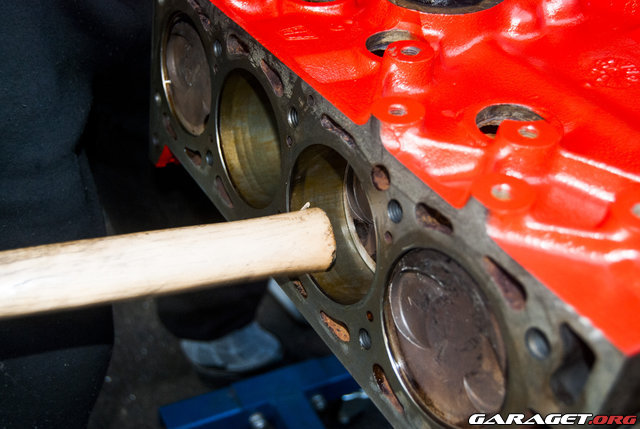

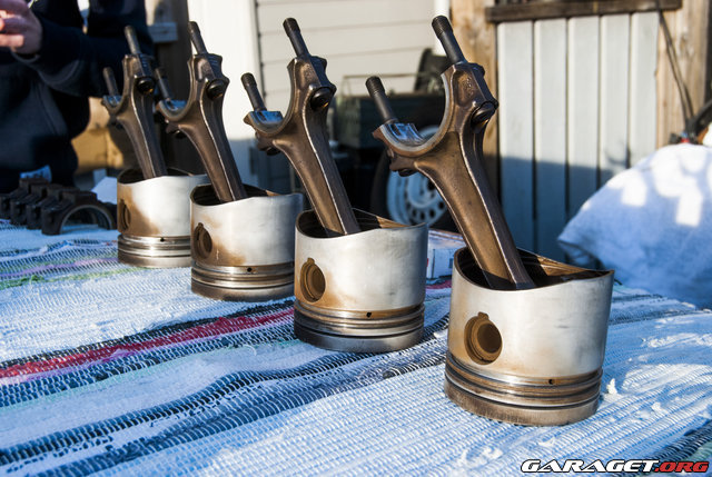

Dags att installera kolvarna.
https://www1.garaget.org/gallery/images/199/198400/198400-155666f547d84284752c3f2f153a77b3.jpg
https://www1.garaget.org/gallery/images/199/198400/198400-c94677b0d593400125030041de431314.jpg
https://www1.garaget.org/gallery/images/199/198400/198400-ac935f4363410bc0dfaa2d60363174be.jpg
https://www1.garaget.org/gallery/images/199/198400/198400-97cd159aa9e6e1a5e55f827361da11e0.jpg

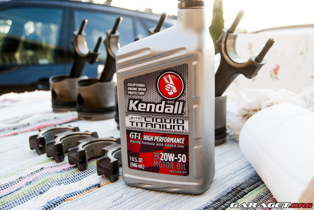

Smörjer med massa olja.
https://www1.garaget.org/gallery/images/199/198400/198400-290dcdd23ede28b204086799d0c51bfc.jpg
https://www1.garaget.org/gallery/images/199/198400/198400-d6500ea7104dfa65283fdddd491eaa1d.jpg
https://www1.garaget.org/gallery/images/199/198400/198400-842e91a15e298471e6e36205c9f324f0.jpg
https://www1.garaget.org/gallery/images/199/198400/198400-b91728a6b8698dda30f154198c537734.jpg
https://www1.garaget.org/gallery/images/199/198400/198400-53b30a9b2a6acd553f03b5cf7d2503a9.jpg
https://www1.garaget.org/gallery/images/199/198400/198400-f0012d00700eaef0bca88033d60bd01c.jpg
https://www1.garaget.org/gallery/images/199/198400/198400-e402a840c111bcc15bc4f0908777de73.jpg
https://www1.garaget.org/gallery/images/199/198400/198400-49462f5771e61d81fdef0ab1ebf9dbef.jpg
https://www1.garaget.org/gallery/images/199/198400/198400-d5443306465658a06a368fcec1082c53.jpg

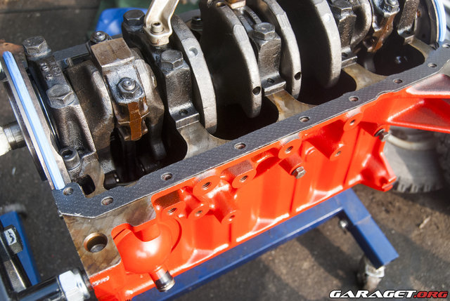

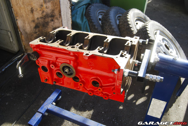

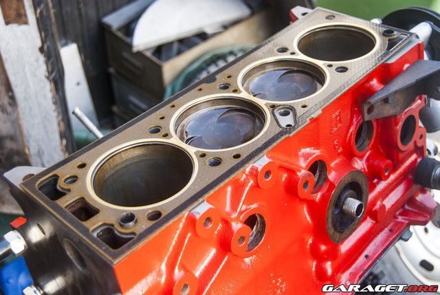

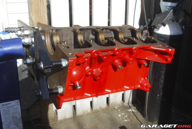

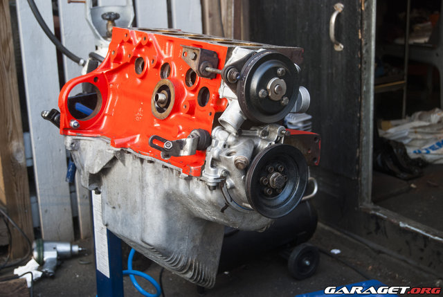

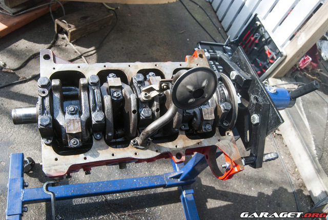

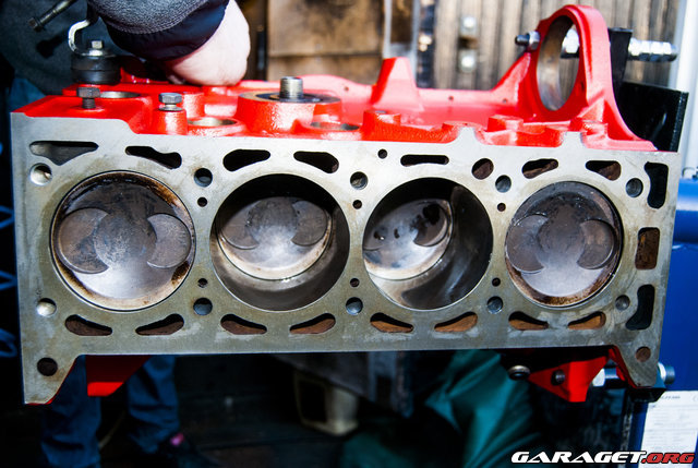

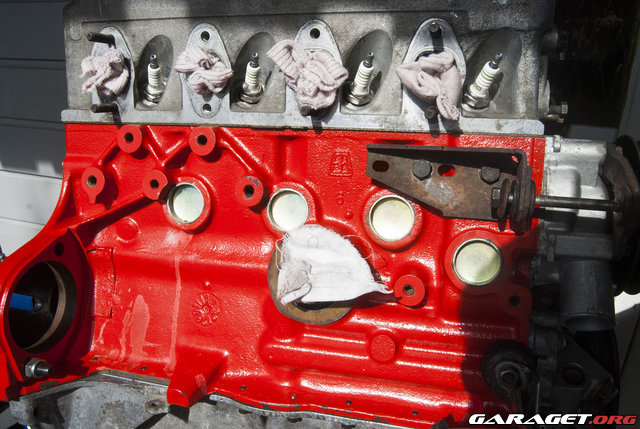

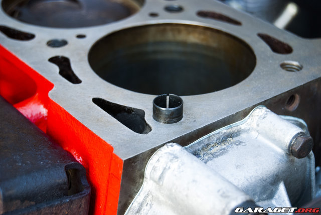

Nu är blocket färdigt smile
https://www1.garaget.org/gallery/images/199/198400/198400-768ea30cbbfa4d1ce127b7c11f10e135.jpg
https://www1.garaget.org/gallery/images/199/198400/198400-6cc22786fb7943e9ecddaad95f2294a3.jpg

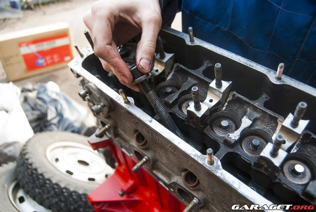

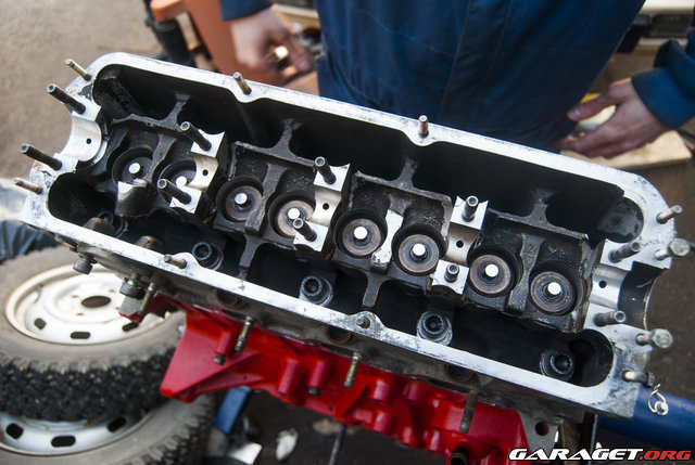

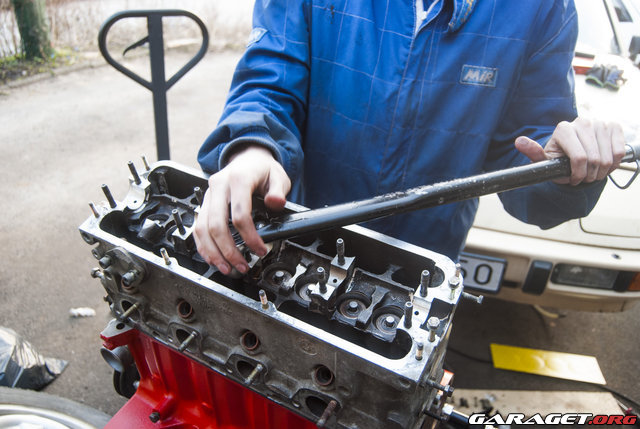

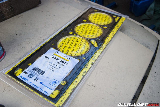

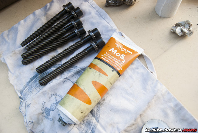

UPDATE
Det har vart lite uppehåll men nu är vi gång igen!

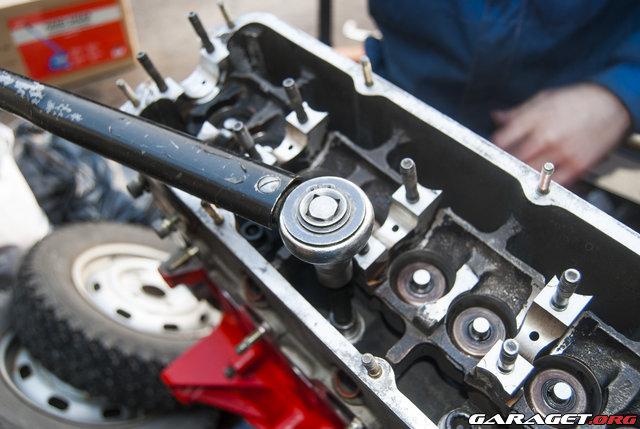

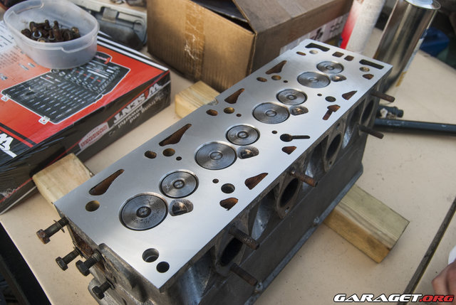

Dags att montera på toppen.
https://www1.garaget.org/gallery/images/199/198400/198400-952c68e8c142ab61147386d3cddacb1c.jpg
https://www1.garaget.org/gallery/images/199/198400/198400-78e7fe4d424f3e43c311f40443087ebb.jpg
https://www1.garaget.org/gallery/images/199/198400/198400-5a9c44a3ffbc635b3bf5014721e65f2b.jpg
Oljepump på.
https://www1.garaget.org/gallery/images/199/198400/198400-ec2f1d32baec001b0a9252e76be66cbf.jpg
https://www1.garaget.org/gallery/images/199/198400/198400-ba615d61f97a8ad729171f3c645f0faa.jpg
https://www1.garaget.org/gallery/images/199/198400/198400-8af11e9bce9b589c03f2a61f7ff1e551.jpg
Montera oljetråget.
https://www1.garaget.org/gallery/images/199/198400/198400-f73fd1c4e93892b3cf11cd35f020e73c.jpg
https://www1.garaget.org/gallery/images/199/198400/198400-1dad0d571895c1b42513ae0b6cac277e.jpg
https://www1.garaget.org/gallery/images/199/198400/198400-54c9e2c639cd34b572a3df75db357ea1.jpg
https://www1.garaget.org/gallery/images/199/198400/198400-e6cae51d93b0bdd64a29b83eea9df907.jpg
https://www1.garaget.org/gallery/images/199/198400/198400-ccf2aa316cafe3e892fc41725f2b3c3f.jpg
https://www1.garaget.org/gallery/images/199/198400/198400-4141e73a40ff2e0b05fe0e6596a52bd0.jpg
https://www1.garaget.org/gallery/images/199/198400/198400-5149fa130566fdb1598b16c31e630afb.jpg
https://www1.garaget.org/gallery/images/199/198400/198400-71d31765e28442168651de46330a3728.jpg
https://www1.garaget.org/gallery/images/199/198400/198400-a14dfa5486deb15a822d448bf111db8a.jpg
https://www1.garaget.org/gallery/images/199/198400/198400-82b9e59af561524b1964993a3975e518.jpg
https://www1.garaget.org/gallery/images/199/198400/198400-f2f3ca2e2eac82b81e0a87e2a5eb2b44.jpg
https://www1.garaget.org/gallery/images/199/198400/198400-35668abad549bf40a20bb45f85f75cb8.jpg
https://www1.garaget.org/gallery/images/199/198400/198400-057090422b72ed008c77a54c17694f64.jpg
https://www1.garaget.org/gallery/images/199/198400/198400-e7f1bc289d31ef8b5f9308b144de70b1.jpg
https://www1.garaget.org/gallery/images/199/198400/198400-a69c8ffc8488472e991f7df28ca8753c.jpg
Det börjar ta sig smile
https://www1.garaget.org/gallery/images/199/198400/198400-d1668fb84bf5036c8edcd6a38ab0163e.jpg

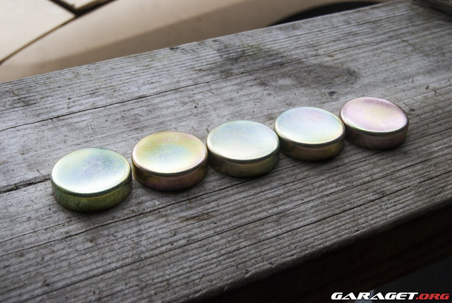

Vi trycker dit fryspluggarna också.
https://www1.garaget.org/gallery/images/199/198400/198400-f31a998584808834aad543ac4fecdef0.jpg
https://www1.garaget.org/gallery/images/199/198400/198400-9607b0eb507de6ca93e14ef84429ae4a.jpg
En bakvänd hylsa blir ett bra verktyg.
https://www1.garaget.org/gallery/images/199/198400/198400-624798a1e7d4ccddef5bfc6d9a67d5ee.jpg
https://www1.garaget.org/gallery/images/199/198400/198400-9b9b5c391dccd13adca2140adb3046e0.jpg
https://www1.garaget.org/gallery/images/199/198400/198400-0c00eae63f68425e218e3b7b692f571f.jpg
https://www1.garaget.org/gallery/images/199/198400/198400-76a09a5b3b664c3b28337010edfa9abc.jpg
https://www1.garaget.org/gallery/images/199/198400/198400-34207515b00655c88bb337176e9d9267.jpg
https://www1.garaget.org/gallery/images/199/198400/198400-aa7f6a3777dbe588633786342699391b.jpg
Kamaxeln är nästa grej som ska monteras.
