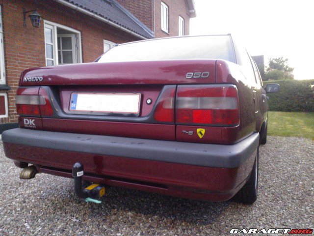

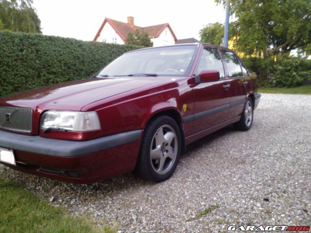

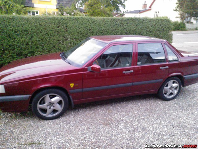

T5éren

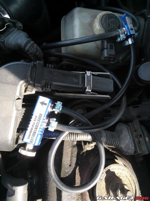

Tester boost controlleren

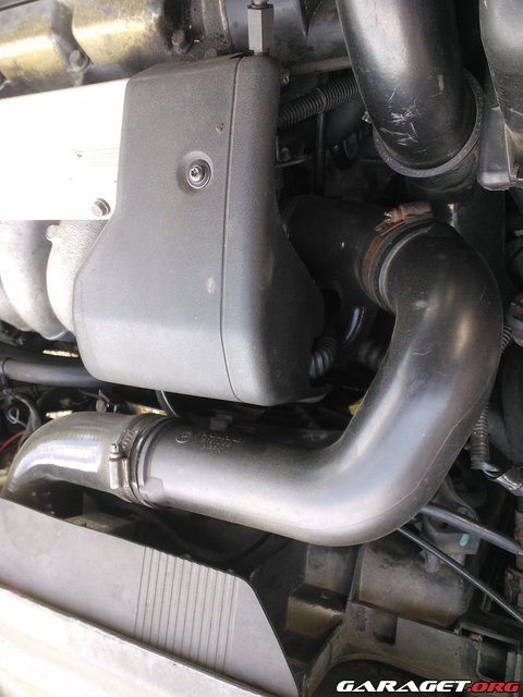

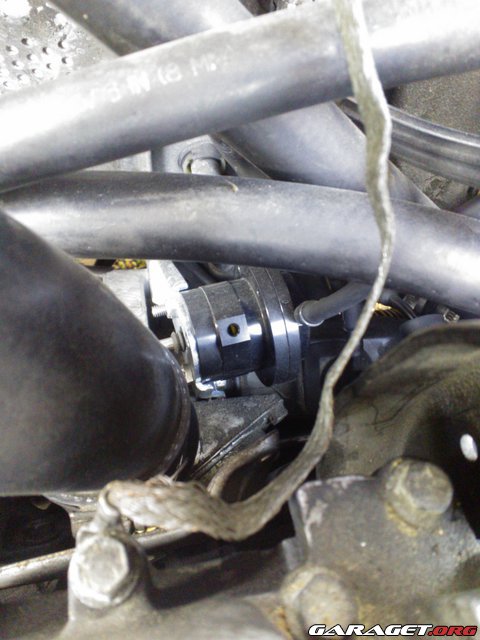

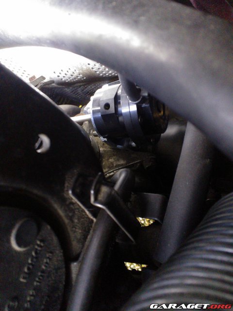

Den nye actuator monteret.
https://www1.garaget.org/gallery/images/165/164881/164881-2588f3116988feb06c77658dc41754b5.jpg
