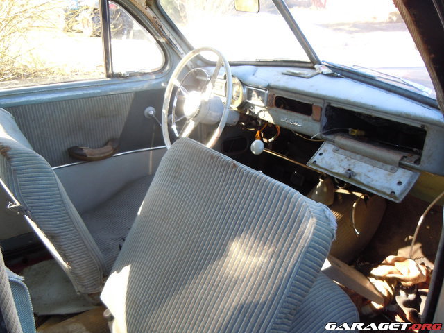

https://www1.garaget.org/gallery/images/218/217463/217463-c28ebe67ea71522f8c9f95068a42ef3d.jpg

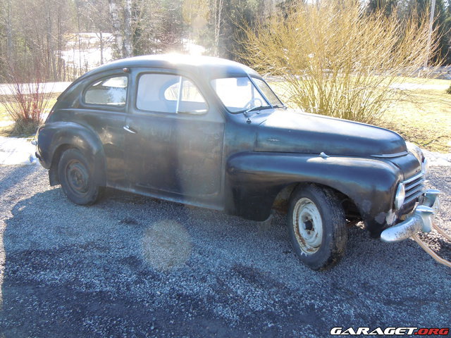

https://www1.garaget.org/gallery/images/218/217463/217463-0fa8eca6ed544d43785a9b6ee316028e.jpg

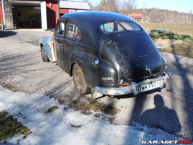

https://www1.garaget.org/gallery/images/218/217463/217463-e46a352c8d7c2942779fc65567eab93d.jpg
