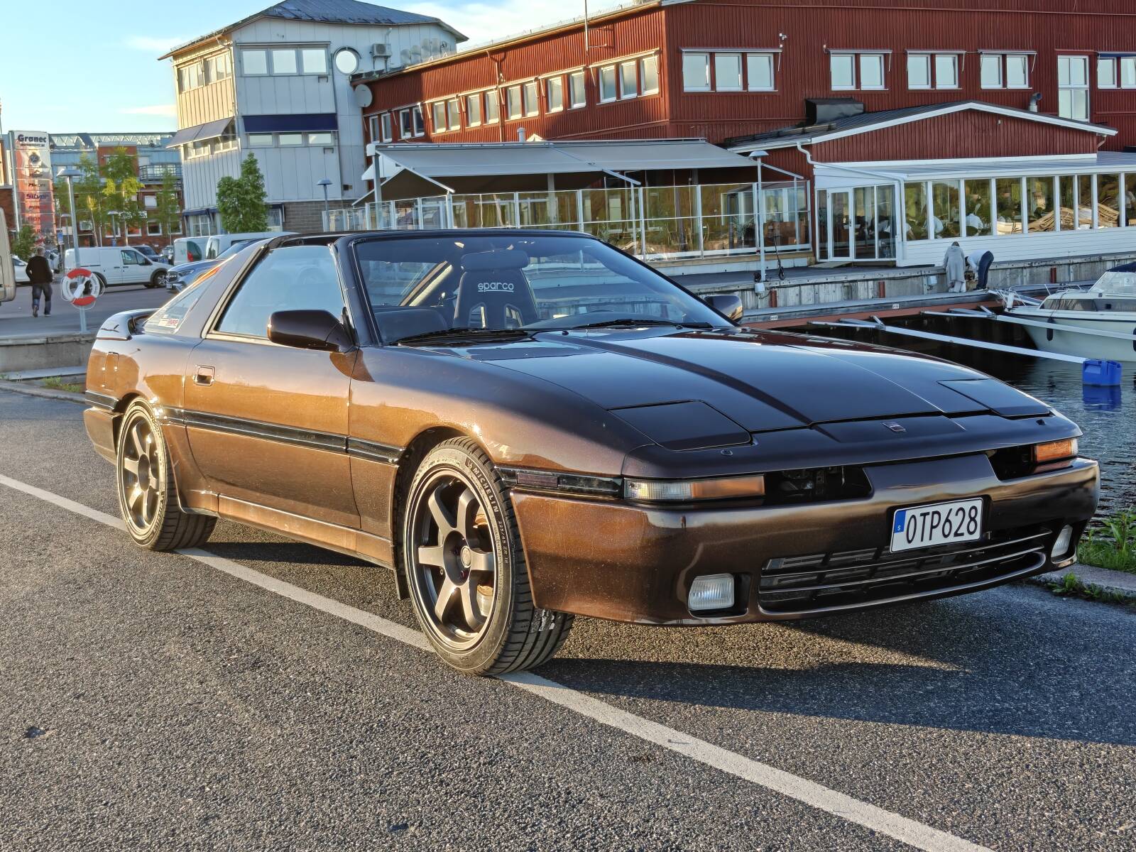

Hjulafton! Bilderna får tala för sig själv.
https://www1.garaget.org/gallery/images/214/213660/213660-48adb9617a74e58bc0ba9678d49fb8e0.jpg
https://www1.garaget.org/gallery/images/214/213660/213660-fa68e08341f005e243746d50d6d4bc7f.jpg

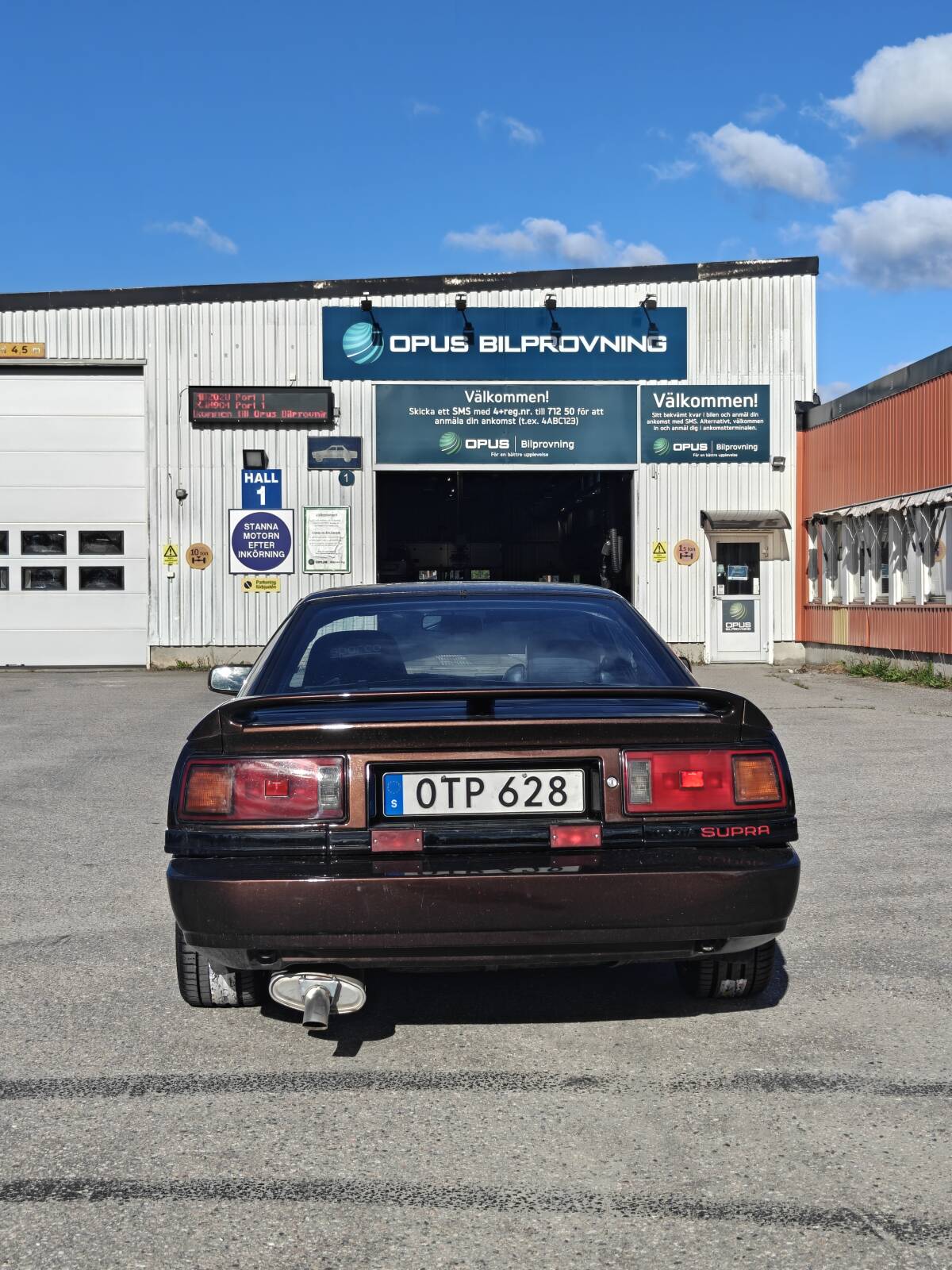

Godkänd!
https://www1.garaget.org/gallery/images/214/213660/213660-66b64d396fe831f4a24bd1cd8251f397.jpg
Teamledare Turbilar på Amring i Kungsängen

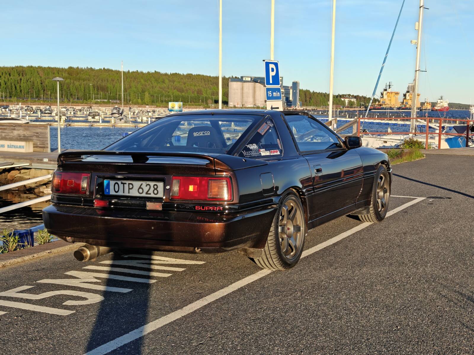

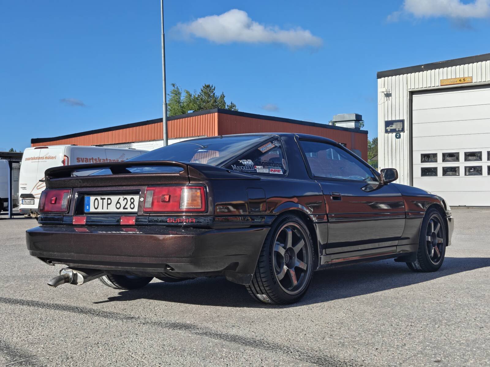

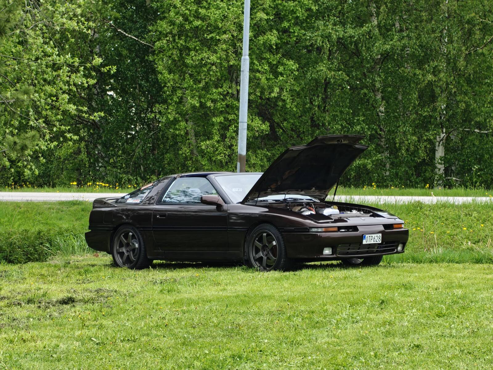

Den gör sig helt klart bättre i utemiljö jämfört med verkstan! https://www1.garaget.org/gallery/images/214/213660/213660-2a9f315a513edd2b9be9d3eb4fd1c6a8.jpg
https://www1.garaget.org/gallery/images/214/213660/213660-9a2fdb05647c1d88a249e7c68e105b12.jpg
https://www1.garaget.org/gallery/images/214/213660/213660-2d436e9a7dcfb1ad1b4345fc0c0b2352.jpg
https://www1.garaget.org/gallery/images/214/213660/213660-6eda87a9c6f2c2cd9a9588213cda52fb.jpg
https://www1.garaget.org/gallery/images/214/213660/213660-fe8cc05d1289cea3549777ea9caa04e1.jpg
