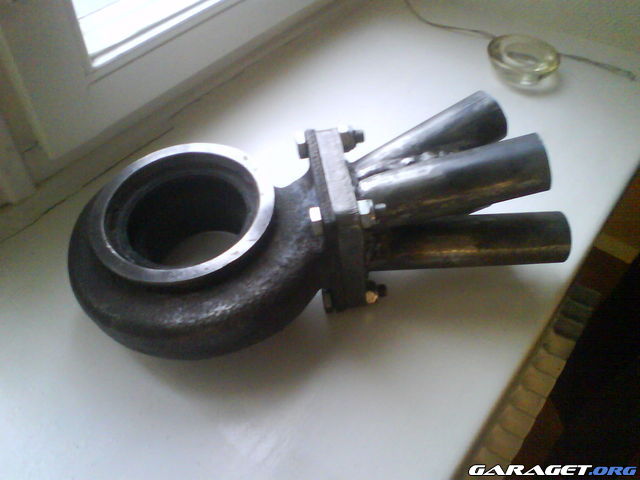

https://www1.garaget.org/gallery/archive/91977/946607_irq7dr.jpg
