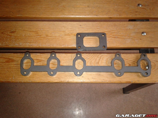

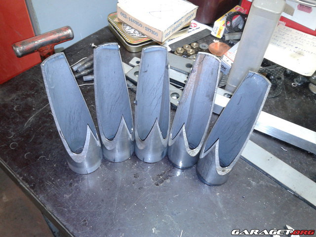

https://www1.garaget.org/gallery/images/123/122684/122684-305d9eb3f2cd3a6c4b7e5ea83cc3ad40.jpg

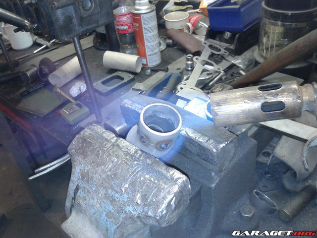

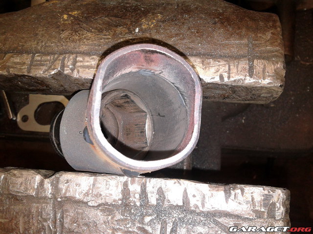

Ritat o skurit ut flänsar på jobbet
Senast redigerat av Eira (11 november 2013)

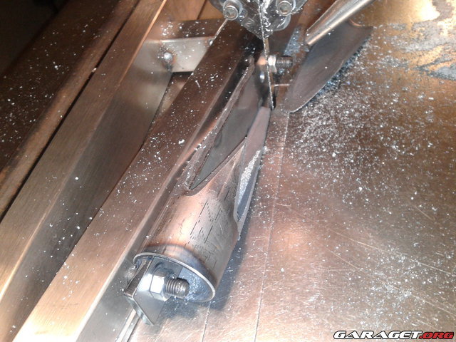

https://www1.garaget.org/gallery/images/123/122684/122684-e16a559b86808223b562df5cea1a541a.jpg

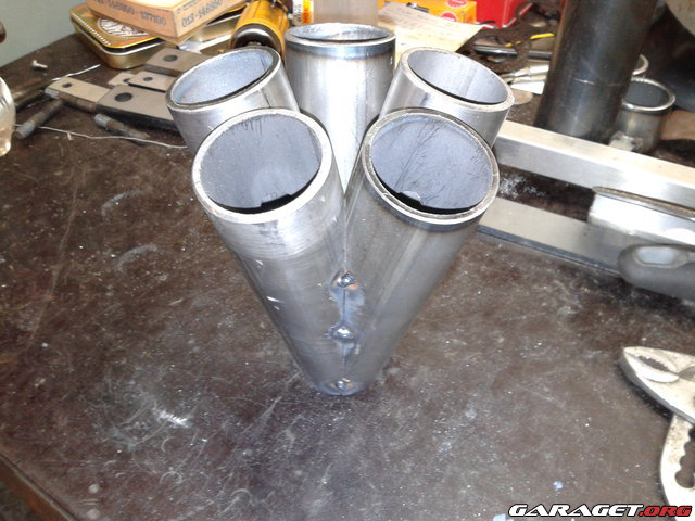

Gjorde en sågjigg till kollektorrören o körde i bandsågen (10 graders lutning)
https://www1.garaget.org/gallery/images/123/122684/122684-70fc98f9127837073f46372a9e69f533.jpg
https://www1.garaget.org/gallery/images/123/122684/122684-6277af8449d82b49f83952546e056e70.jpg
Punktat ihop kollektorn

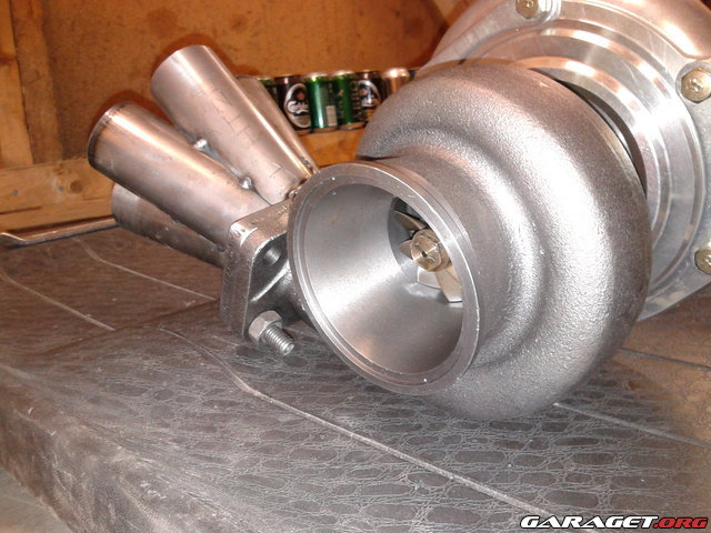

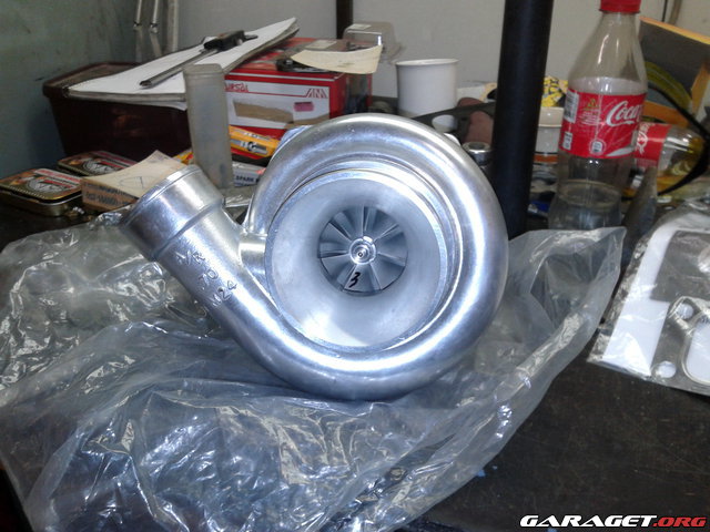

https://www1.garaget.org/gallery/images/123/122684/122684-75a5600d20eda49b15c307d11e73b760.jpg
https://www1.garaget.org/gallery/images/123/122684/122684-d511729957cf5afd14c2ec371eb35842.jpg
https://www1.garaget.org/gallery/images/123/122684/122684-3652ec9253f6a289d0a4396e3d659a22.jpg

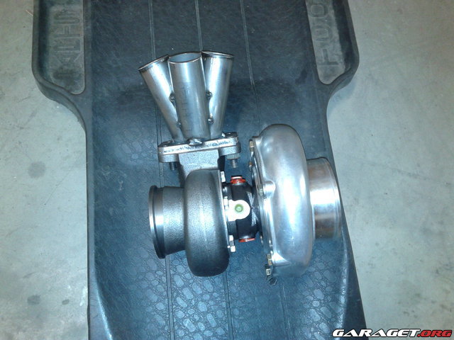

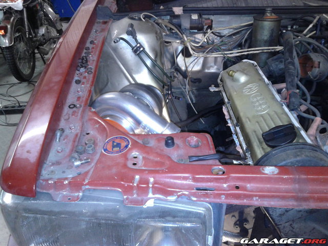

Ny Turbo från GZ Racing : GZ-1835R+
119 Inlägg
11 november 2013

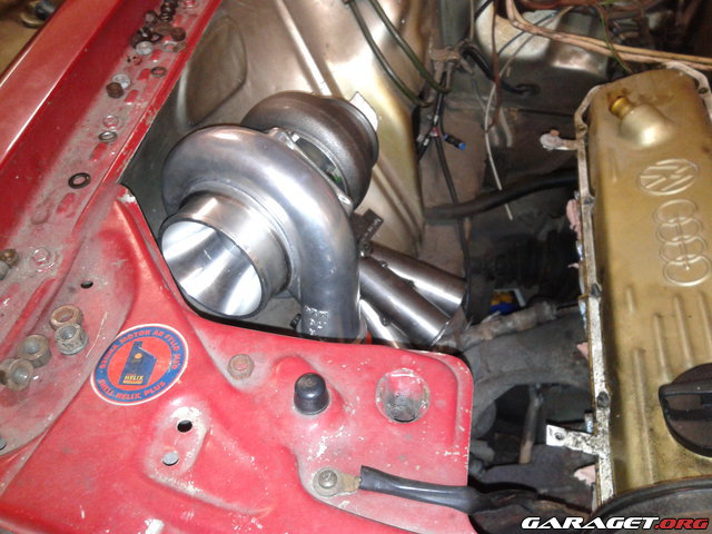

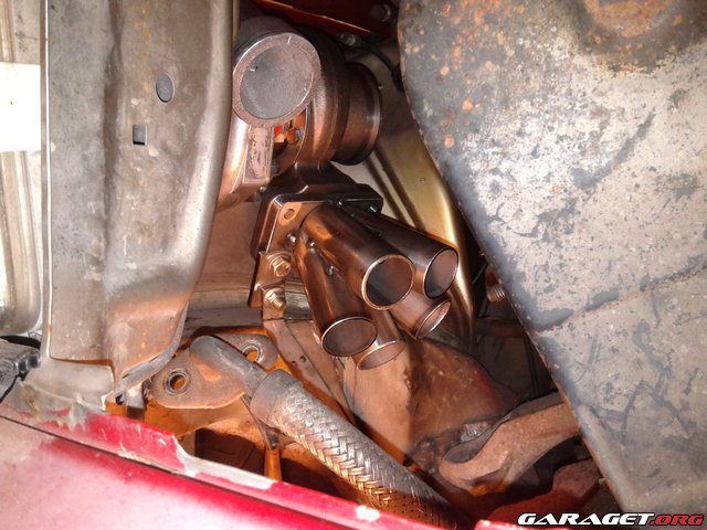

https://www1.garaget.org/gallery/images/123/122684/122684-5152770315c271b60fec258f127e1364.jpg
https://www1.garaget.org/gallery/images/123/122684/122684-63f50dee01e9b4d8229caeef0d1714da.jpg
https://www1.garaget.org/gallery/images/123/122684/122684-bebd2c145537b7666075ba8d4ca8fec4.jpg
https://www1.garaget.org/gallery/images/123/122684/122684-e9177e3340687d6f494300e778960b8a.jpg

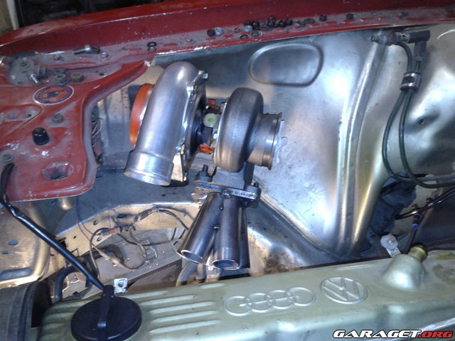

Testar turbo-placering

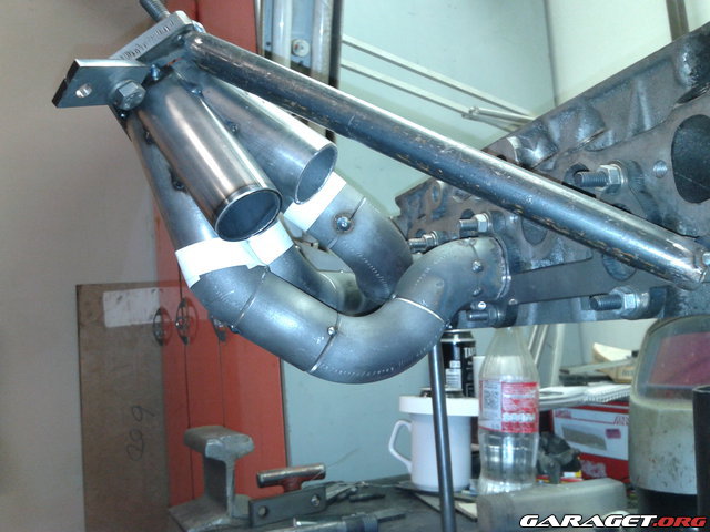

Svetsjigg till grenröret

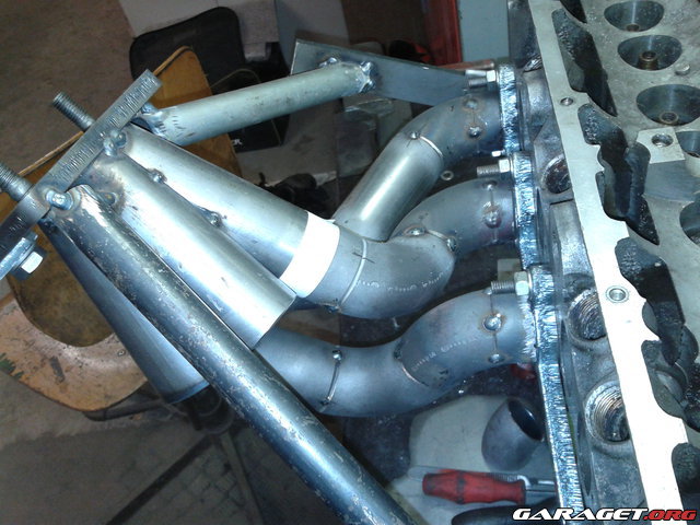

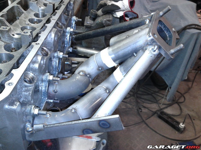

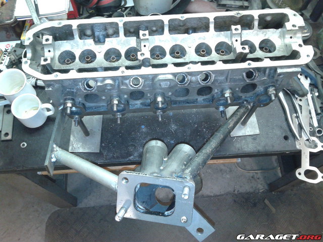

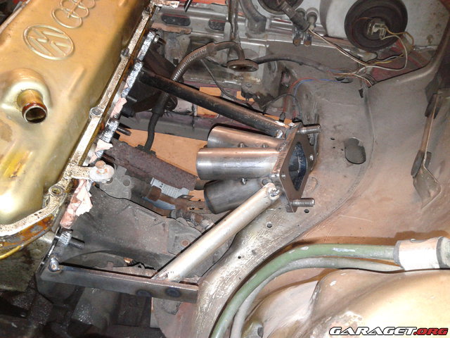

Påbörjat grenröret
https://www1.garaget.org/gallery/images/123/122684/122684-dcc1139a48d07f2af0eb4773bf9e8b16.jpg
https://www1.garaget.org/gallery/images/123/122684/122684-0d5f247a580ccc66284bb4794cf172d4.jpg
119 Inlägg

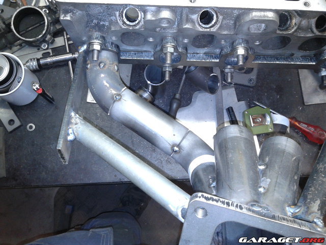

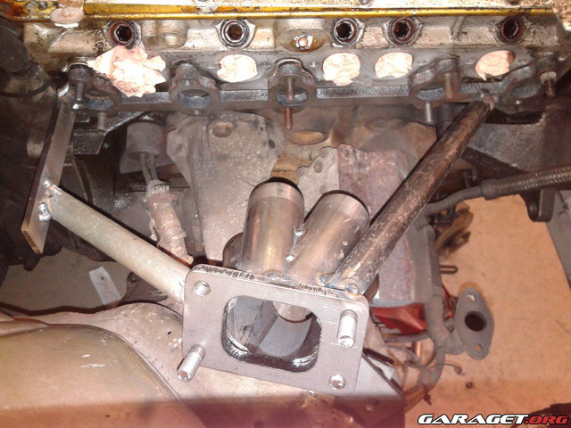

12 november 2013
Första
https://www1.garaget.org/gallery/images/123/122684/122684-cacf9351709f8b0db8016f26c3fbabc4.jpg
Andra
https://www1.garaget.org/gallery/images/123/122684/122684-05e1a306535aa86c932247787619b7fa.jpg
Tredje
https://www1.garaget.org/gallery/images/123/122684/122684-af0e38113af709c616e6daf60595854a.jpg
https://www1.garaget.org/gallery/images/123/122684/122684-7ce47bfd0ad4db9b931bd30825b79053.jpg

12 november 2013
Fyfan. Läckert arbete
119 Inlägg
12 november 2013
Tackar smile De tar tid o passa in rören perfekt mot varandra... men kul när de blir bra big_smile
