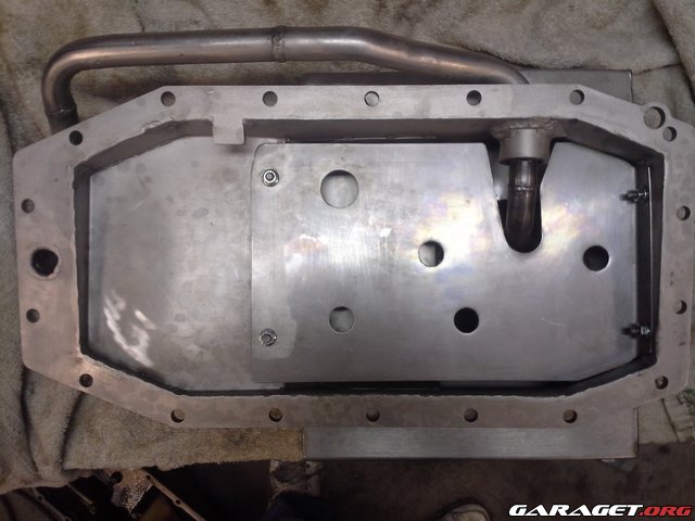

Tråget ombyggt med rörelseskarv mot blocket.
O-ringat precis som org
https://www1.garaget.org/gallery/images/171/170219/170219-71acb6ec4e1de46b71045941f7a3347b.jpg
Nu limmat och klart på motorn

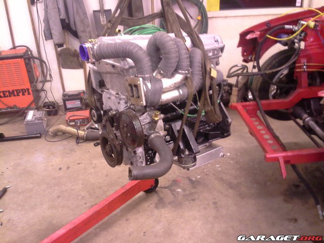

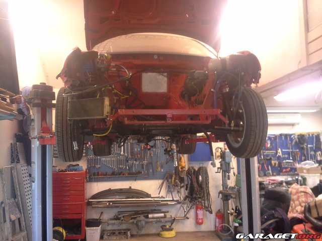

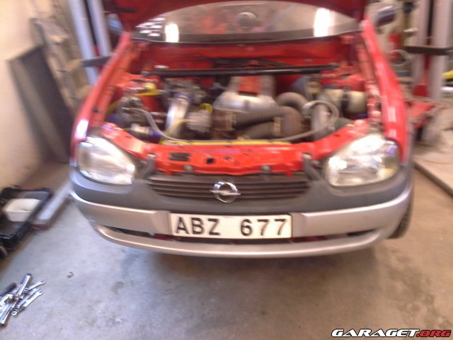

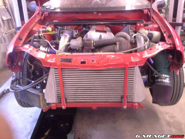

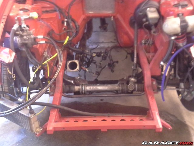

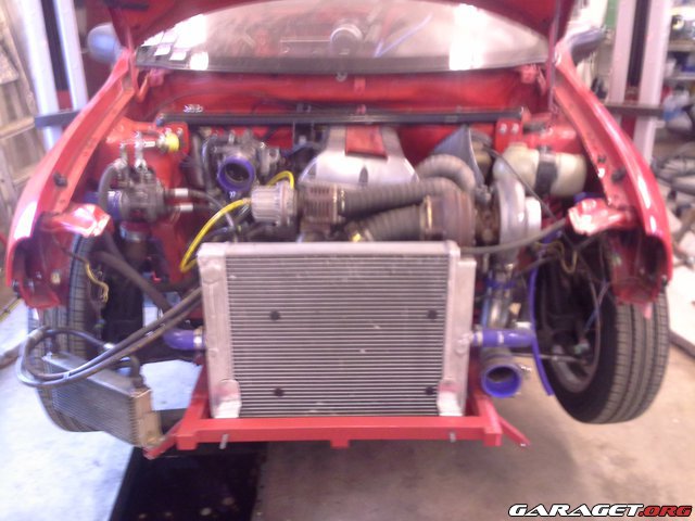

Idag åkte motorn ur
Nu skall bara bränslerören bytas innan nya motorn åker i Corsan
https://www1.garaget.org/gallery/images/171/170219/170219-3d0041c400e0d8bd8a1ea6c2f451a674.jpg
https://www1.garaget.org/gallery/images/171/170219/170219-5c5ac09b2b4450cc5406eeb9ca82e1f6.jpg
https://www1.garaget.org/gallery/images/171/170219/170219-31c64091574be594eadceefe9eced75b.jpg
https://www1.garaget.org/gallery/images/171/170219/170219-75838a10491b649b833fec7867a19bf3.jpg
https://www1.garaget.org/gallery/images/171/170219/170219-41be20268f5fc678155329e3b499e486.jpg
https://www1.garaget.org/gallery/images/171/170219/170219-3b187041027e10c943421caf6ac4b76f.jpg
https://www1.garaget.org/gallery/images/171/170219/170219-57e0bd8187f160d5d30f962ff05672ff.jpg
https://www1.garaget.org/gallery/images/171/170219/170219-d9f5347ab0bc2d8e658891df74461835.jpg
Senast redigerat av MickeKr (13 mars 2016)

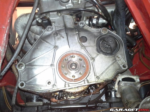

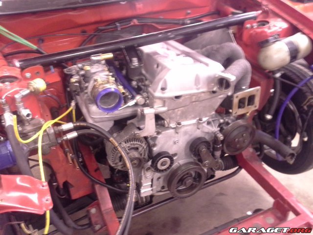

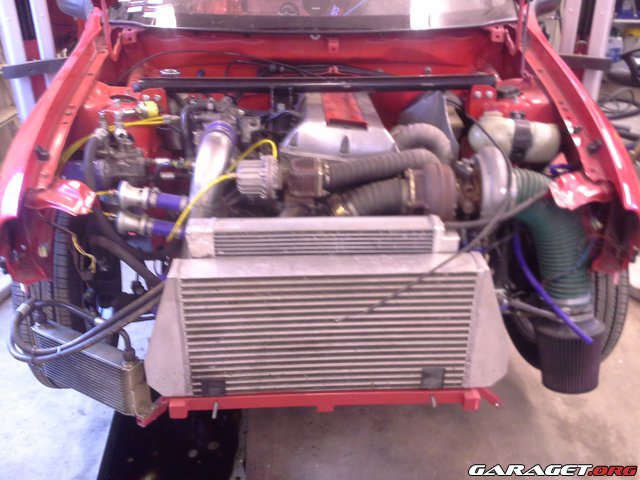

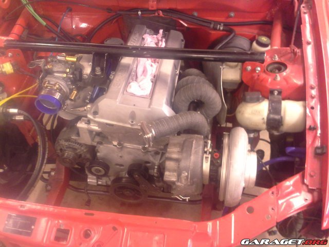

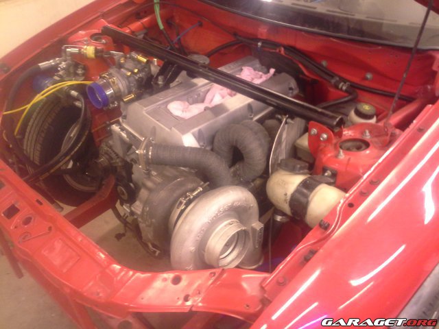

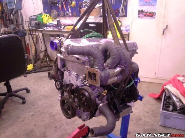

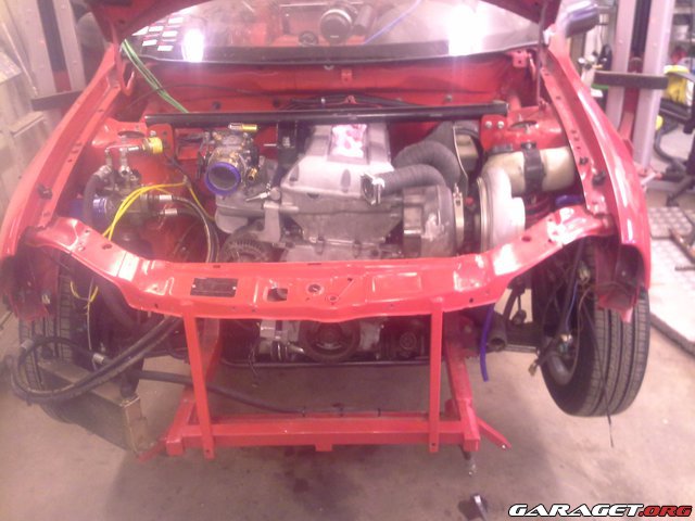

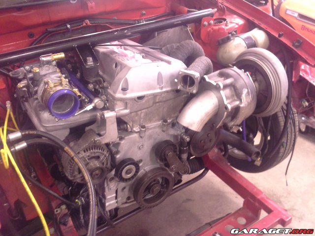

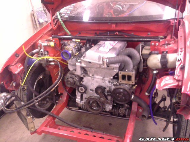

Då var det daxs att montera motorn
https://www1.garaget.org/gallery/images/171/170219/170219-22c3eedb9044f9407c600bda5402231f.jpg
https://www1.garaget.org/gallery/images/171/170219/170219-07a555e0c74e94f4b3b1da78a531c248.jpg
https://www1.garaget.org/gallery/images/171/170219/170219-229e0cf4fe0a244a79c15902e8f5dab8.jpg
https://www1.garaget.org/gallery/images/171/170219/170219-1a119925767386261b8b89f0e7f38a6c.jpg
Så var det daxs för turbon
https://www1.garaget.org/gallery/images/171/170219/170219-af683068bb1e842b2b4a18da25bf46e7.jpg
https://www1.garaget.org/gallery/images/171/170219/170219-232edf15a1fbe5b1d68431487b1094e4.jpg
https://www1.garaget.org/gallery/images/171/170219/170219-cc24aeb35f323be19640e99f55bff3f6.jpg
Dags för downpipe imorgon
https://www1.garaget.org/gallery/images/171/170219/170219-ab0cd91ebefd62e9540c3fdd5a2e90e6.jpg
Skönt steg att delarna börjar ta plats i bilen igen

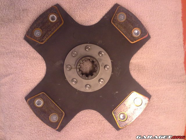

Lamell från Bakaxel.se efter ca 120repor varav ca 80 på klister :-)
7,8mm tjock och inga skador, bara att montera igen, gött
