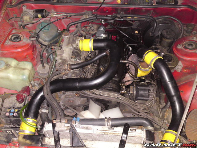

Fick hem lite fler silikonslangar:
http://img138.imageshack.us/img138/9529/1002388x.jpg
Rören klara för lack:
http://img225.imageshack.us/img225/5238/1002390i.jpg
Lackade:
http://img6.imageshack.us/img6/9065/1002393f.jpg
http://img535.imageshack.us/img535/659/1002392p.jpg
Monterat:
http://img829.imageshack.us/img829/9651/1002395p.jpg
http://img842.imageshack.us/img842/3656/1002394.jpg
http://img683.imageshack.us/img683/5863/1002396x.jpg
