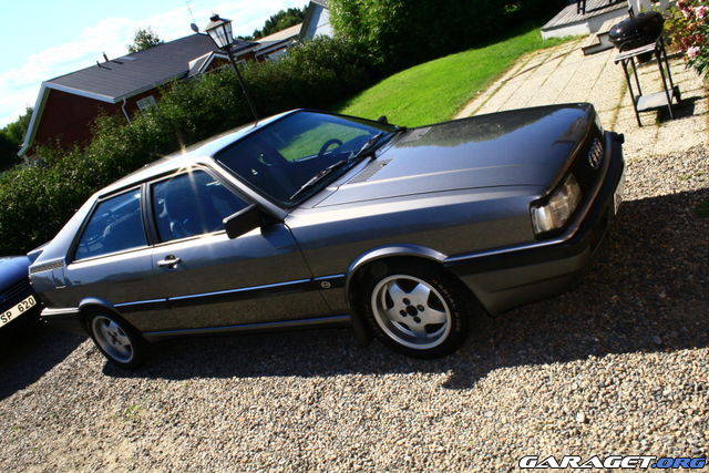

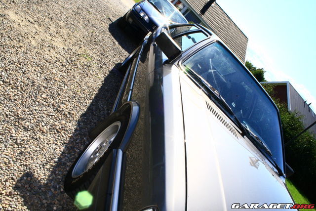

te_wik skrev:
När får man se resten av bilen då? Mvh Tommy
https://www1.garaget.org/archive/63/62667/58075/58075-596973.jpg
https://www1.garaget.org/archive/63/62667/58075/58075-523878.jpg
https://www1.garaget.org/archive/63/62667/58075/58075-1690223.jpg
https://www1.garaget.org/archive/63/62667/58075/58075-1690224.jpg
https://www1.garaget.org/gallery/archive/62667/939186_win99o.jpg
https://www1.garaget.org/gallery/archive/62667/939187_j50vwc.jpg
Satisfied..?  wink
