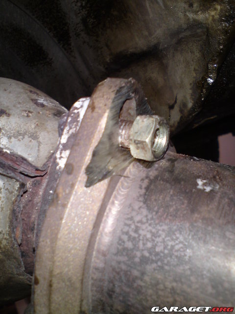

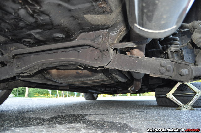

SKunk2 70mm Catback monterad efter lite svets och slip jobb, Video klipp kommer wink
https://www1.garaget.org/gallery/images/143/142200/142200-9f22d027829eaba8d668afb7ba3ef0b5.jpg
https://www1.garaget.org/gallery/images/143/142200/142200-48da17ddf752939672bc2670716cbc6d.jpg
https://www1.garaget.org/gallery/images/143/142200/142200-ad52de3925887296b09fbc149715bbe2.jpg
https://www1.garaget.org/archive/143/142200/305902/305902-3278825.jpg
https://www1.garaget.org/gallery/images/143/142200/142200-668d16f09d5f6631c7441910ce6bc98f.jpg
https://www1.garaget.org/gallery/images/143/142200/142200-8a2b6dd0a289a86da043223e69d1474b_large.jpg

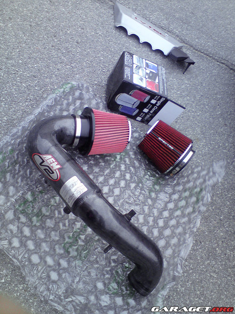

AEM Dualchamber intake monterad, Nytt filter på plats!!  Vtec Screamer wink

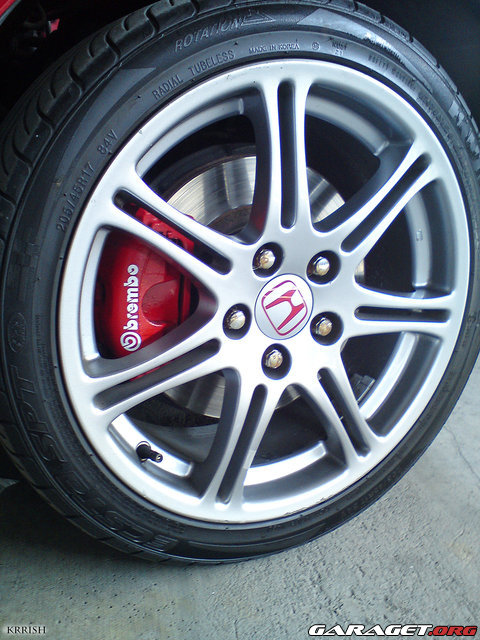

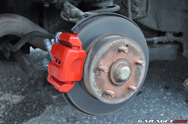

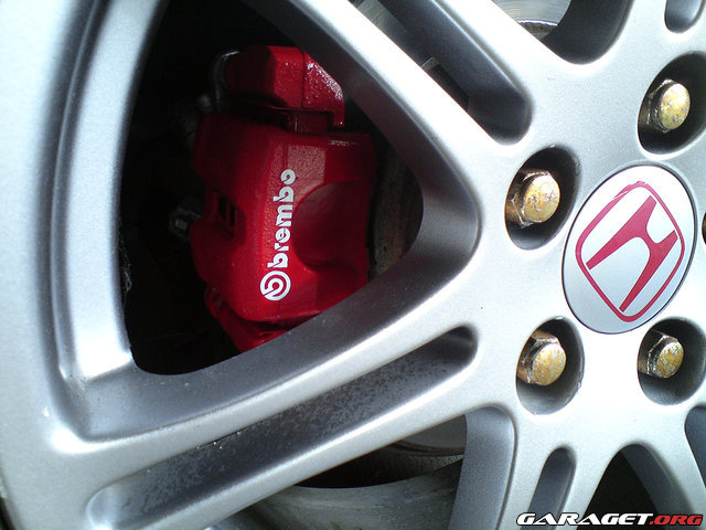

Röd lackede bromsOk [fram/bak] med Vit BREMBO dekal wink
Tips: Rekommenderar biltema/mekonomen motorlack spray till bromsok eftersom motorlack är ngt tjock, tål värme och fäster sig snabbt och enkelt.
https://www1.garaget.org/gallery/images/143/142200/142200-ba84483b6d10dbcab32116e63ce3c09a.jpg
https://www1.garaget.org/gallery/images/143/142200/142200-4eaa91451a32cf2fd30941ce089f8e39.jpg
https://www1.garaget.org/archive/143/142200/305902/305902-3192921.jpg
https://www1.garaget.org/gallery/images/143/142200/142200-b95d70af1237a099a1ad2b67a5dbdc14.jpg

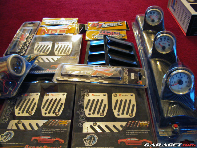

Sparco Shoulder pads,
https://www1.garaget.org/gallery/images/143/142200/142200-8ee98889171df2f8b50508b748554ea8.jpg
Xenon 6000k T10 parkeringsljus,
https://www1.garaget.org/gallery/images/143/142200/142200-dd8e68592fd6d00a788b220df0eaf29a.jpg
Alu Racing Pedaler
https://www1.garaget.org/gallery/images/143/142200/142200-366a10c5121a4de56d2ddd549241ff90.jpg
Stora H-emblem fram/bak
https://www1.garaget.org/gallery/images/143/142200/142200-9a8fb2c5b6e2d63dc225f67572583c67.jpg

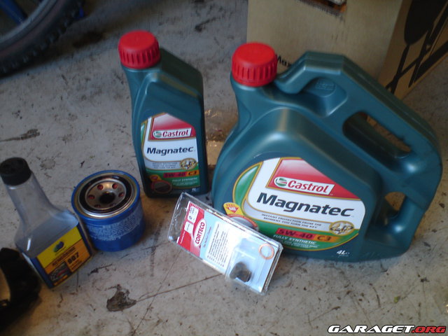

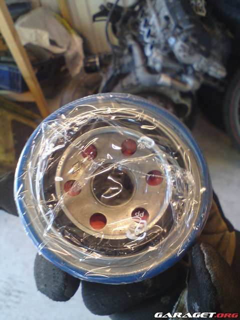

Service Kit 2013
= Castrol Motorolja 5w-40, Honda Type-r EP3 rymmer ca 4,7l
= Nytt Oljeplugg, S2000 oljefilter och MotorCleaner.
Rekommenderar Motorcleaner starkt, (OMEGA Rengöring 407) Produkten säljs på mekonomen 120 kr,
Brukanvisning:
Häll produktern i motorn och varm kör 10min på tomgång stillastående, sedan töm motoroljan som vanligt, Fyll på med ny olja och den kommer vara länge och fräsch. dessutom får bilen bra prestanda & smörj effekt.
https://www1.garaget.org/gallery/images/143/142200/142200-153a6aa7c128bf183b27e489da2210e1.jpg
S2000 filter med större och friare oljeflöde.
https://www1.garaget.org/gallery/images/143/142200/142200-6323c143b2a98313b5b57d6906df4743.jpg

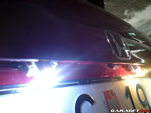

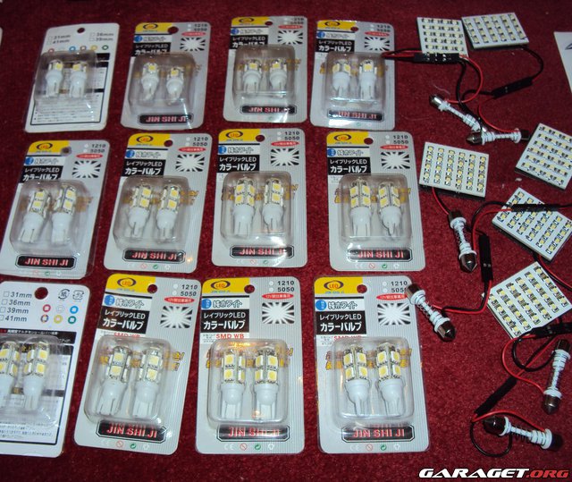

Regskylt Xenon look 6000k belysning lampor, Skillnad mot orginal.
LED 6 smd lampor i regskyltshållare, tongue
https://www1.garaget.org/gallery/images/143/142200/142200-5f0d35e59cc3ee0f28a442e037c2023b.jpg
https://www1.garaget.org/gallery/images/143/142200/142200-d33b7ac2775d83302389a89837dd84d6.jpg

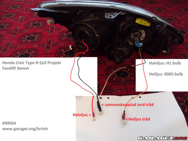

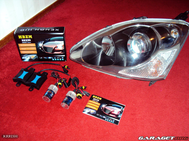

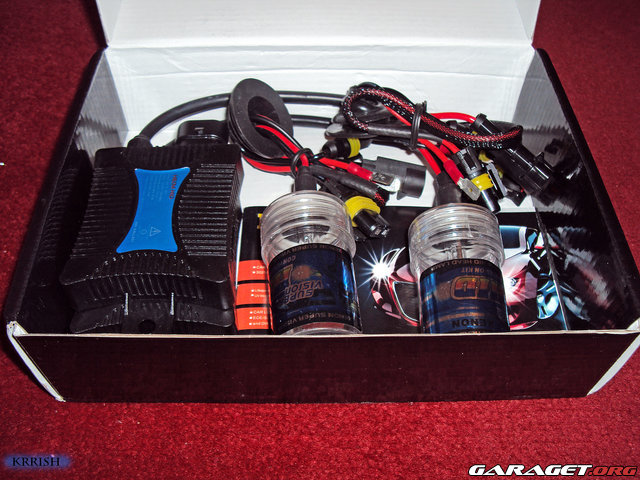

Facelift AngelEyes Lysen smile - Xenon kit 5000K H1 lampor
https://www1.garaget.org/gallery/images/143/142200/142200-c0051ad1f20d0fd5a9f654395de70bed.jpg
https://www1.garaget.org/gallery/images/143/142200/142200-e0ace102a20247563d8fc0f0d501b19d.jpg
https://www1.garaget.org/gallery/images/143/142200/142200-a7309bca0e846fe5b73d3d3665133066.jpg
Montering & installations - Tips och råd
Samman koppla jord tråd mellan helljus och halvljus, sedan dra den till bilens H4 3polig ström kontakt.
Dra sedan ström tråd Röd/brun från helljus och halvljus till bilen H4 3polig ström kontakt, KLART!
OBS! Notera min special adapter till blinkers, smile Sitter monterad till vänster på lysen.
https://www1.garaget.org/gallery/images/143/142200/142200-c7260ee2b57f9c7b943ab5aec9edd51d.jpg
https://www1.garaget.org/gallery/images/143/142200/142200-ce9198f946ba3585a5b5e5351e1991d7.jpg
Honda Civic Type-R Ep3 - Xenon Kit H1 holder Adapter
Man måste ha denna adapter för att eftermarknad Xenon H1 lampan ska sitta fast under klämman!!
https://www1.garaget.org/gallery/images/143/142200/142200-c3c7594173ff9a035d707f691dd2e5c8.jpg
