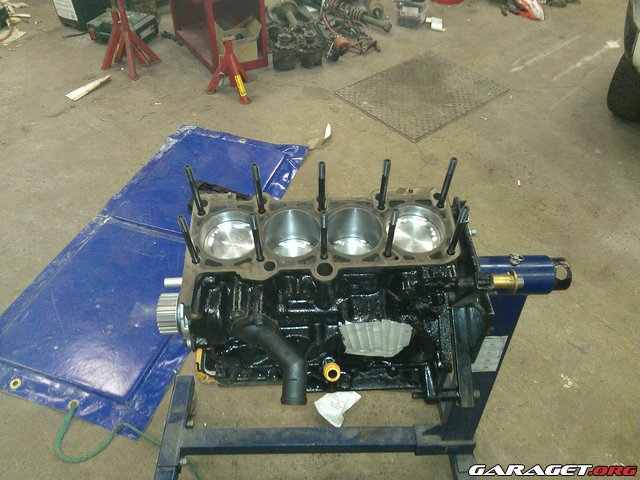

fått ihop blocket
https://www1.garaget.org/gallery/images/2/1935/1935-8ebd31f6e8e4344b752946ff79fd82c6_large.jpg
